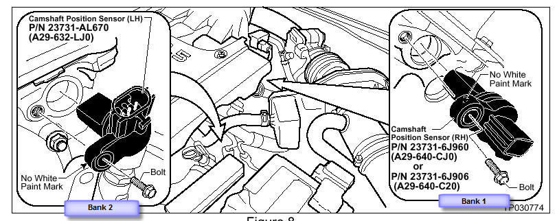

Here's the locations of the two Cam Position Sensors (CPS)
