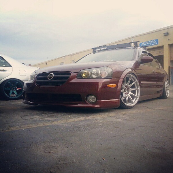

I have the xxr as well, 19x10 rear with a 3" drop, on megan coilovers.

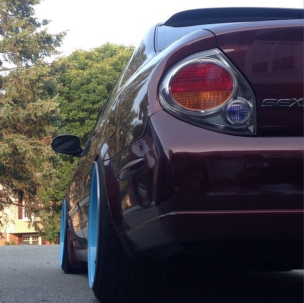

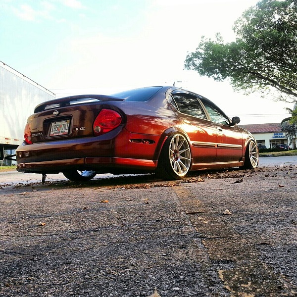

Like everyone said you will want to stretch them tires and you will most definitely need to roll the fenders. I like both rims it just needs to be pulled off in the right way! I imagine you will have rubbing in the rear. With my current setup 18x8 with 20mm spacers I have burned up tires by being to low lol. The front you can adjust camber a little to avoid rubbing. Craziest I have seen on a maxima is 18x11 on a 5th gen but he had his fenders pulled and rolled like crazy.
This dude is running 19x10

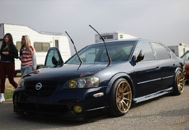

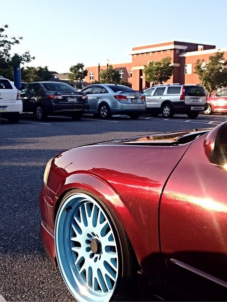

Then there is the 18x9.75 527's
