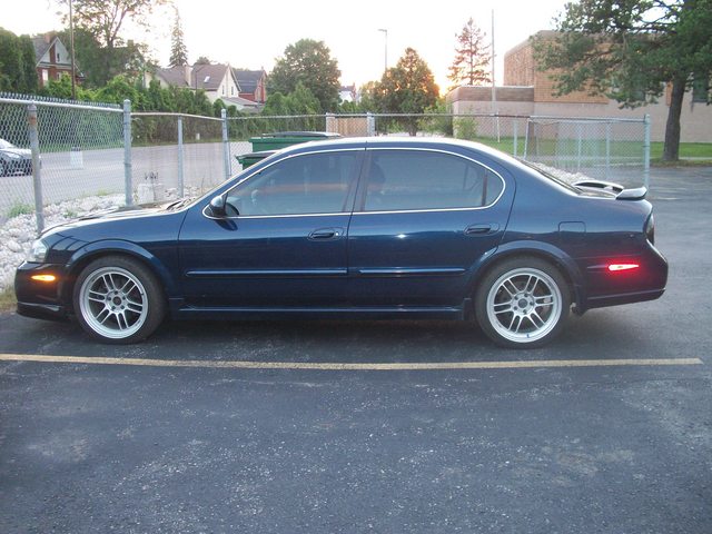

This is h-tech + 18" rims (looks horrid no?)

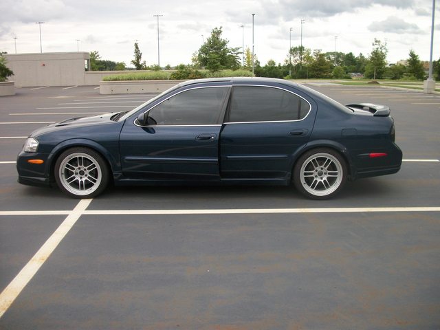

This is coilovers (not set to lowest) + 18" rims (much better)
This site can help you

^^your whip looks propa' George (if thats yours)

The coil overs do look a lot better does it still ride as smooth with them
