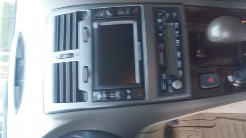

want to replace my 02 gle factory navigation and bose audio system,my ac/heat controls are on the navi screen so it has me kind of stuck on what to replace and the only thing currently working is the cassette player...need help please

Isn't the automatic climate control BELOW the bose head unit?

george_ he has the factory Navigation which controls the ac and heat controls within. Underneath it would be the bose cd player and the audio controls for it if im not mistaken. Replacing that may be a pita. Good Luck!

If the only thing working is the cassette player? im not sure if a cd changer was an option? Lets start with whats not working. Replacing this may be a challenge...(if you are willing to keep an "in glove box" stereo thats an option to consider.

What about ripping all that out then installing aftermarket din and OEM automatic climate control?

george this is my unit looks and i do have cd changer in trunk which is also not working

It is not recommended to try to replace the factory Nav unit. HVAC is entirely too integrated. Wire harnesses are completely different. I have yet to see a single person who has successfully done it and gotten every function of HVAC properly working.
