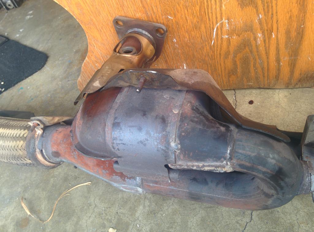

Just wondering. When people gut the pre cats how do they get to this one?

is that picture what a y-pipe would replace? and not the precat (02-03 5.5 gen) anyway

It's the rear on a Californian 00
Get a Ypipe, since the cat is built into it on the cali-spec 5th gens. Ypipe removes that cat.
Then gut the front one. I dont know how else you would gut the rear since its inside the ypipe.
That's the one that goes to the scrap yard.
