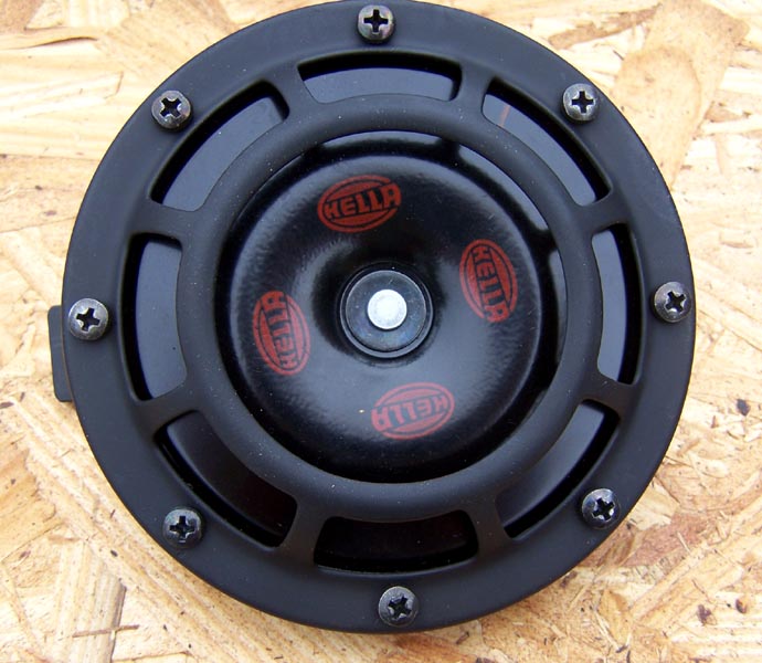

I have Hella horns on my 2000. Had them on my 94 and 97. People hear me when I blast them.
You don't need the relay, it is included for custom work. You need to ground one of the connections on the horn. I made 2 y-splitter wires for the horns. One for the ground connection that I bolted to the chassis and the other to hook up to the nissan horn wire. I have both horns behind the grille, bolted on the hood catch brace. Scraped the hell out of my knuckles doing it.
I also took the red covers off of the horns and painted them black so they are not so obvious behind the grill.
