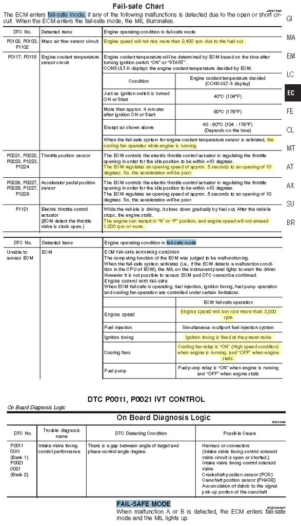

As best I can figure out from reading the FSM, having a 2400 rpm limit is a MAF problem.

Thanks for that chart dennis I do notice the cooling fans running a lot. and it Wil pull to 3k until after 4th gear/automatic by the way.
