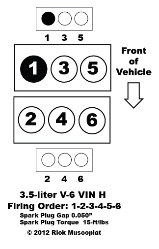

Yeah...looks like a pain in the **** job (but, i've never gotten back there).
How did you change the plug without moving the throttle cable?

The 3.5 needs the cover and the mannifold plenium to come off to do the back three.
