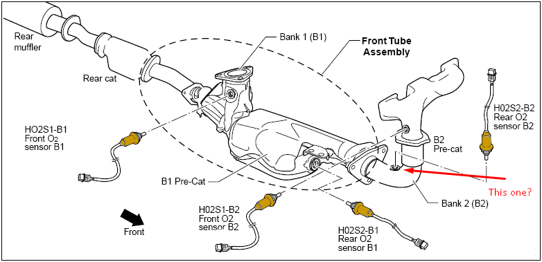

Hi all. 2002 Maxima and my check engine light is on. Advanced Auto pulled my codes and I have 3 codes...
P0159 - O2 sensor bank 2 sensor 2 slow response
P1167 - Didn't give description but seems similar to bad O2 sensor
P1800 - Valve solenoid of some sort.
First off the O2 sensor... I pulled a chart of the maxima sensors but I have no idea which one it is. I marked the one I 'think' it is.
Am I correct that the part number should be 22690NA?

Yes, your arrow identifies the correct sensor (Bank 2, sensor 2, aka "rear"). Re. P1800, do a search on "P1800" and read the interesting threads. There are quite a few posts on this problem; you need to read them to diagnose your problem properly.

Bank 2 Sensor 2 would be the "downstream front" oxygen sensor. The stock sensors are Bosch and the downstream fronts have a part number of 15224 according to Pep Boys.
Pep Boys - Bosch 15224 $100
Amazon - Bosch 15224 Amazon - Bosch 15224
$49.08
There may be slightly cheaper universal fitment types but I'd go with OE for a few dollars (literally) more any day.
I am currently waiting for a downstream rear oxygen sensor (15225) from Bosch an Amazon if you want to wait until tomorrow for me to be a guinea pig. They are the same sensor but with different wire lengths if I'm not mistaken.

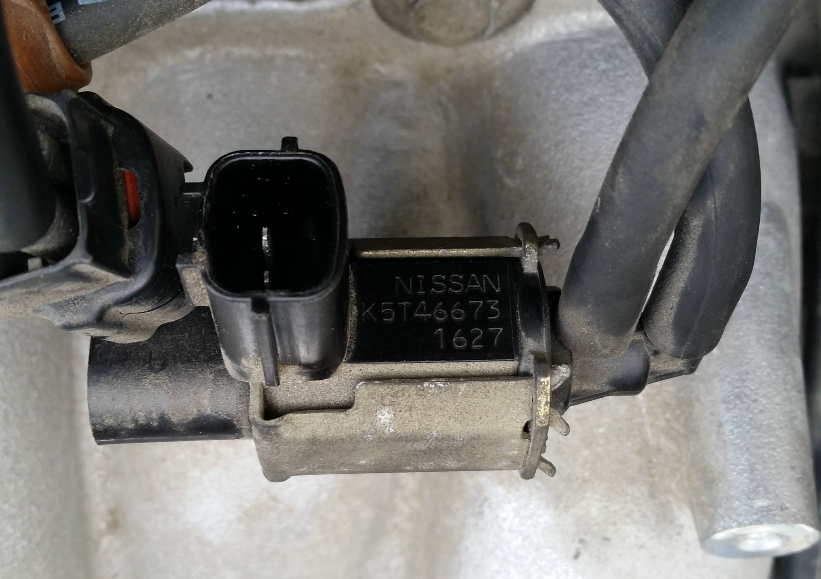

Usually the solenoid has gone bad. It is easy enough to check out. Start by doing an ohm check on the solenoid. IIRC, it is in the 15 to 20 ohm range. You can also jumper 12 volts to it and see if it works.

Is this the correct part? On Nissan's parts website it's listed as 2004 to 2006 so not sure.

Well I tested the VIAS solenoid and it read about 36-37 ohms. I'm assuming that's a good sign that it's bad? I did get a good picture of it for research though... $70 used! ouch. No aftermarket options on this part? only OEM?

The part number you got on nissanusa.com is the correct one. Small parts like that get used on so many different models and years. But I hope you haven't ordered it from them because it is $50 cheaper here:
http://www.nissanpartsdeal.com/parts...955-8j10a.html
As to the resistance, 37 ohms sounds OK to me, but I really don't know what it should be.
