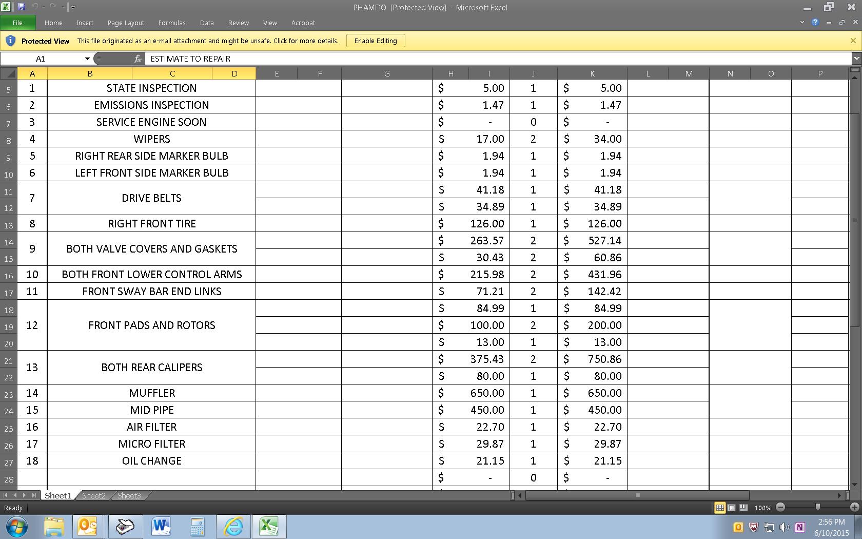

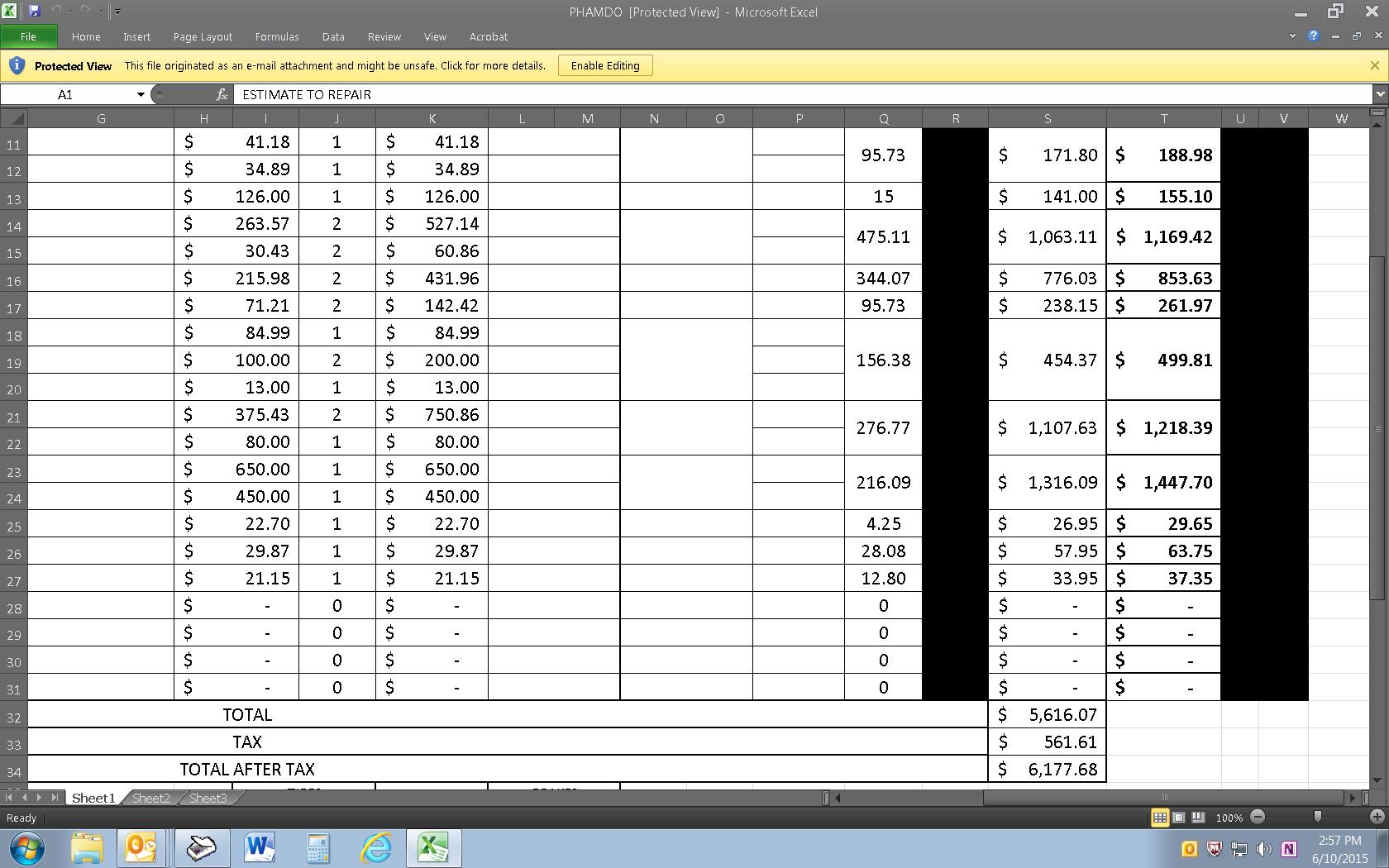

Heres my 01 Anniversary edition that i may be seilling or parting due to exorbitant cost i got qouted for from dealership after i took it in for a airbag recalll.. Needs valve covers/gaskets, new drive belts ,end links for sway bar and control arms, mid pipe / muffler to and calipers for rear....I got it in 2004...was a hot azz car back then and still like its lines....There a site i can find these parts cheaper...should these fixes cost almost as 2 2001 maximas...

Start reading, you can do all of this for under 500$ if you do it yourself. Absolutely none of that stuff is difficult to do if you browse these forums and read up on some tutorials.
A shop would probably charge ~1500$ for that work. Whatever you decide, do not go anywhere near that dealership unless its to go tell them to f themselves. 7000 is bordering the realm of being outright fraud.
That is a lot of money, well for the exhaust work, yes the parts are expensive from the Dealer, one consideration is what state you live in, such as NY and CA are very difficult to get the exhaust from part store since they have to be compliant with the C.A.R.B or the New York State laws. Other states, you should be able to get exhaust parts from Autozone....etc... for a fractional of the cost. Like Slamrod said it, it's a lot cheaper doing it yourself since you would be doing the labor yourself instead of having someone doing it which does rack up the hourly charges. Good luck on what you need to do. Hopefully you get it figured all out.
75% of the members on here could do that for 500$ or less, and if you take some time reading, you could too. It's really not that hard. A simple 50$ hand tool/socket set could do the trick.

Keep in mind some of those issues they quoted may not even need anything done. The dealer has a habit of quoting you for all these repairs and preventative maintenance that is "needed", but it really isn't.
For example, the suspension parts can be tested to see if there is play. You may need to do the end links, and maybe the LCA's, but I would check them first to excessive play. If you have bad LCA's you will know it...your maxima would be difficult to keep on a straight path, especially in bumpy roads at elevated speeds.
Bad end links you will feel in the steering and may get some "sounds".
The exhaust parts, mid-pipe and muffler, only do it if you really need it such as massive holes.
Valve cover gaskets, drive belts, and rear caliper work is easy. You probably don't need new rear calipers, but just change the pads and hardware and flush your brake fluid. For these last things you only need about $150.

All of that was less than a thousand. Probably couldn't have had it done for less than 5,000. Yes, it takes time and it sucks. But it's way cheaper.
