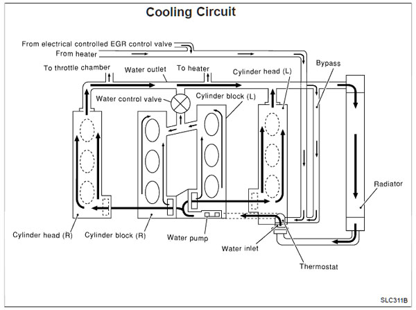

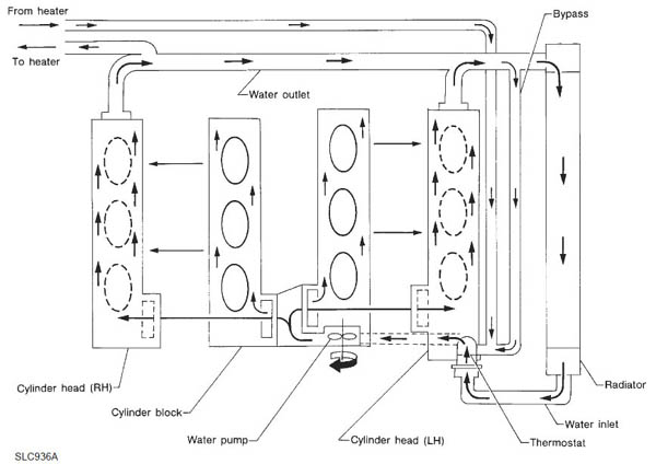

Nissan did an experiment on the 2000 & 2001 engines. They added a "Water Control Valve" on the engine. It is like a 2nd thermostat connecting the 2 banks of the engine just below the cylinder heads. It is on the opposite end of the engine from the regular thermostat.
There isn't a lot of info on this but it can play havoc with the cooling. There have been several threads of people having problems with this.
3.0 engine with Water Control Valve

3.0 engine without Water Control Valve
That's why it was gutted originally. It's one less failure point. It's there to heat up the block faster and keep it hot. Worthless. My QR25 has it and I gutted it as well (and used a 170F t-stat).
The ideal solution is to use another 180F for the water control valve, but that's not important right now.
When you say gutted, do you mean that that water control passage is now wide open? If so, maybe you should block it, and somehow block the passage between the 2 cylinder banks too. From the FSM diagrams, it looks like that valve is there to try to push more of the hot coolant from the cyl head down into the block, decreasing warm up times, like you said. With it completely blocked, more coolant flows around the top cylinder head and less flow in the block, they way it always is normally on the older VQ30DE.
Also you can see from the diagram, and probably already know, the excess extra hot cylinder head coolant is going to the heater core and throttle body. So a way to test this theory is to see how hot the heater core is getting. If it's not getting too hot, then that shows that not enough coolant is circulating up top, so to speak.
Yes, it would be like wide open all the time.
The heads/block are just paths to the return pipe, though. None of that is going to affect return flow through the radiator.
