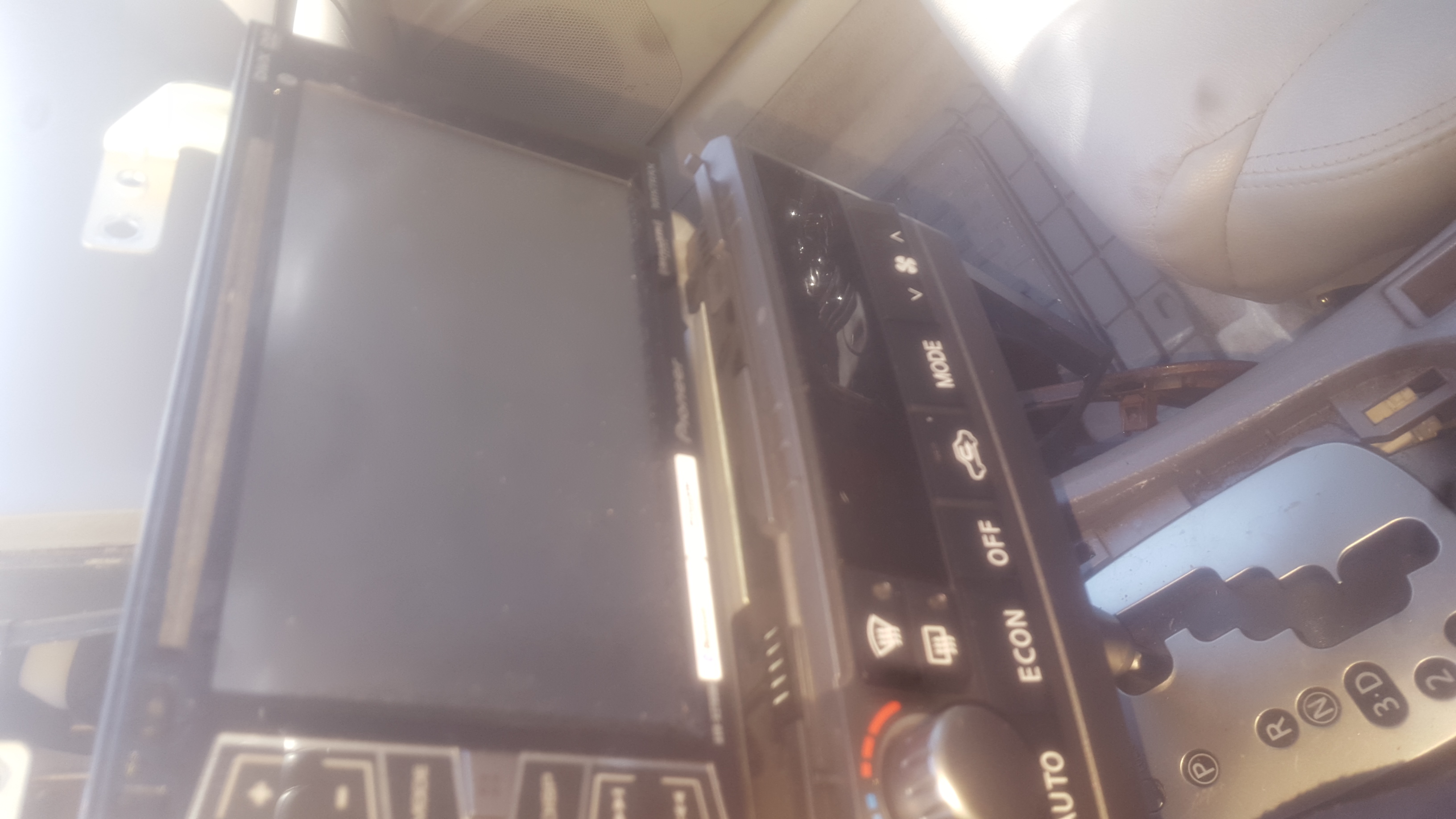

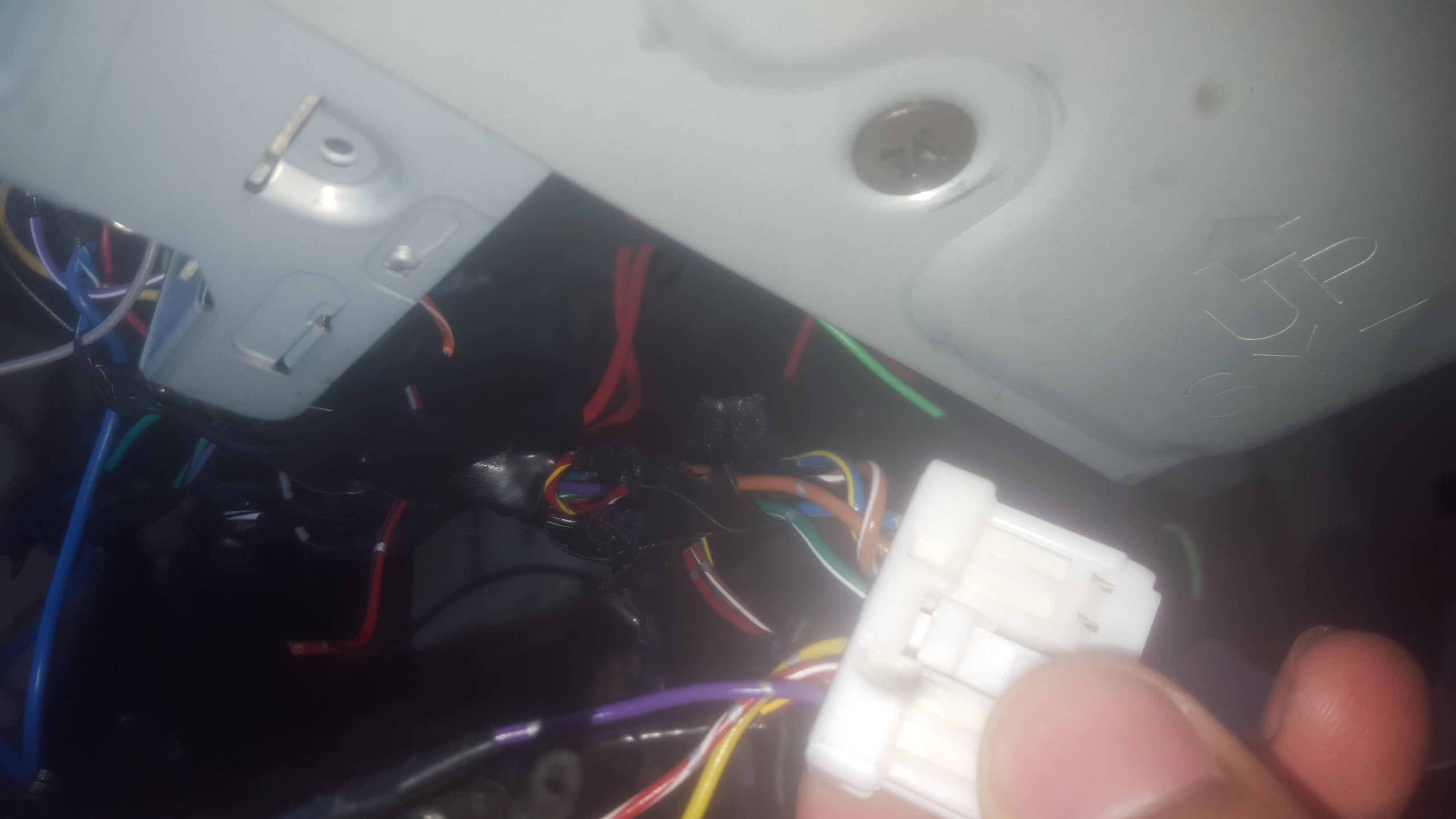

AHey guys im having some trouble installing my steering wheel adapter on my pioneer 2700 avh bs radio i printed out the radio harness thing for my car only thing is my radio harness is from a 01 maxima because my installer had to do some customization to make the radio work with the bose speakers anyways ill send some pictures of the harness it looks like some of the wires i need for the install are not there

Did you let someone hack your wiring harness
They make an adapter for the bose system so you wouldn't have to cut anything.

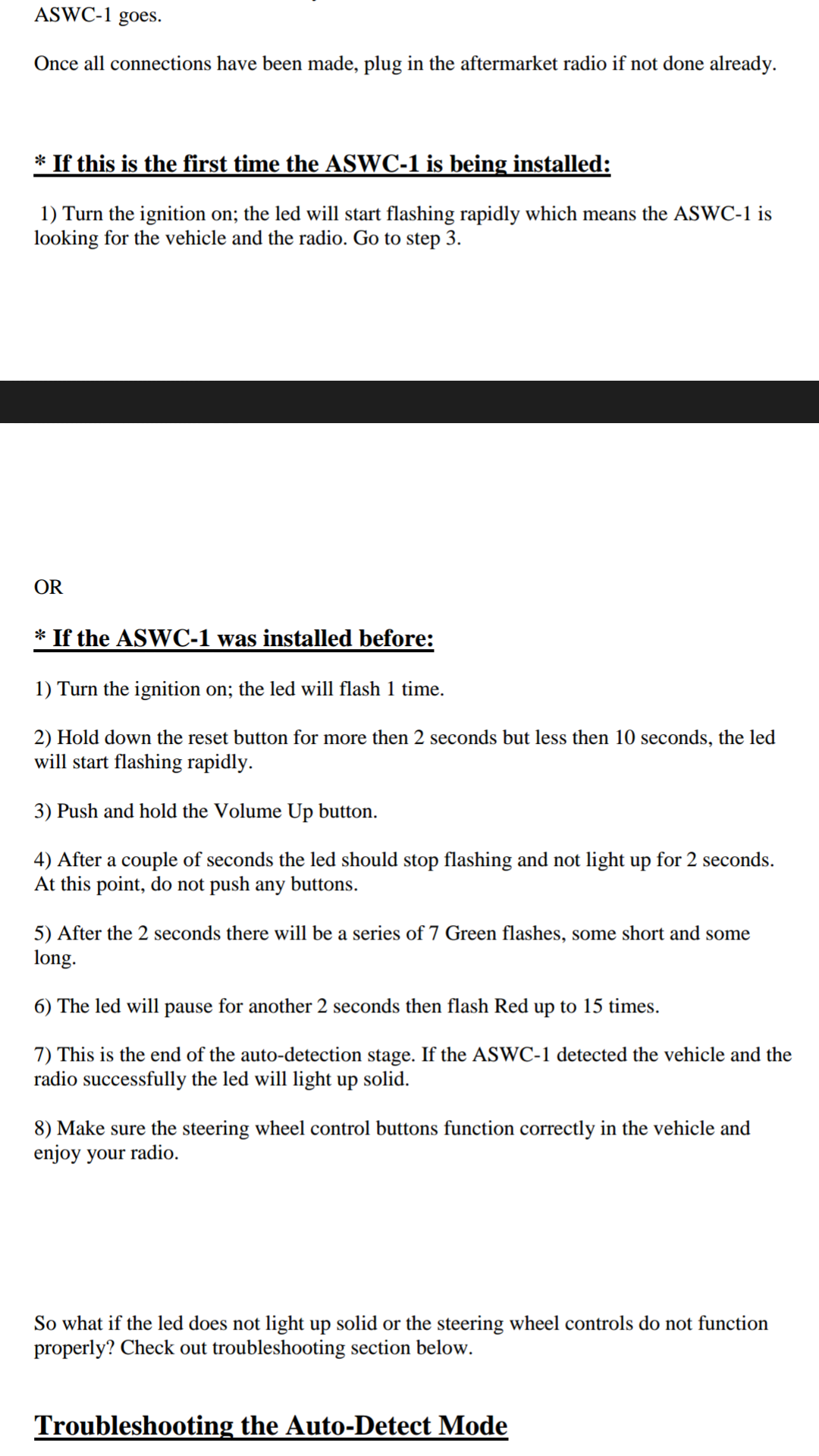

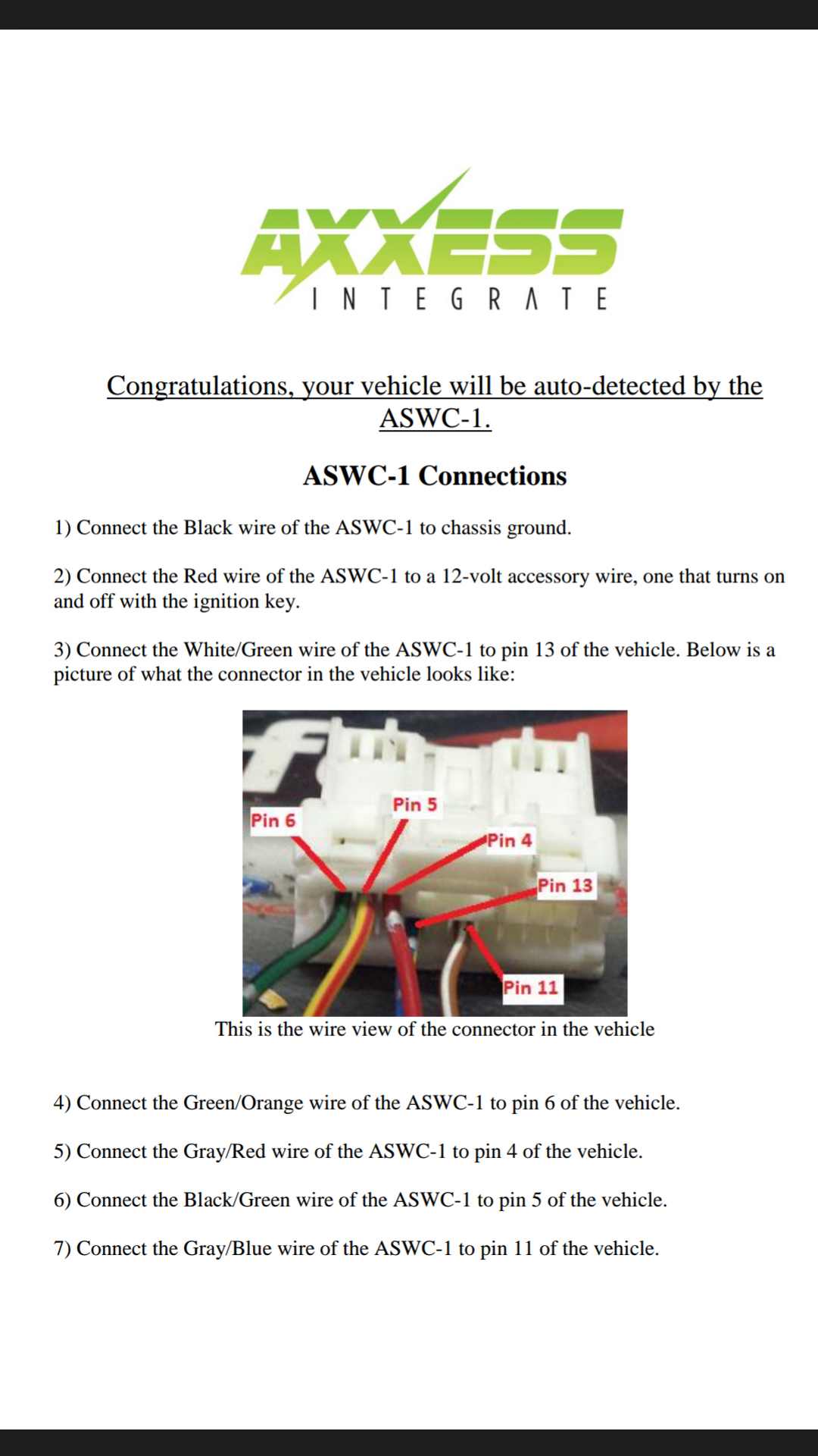

I just put this same radio and steering wheel adapter in my 03. It was a very straight forward install.
It looks and sounds good
Hope these pics help

Yea i did lol the harness i have now is from an 01 radio as you can see in the second picture some of the wires are missing should i buy anothetr harness
