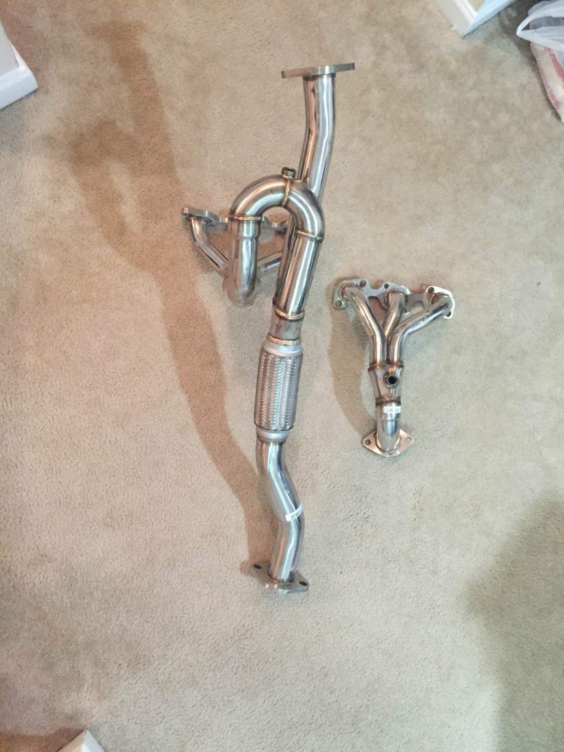

So I bought some 02-03 OBX Headers in a rush because I got them at a relatively good price(In my opinion), I have a 2000 GXE manual. Now after doing a little search I still have not come to a definite answer, so can 02-03 OBX headers "fit" with 02 sensor bung hole changes or should I sell them and just get 00' headers?(I'll and see if I have an EGR in the morning before I go to NAPA, I heard a particular build date don't have any)
Edit...I thought I posted a picture but I didn't, these are the ones I'm referring to

Yeah, they'll work.
If you have EGR and need emissions inspection, you can just swap out your ecu for a 2001.

I got a good deal on them but I was gonna buy some from Ebay anyway
If the picture is too big, somebody let me know and how to decrease the size

Man op's OBX headers look WAAAAYYY nicer and bigger than my 00' OBX headers. hell mine are only 2" NOT 2.5" at the collector.

The guy I bought them from said he bought them for his 02 Maxima but never used because he got married and got busy and plus the price was right so I took a chance, haven't fitted them yet though

i bet they are the older better quality version or something along those lines.
