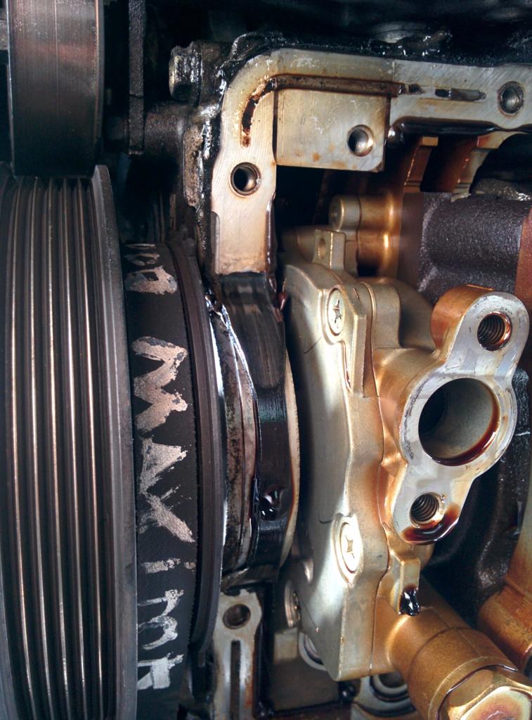

You don't have to make up a story to find out how to take an oil pan off.
That 15 year nissan vet is crazy, if he's real.
Notice how what he's saying makes no sense from the the pics.
Don't you have to take the pan off FIRST to actually get the chain cover off??
Those wings of the back you stick screw drivers in and just wiggle the pan off.
ez business. You can do it.

Thanks for the picture! You know I'm seeing a razor blade there too in the photo. I would assume it was used to scrape.
When I clean up a pan like that you know I like to shave down one end of a regular tooth brush and use it as a scraper. I'll apply Goo Gone http://googone.com/Home on the other side and use the bristles to scrub. Always works great.
Thanks for those pics. I found quite a few myself. Many angles, various states of disassembly. I see nothing particularly tricky here.
