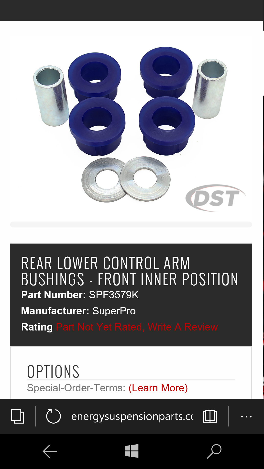

Why is there an influx of posts about rear arms when the maxi lost them in '95?
But, yes, check the front arm bushings as well as tie rods. You'll have to take the outer off the knuckle to check the inner. Definitely check the ball joints unless you the knuckle to fall off.
Blame false advertisement on energy suspensions part, they sell a bushing for our "rear control arms".
