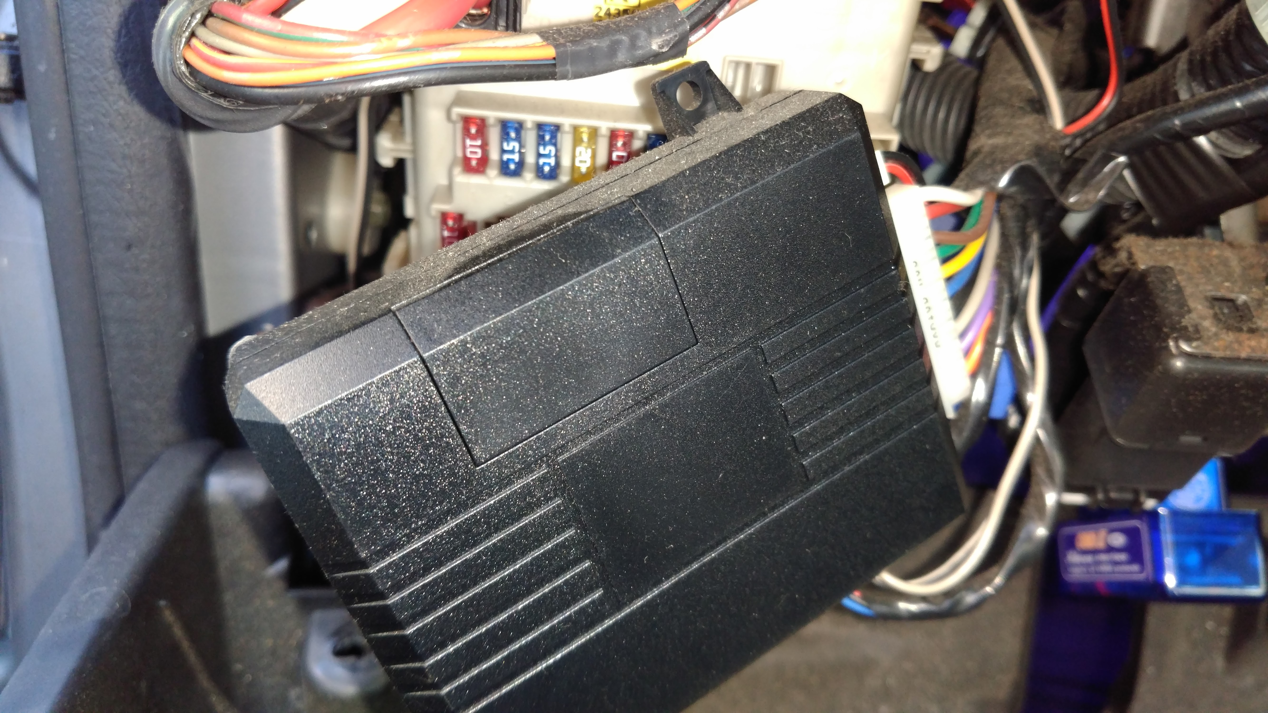

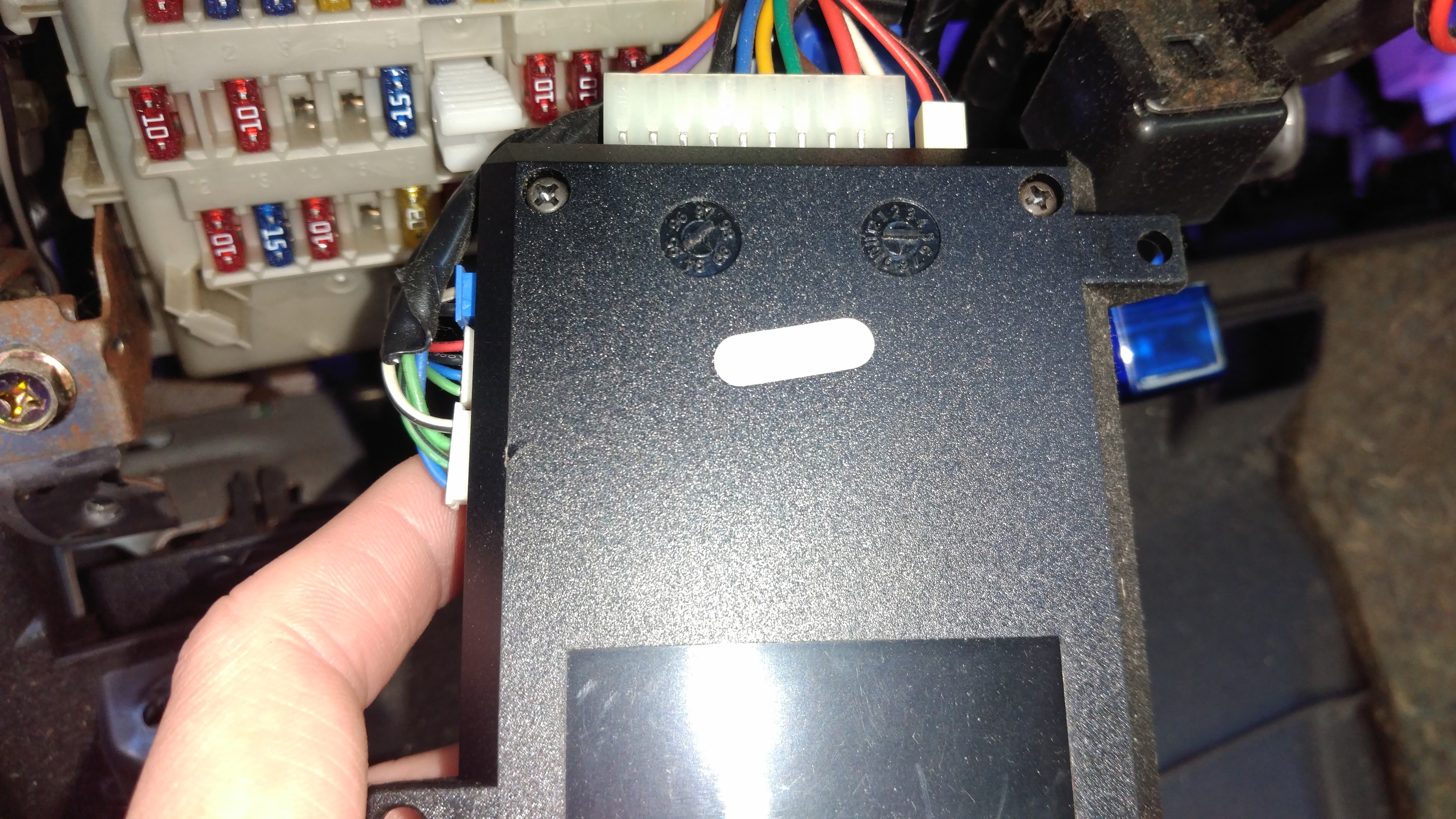

Update!
Ok, I have removed the dash panel and found a black box... seems like it's an unbranded aftermarket alarm system. I disconnected all the harness and the alarm went back to stock.
Thanks for the help!
