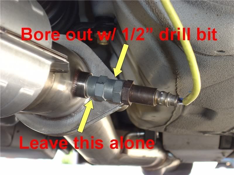

for the spacers, you have 2 options. You can buy two Non-Foul plug spacers at an auto parts store and piggyback then and drill out the inner one, or go the lazy route that I went and buy the spacers on ebay. I think they are about $20 now for both (one for each downpipe o2 sensor).

You only need to extend the o2 sensors that are after the precats to pull them further away from the exhaust stream to lessen the sensing/reading.

Cool. Just ordered two. I'll have the exhaust put on after I get the extenders next week. That's a big help. Thanks so much.

I saw the O2spacers at conceptzperformance.
​​​​​They have these for the 350Z.
Old Apr 19, 2017 | 09:43 PM
Child_uv_KoRn's Avatar
Bad *** Newb
Posts: 4,975
You can get em predrilled on ebay for cheap, then buy an unmolested pair.
Old Apr 20, 2017 | 04:01 AM
Cephyr13's Avatar
Joined: Aug 2014
Posts: 265
What can you get predrilled on eBay and what can you buy an unmolested pair of?
