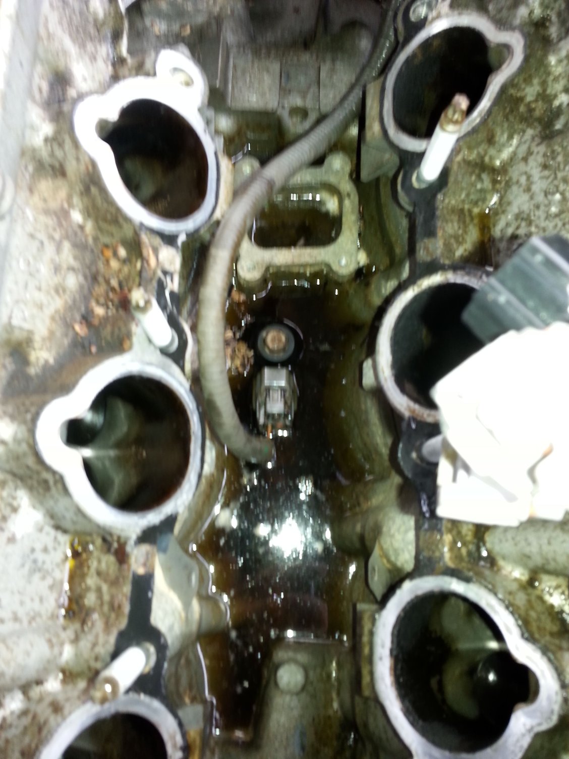

Hello all. Acquired a free 03 Nissan Maxima for a new driver. Was sitting for almost 3 years outside in dirt, given up on. The story behind it is it had a used engine transplant 40k ago, only needs alternator and muffler.
I started it, ran for a few minutes to verify the alternator was not charging. Seemed ok at first but then things quickly went downhill. The service engine soon light came on and the engine became sluggish. It was low on oil (3qts) and coolant so I topped both off. Still sluggish. When it was delivered running I assumed there was enough fluids in it so i didn't check right away. but I only ran it for maybe 5 mins that low. No rapping or knocking, just what would appear to be a misfire. I used the Nissan gas pedal trick to set the SES light into diag mode. P0304, P0462.
I figure if this car was running that low on oil for any period of time it may be spent, so I'm not inclined to throw big money at it. First thing I did was test the P0304 by swaping the #4 plug and coil to #2. Disconnected battery for a while, restarted. Same code, P0304. Next is swap the injector to #2, opening up for plenum and intake gasket replacements. Hopefully just a gasket leak

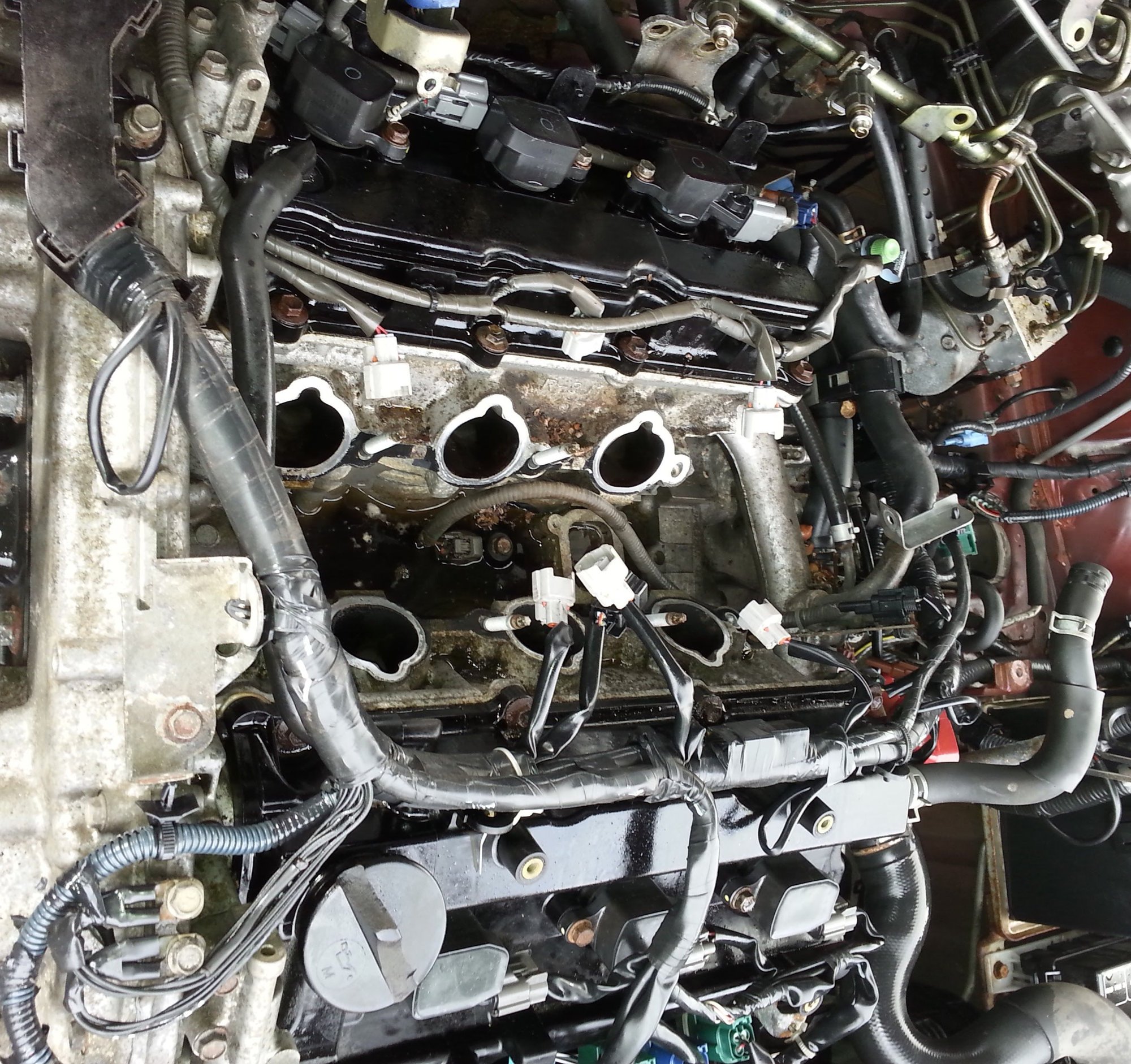

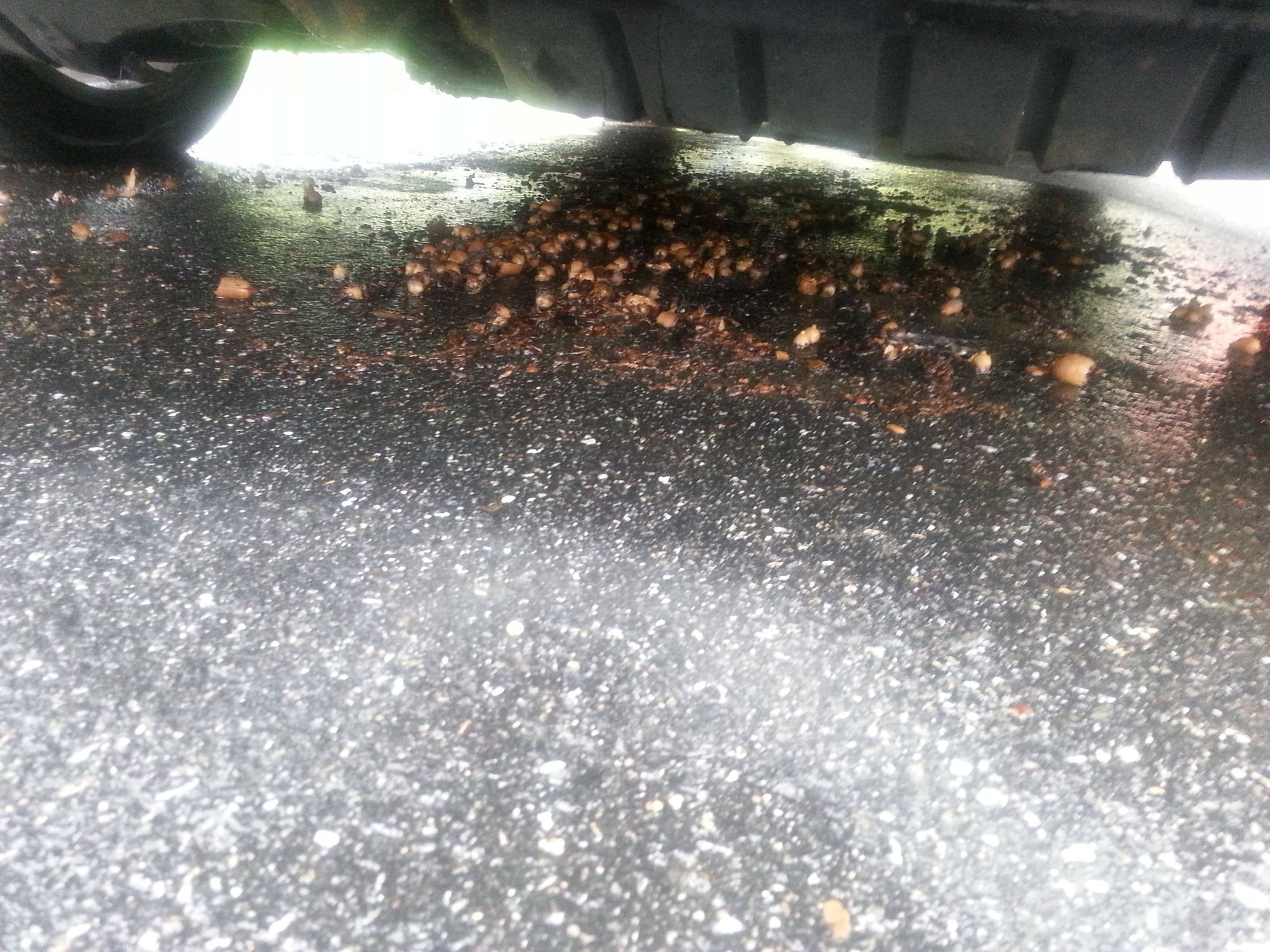

I had to spray the engine down before opening because it was infested with acorns, mouse nests from being outside.

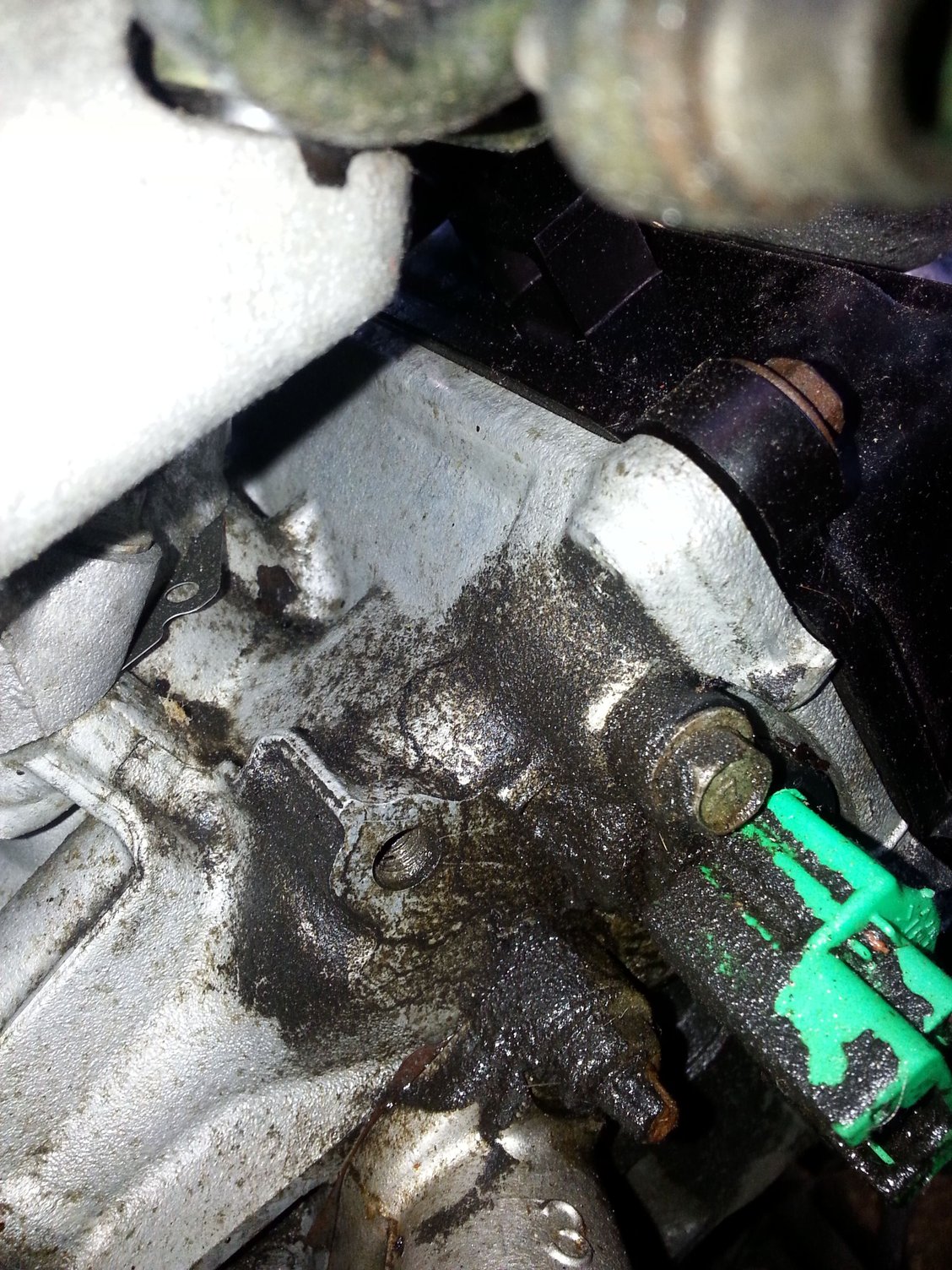

#4 spark plug was oily, but there was no oil in the tubes. No valve cover gasket leaks. Below are pics of #4 cyl, looking for opinions of the status of the gaskets. If its possible they were leaking..
Sorry about the clarity. The water engulfing the knock sensor was me. I had to, the poop, acorns, nesting materials were so bad I was afraid to remove. Its clean and dry now.

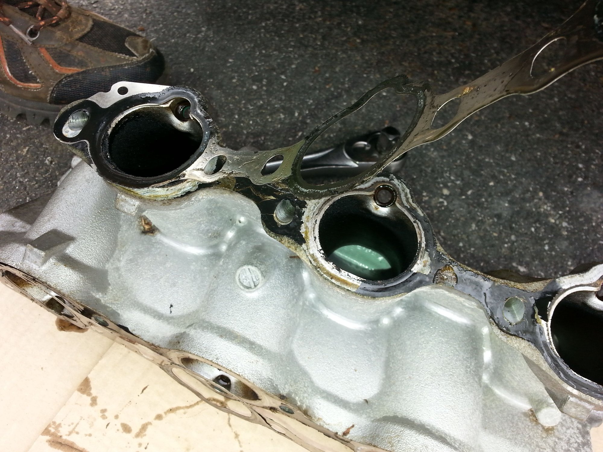

Waiting for the gaskets to arrive from rock auto. How does the injector clip work to swap positions on the rail? Is there something else I should do while its apart? I don't plan on swapping the valve covers, things seem ok in the tubes. Just plugs and gaskets for now.
Any tips would be appreciated.

No solvents will cure an oil consumption issue on these cars. It's most likely the precat that exploded and the engine sucked in some pieces and chewed at the rings. Only fix is to do a complete teardown.

Why would you swap an injector?
Pull the rail, clip em all in, hook up battery, turn on ignition, check for dripping.
If you see any dripping going on around the nozzles replace injector.

Because swapping spark plug and coil with another cyl did not change what cyl was misfiring. So I thought maybe change the injector location would rule that out as well. But I will try your method first, see if they hold with the ignition on.

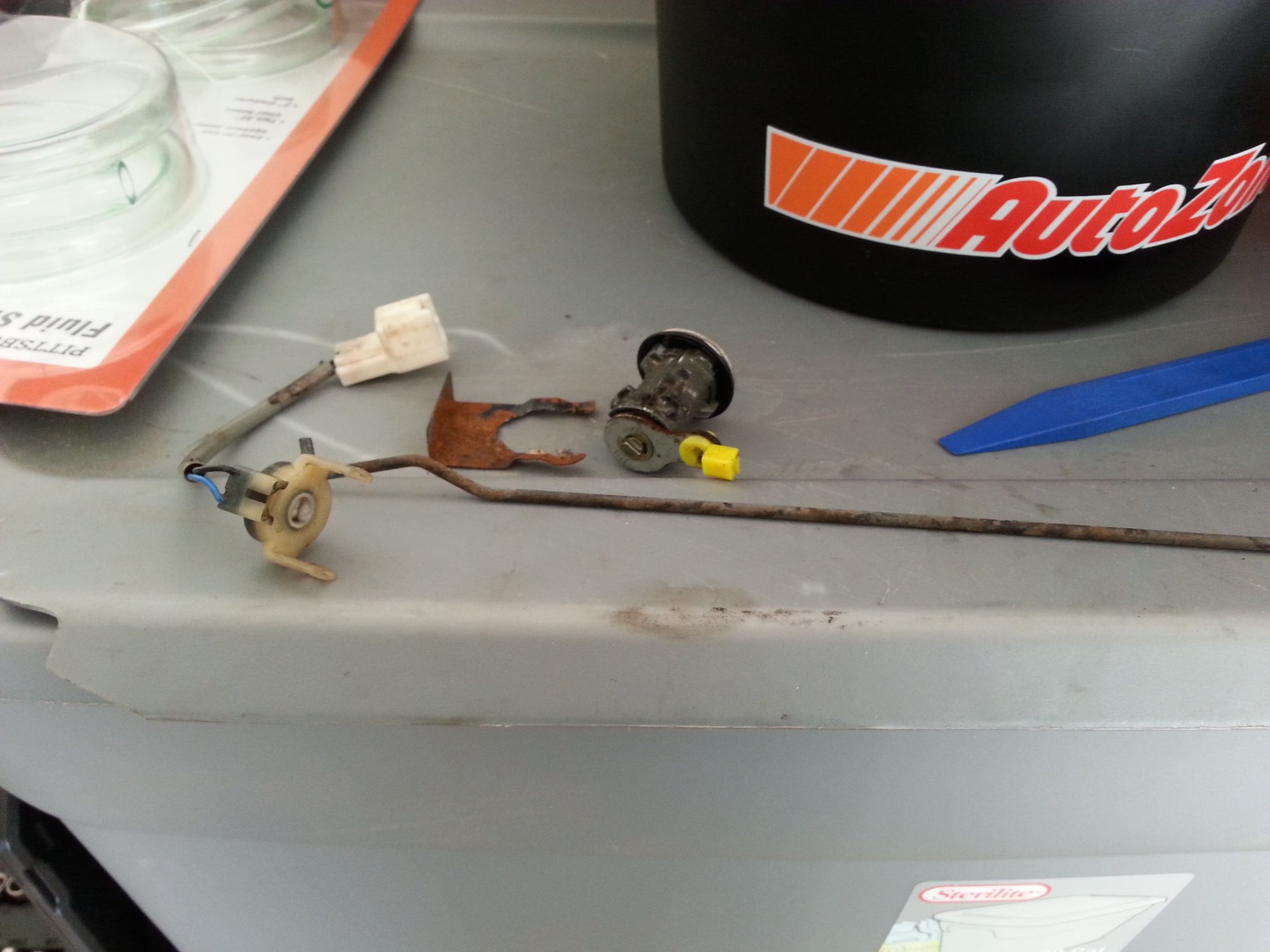

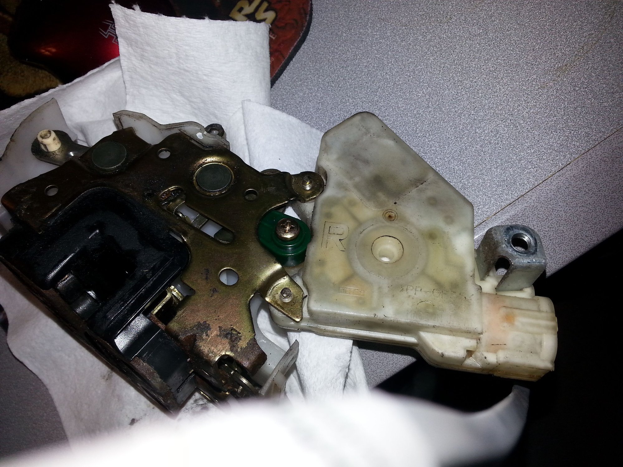

Driver's door not locking turned out to be the lock itsself. Swapped out the lock and actuator with a $15

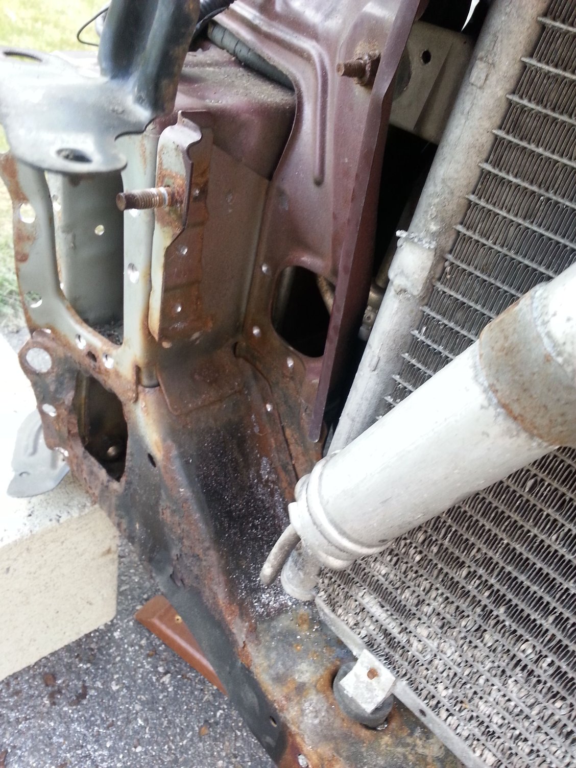

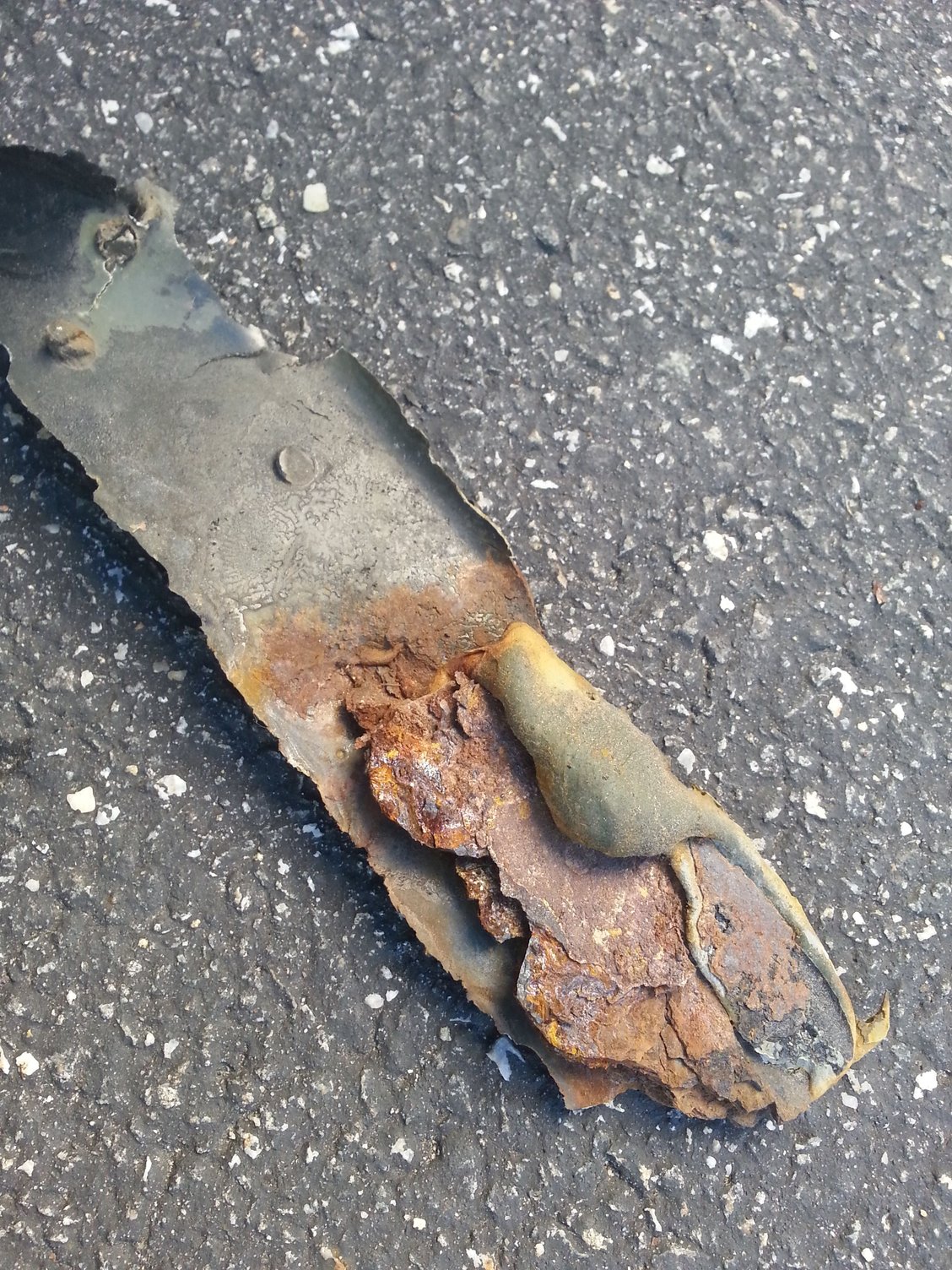

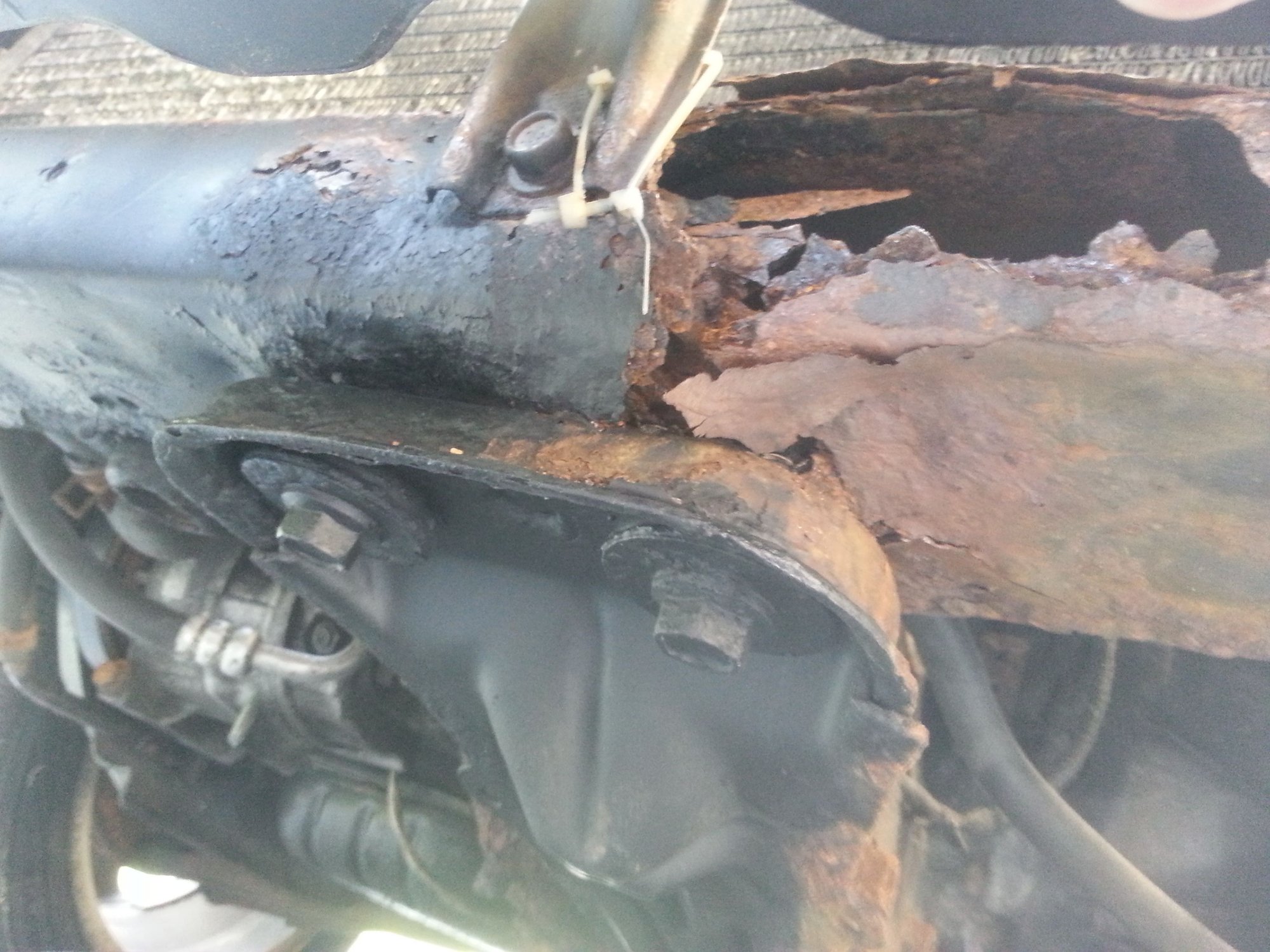

Almost ready to put the car on the road. I pull down the splash guard and notice something strange.
I poke at it, a chunk of Bondo falls out!!!!
Now we know why the PO gave up. Rotted lower radiator support/tie bar. Ugh.. I can't put the car on the road like this..
So.. Its disappointing, but may as well go ahead and replace.. Per the posts on here I ordered an OEM for $186 plus shipping.

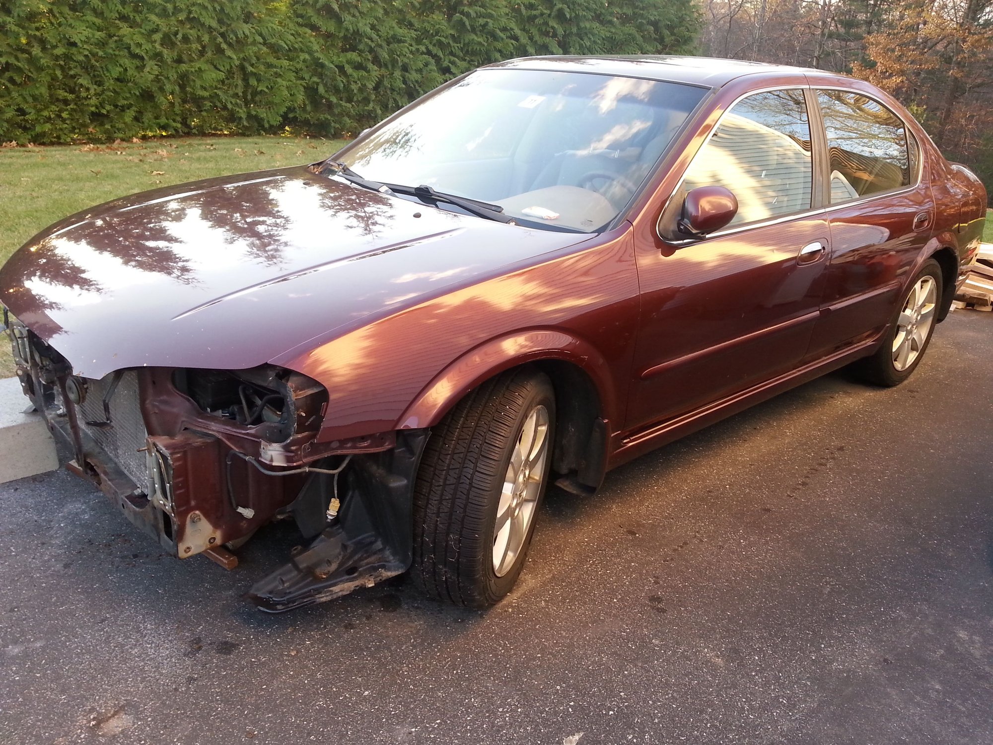

Nose is off.
I'm having trouble getting to some of these welds. I tried loosening and pushing stuff back, still obstruction. Decision made, removed the condenser and radiator.
Can't turn these bolts at all.
Now have room to cut and drill soooo much better..

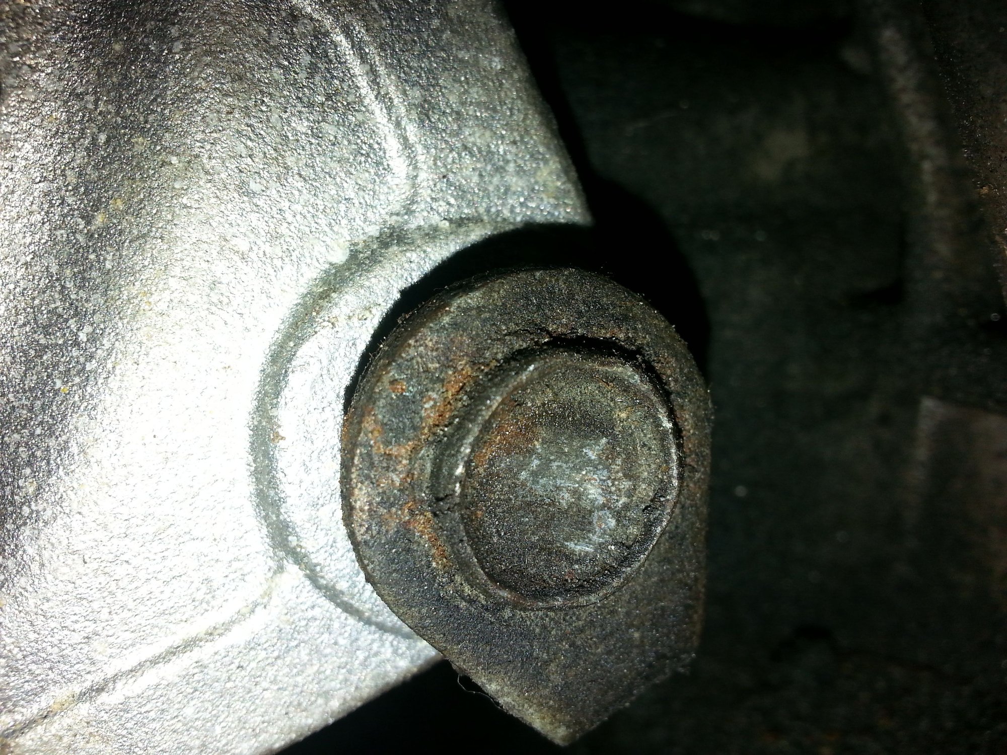

Anybody know what part number this bolt is? Can't find a listing.
Both sides these bolts that were exposed either snapped off or are in bad shape and need replacement

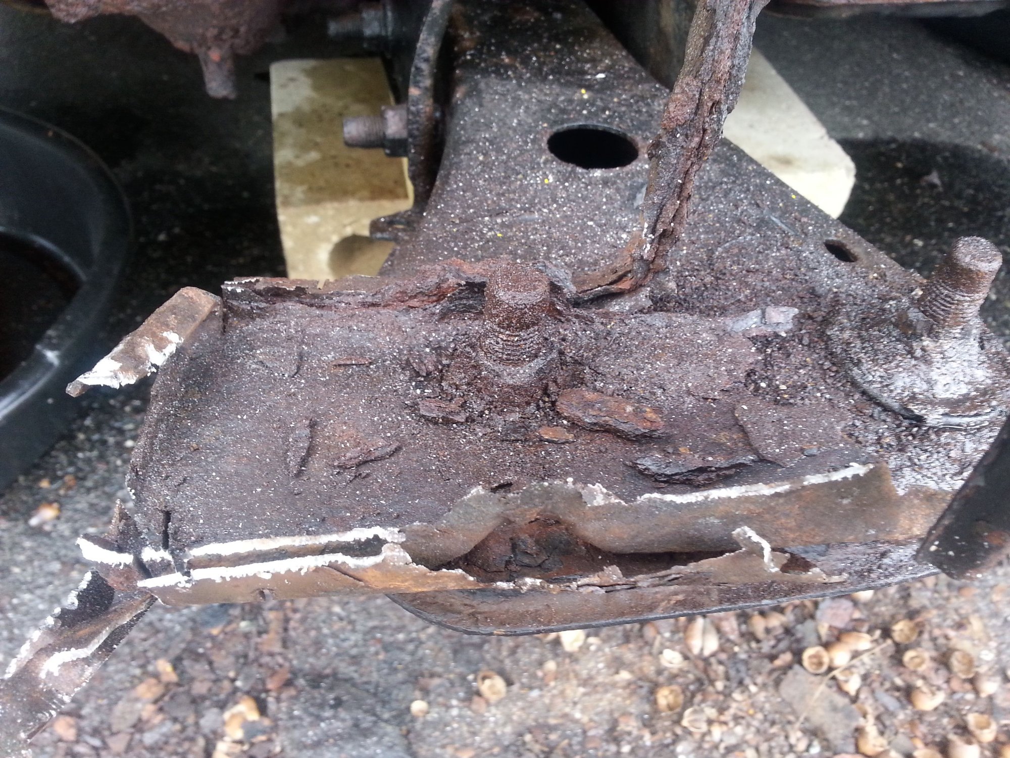

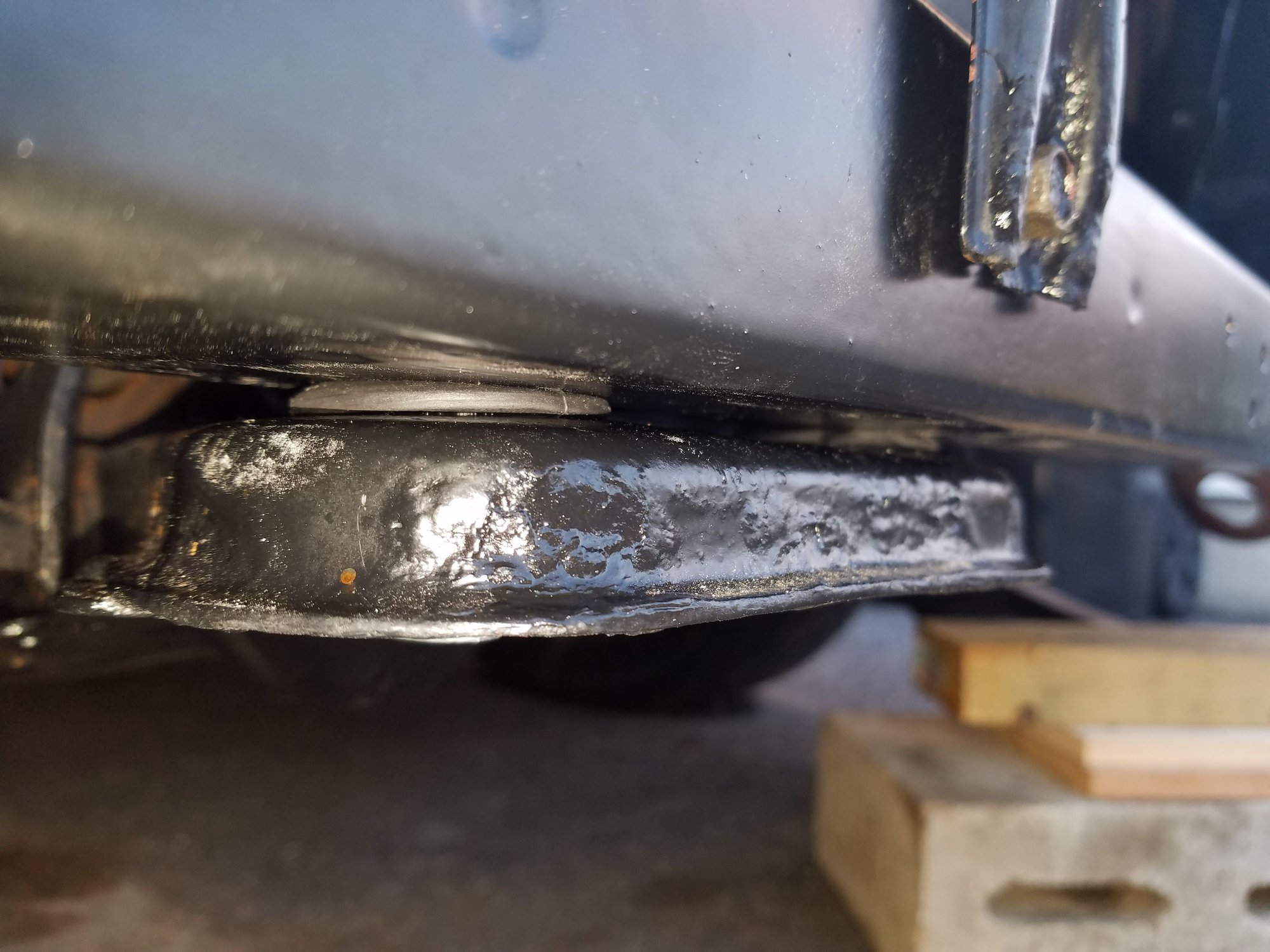

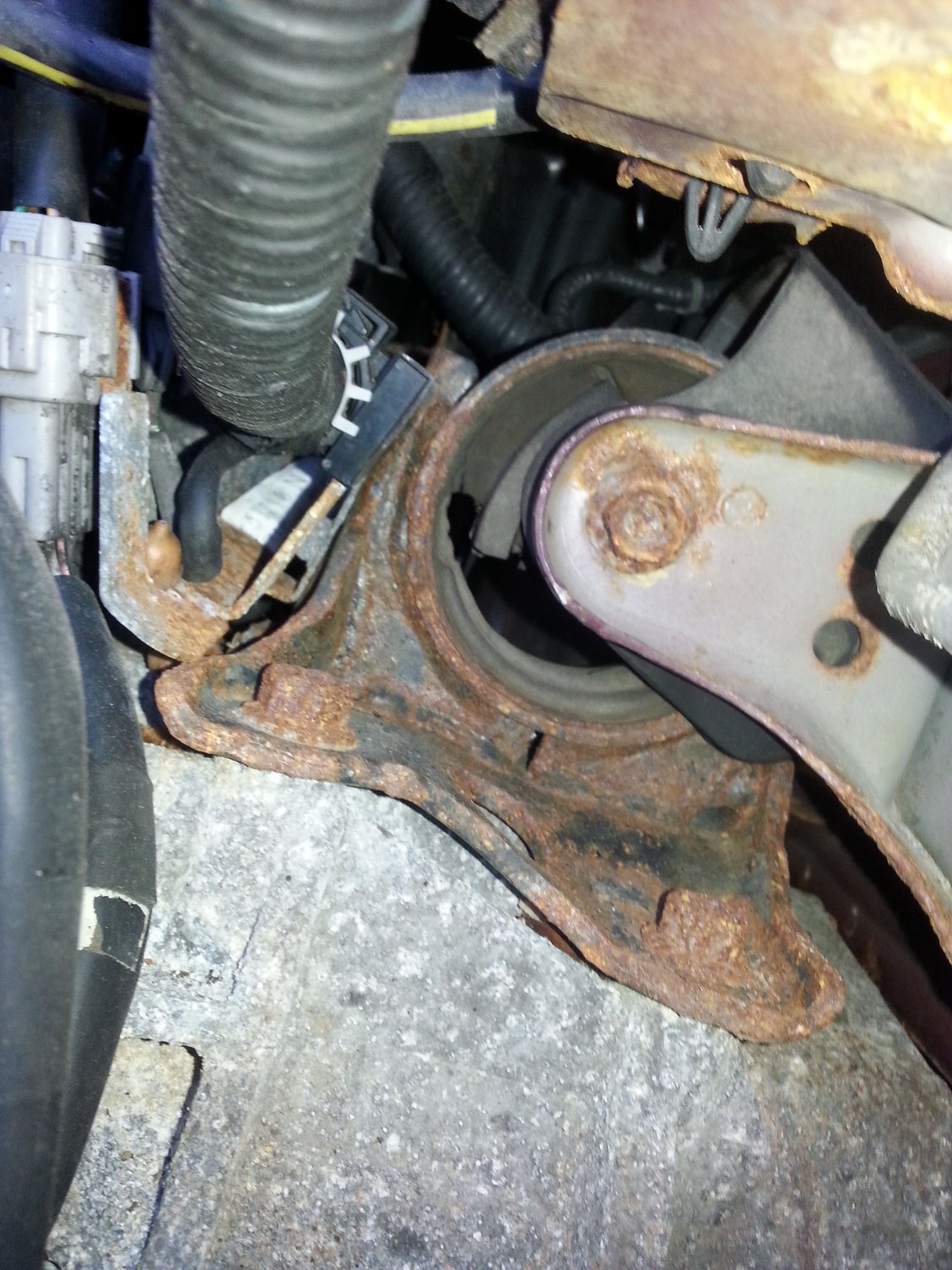

Observations and opinion about the importance of replacing this part.
Some refer to it as a "lower radiator support". And driving around with the engine crossmember separated and sagging is no big deal, because its just supporting the radiator. After a close look and researching the unibody design I disagree. With the condenser and radiator out you can see what the part is connected to, and why Nissan calls this part a "lower tie-bar". Tie-bars are structural. On our cars this part creates structure between the two sides of the front suspension. The control arms and struts are connected to the two box like structures, welded and bolted together with the support/tie-bar. This part does far more than just support the radiator. And the welds do more than tacking a part in place while it gets bolted in. You want this welded in place. Otherwise the unibody will flex and twist cornering. Not good for the suspension, not good for the engine and transmission. So in my opinion this is not something you can just ignore or live with. Any separation needs to be secured ASAP. Otherwise damage occurs and can become costly. As you can see in my example, all the motor mounts are toast because there is no crossmember support.
When the support sags, it tears the top of the lower front mount
Transmission mount rips up as the engine sags
I don't have a pic of the passenger side mount because its hard to see. But its low and bulging. Obviously toast.
Can someone tell me if the cheaper eBay mounts will last or crumble. I know the DEA stuff does/did on a Toyota I had. I see some decent eBay kits. One with an electric front for $78. Would love to get this set and install while its apart.

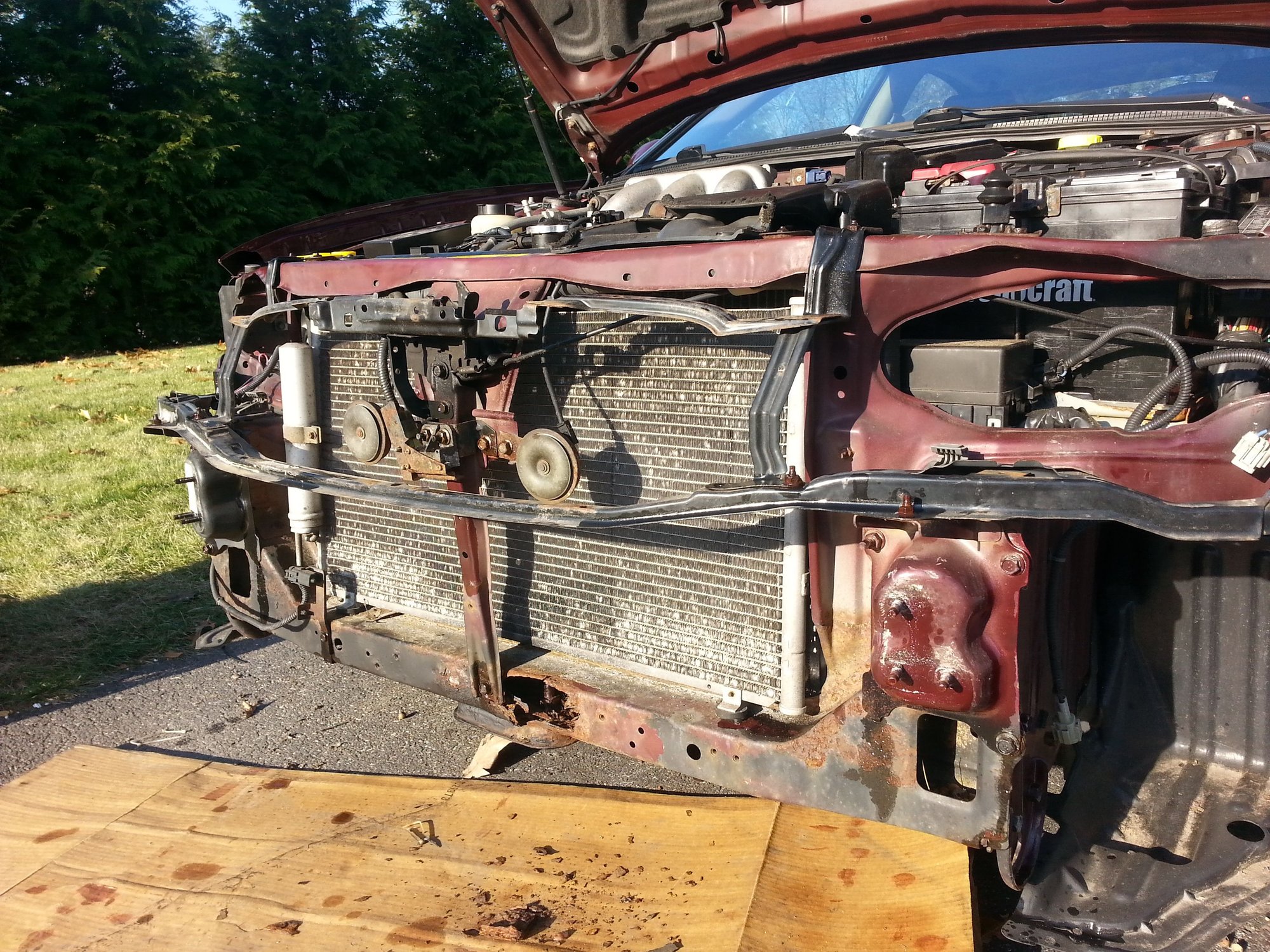

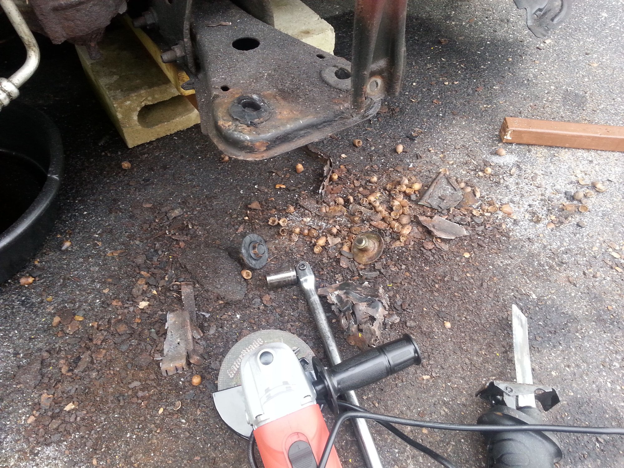

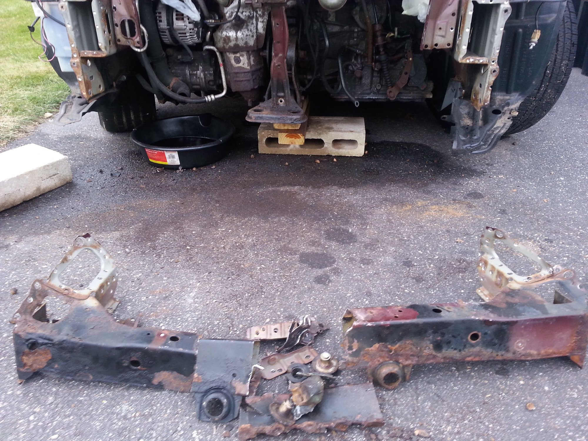

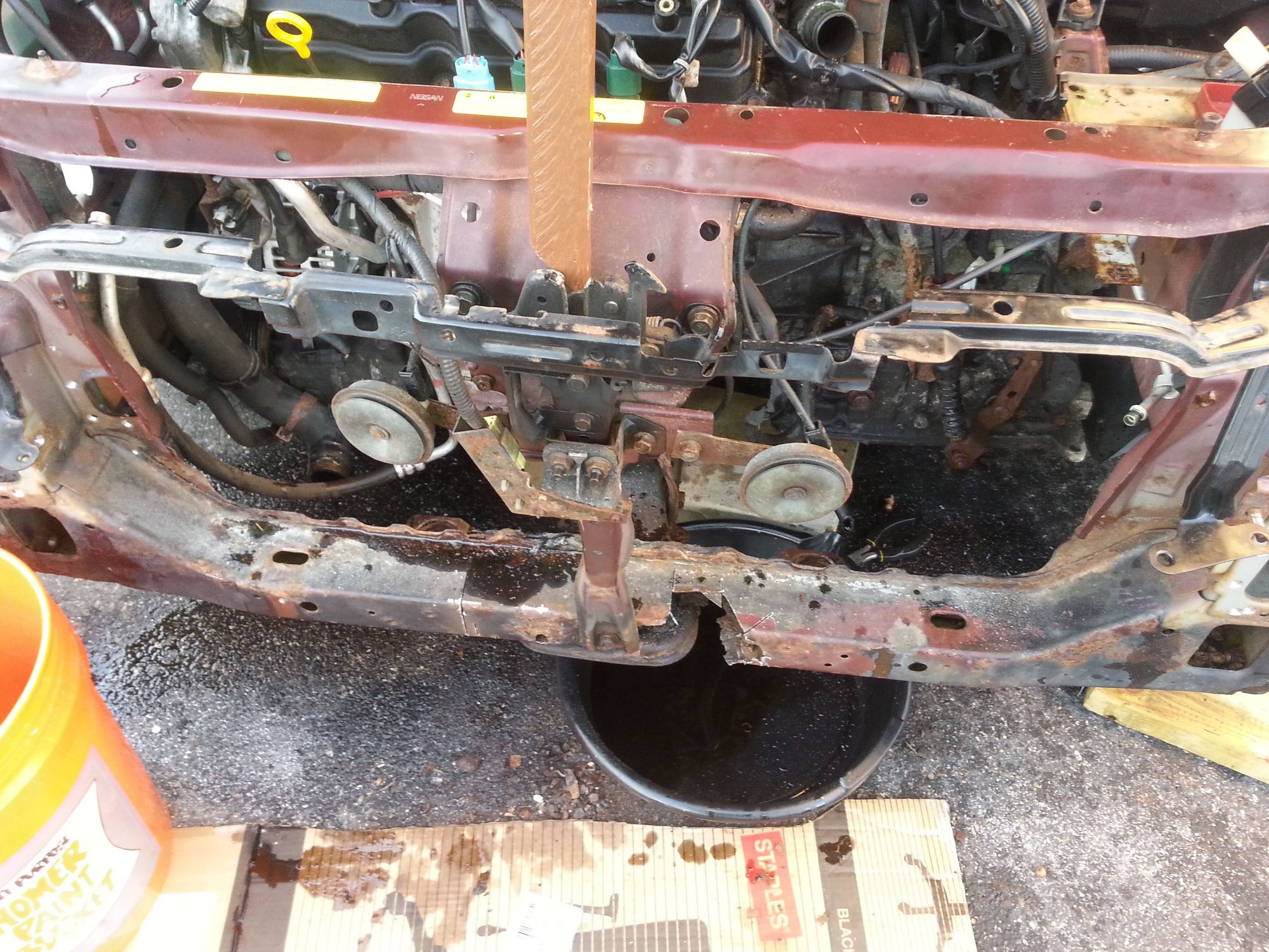

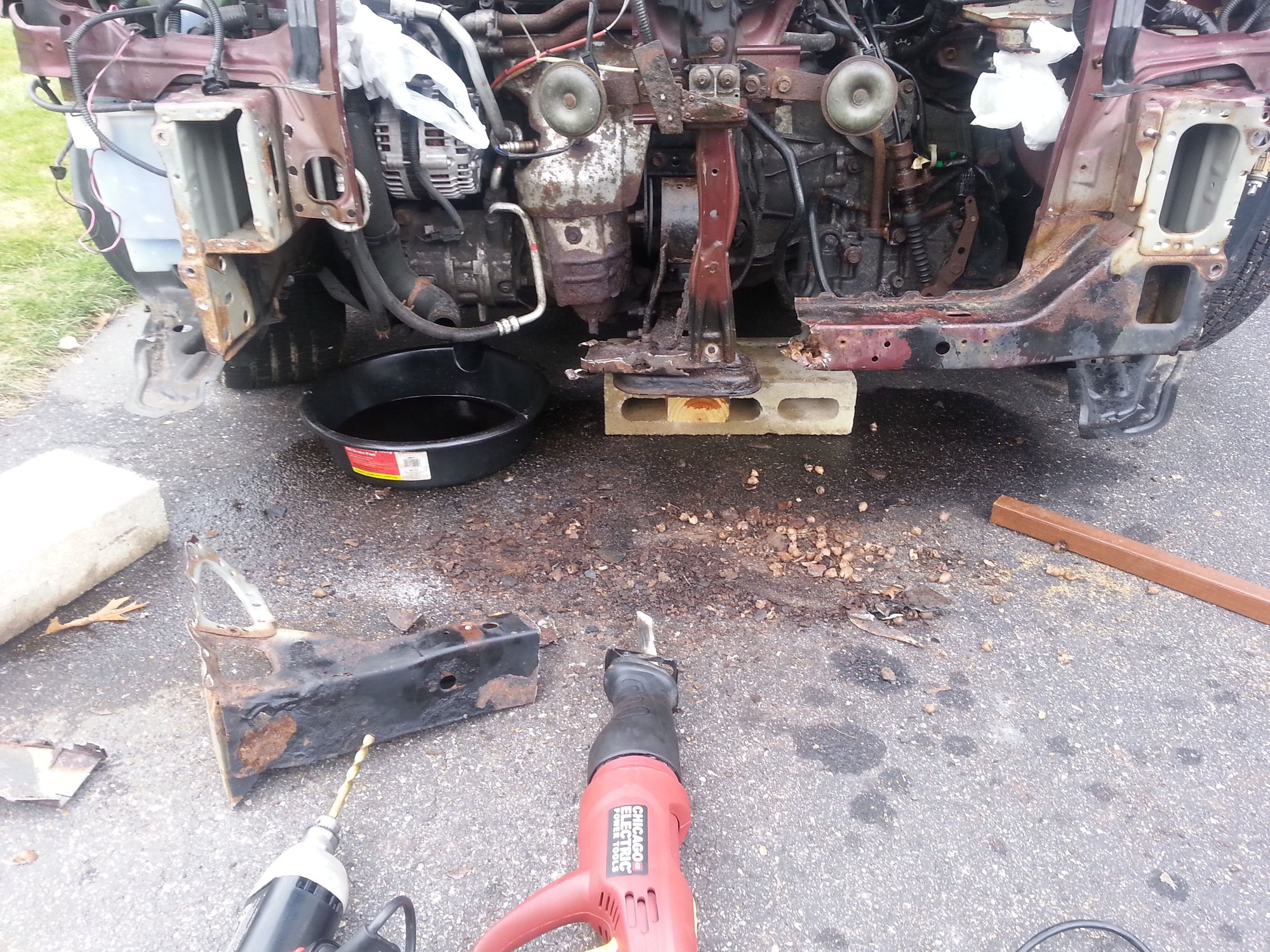

The cancer is removed..
First the sawzall. That was important. So I could tug on things to see whats stuck
All thats left is the crossmember bolts. Rotted on solid. Vice grips just spin.
Cutting wheel on the grinder had them off in less than 5 mins
Going to clean up, wait for parts. You can see the crossmember is crooked. Because the failure trashed the upper, front lower, and transmission mounts. I also had to snip the transmission cooler lines to get the radiator out. The clamps rotted to the point I could not get the off. Going to try on a bench.

Part number 08157-0251F

Thanks! I googled that part number and was able to find a site with good prices on oem bolts, nuts clips, hoses, grommets, etc. I ordered a bunch of hard to find items. not that expensive.

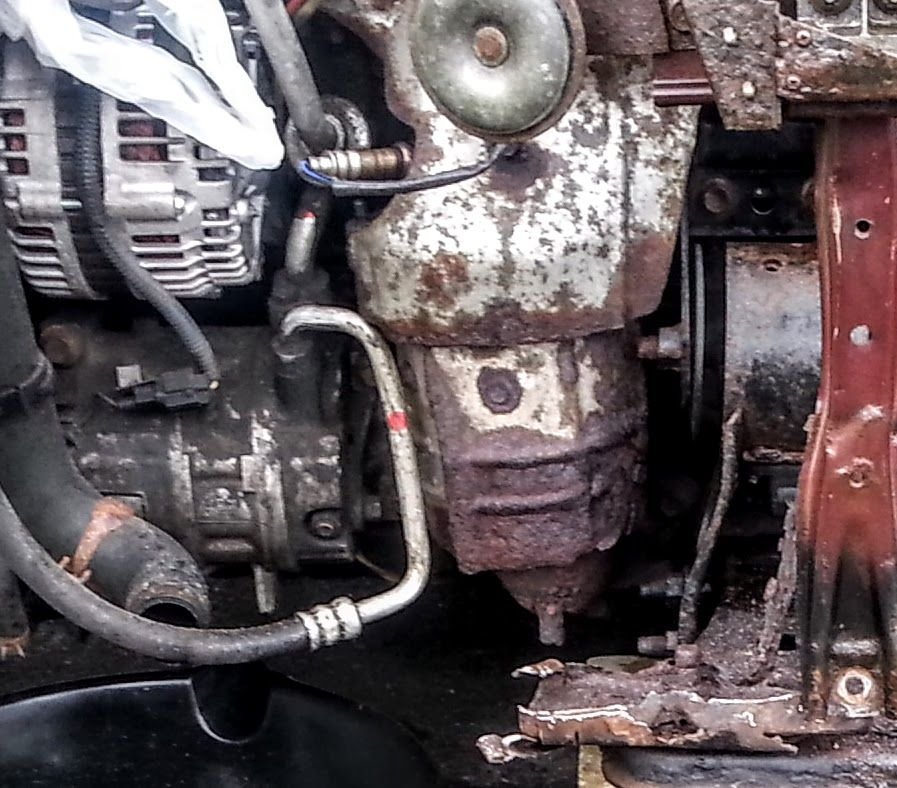

I see you romoved both radiator & condenser!
What I would say is cut the fingers off of a nitrile glove and stretch over the any open hoses or connectors!
​​​​​all that sawing and grinding could blow small steel pieces into open connections.

nice work, just saying if your going to to town like it appears, you mind as well as gut your existing precats and throw em back on ! and get an O2 sim for the light that comes on after gutting.
I put a plastic grocery bag over the condenser ports, but I'm going to use that nitrile glove idea!

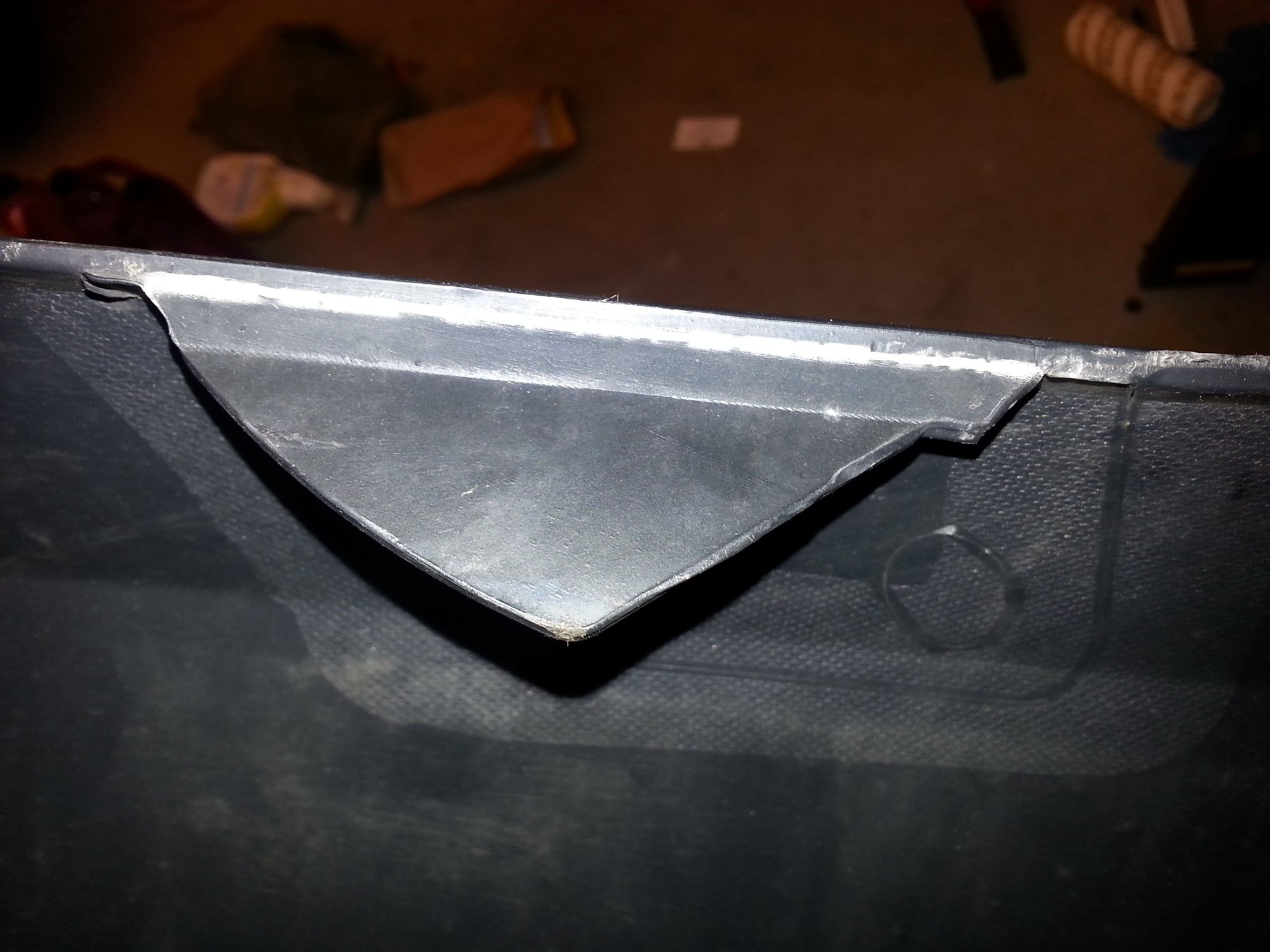

This car came with an unpainted nose. I plan to paint the bumper with an aerosol match from automotivetouchup.com. I have some questions about the attachment. Taking it off seemed too simple. Some plastic rivets, 2 screws and it basically fell off. Was there supposed to be something here? Was just 2 self tapping screws and a weird plastic part.
This was bent down doing nothing when I took bumper off
Was this where it was supposed to go? In this bracket?

The engine has 2 oil leaks. One I think is the oil drain plug washer. The other leak is in the middle, between the transmission. Looks like its coming from this sensor???

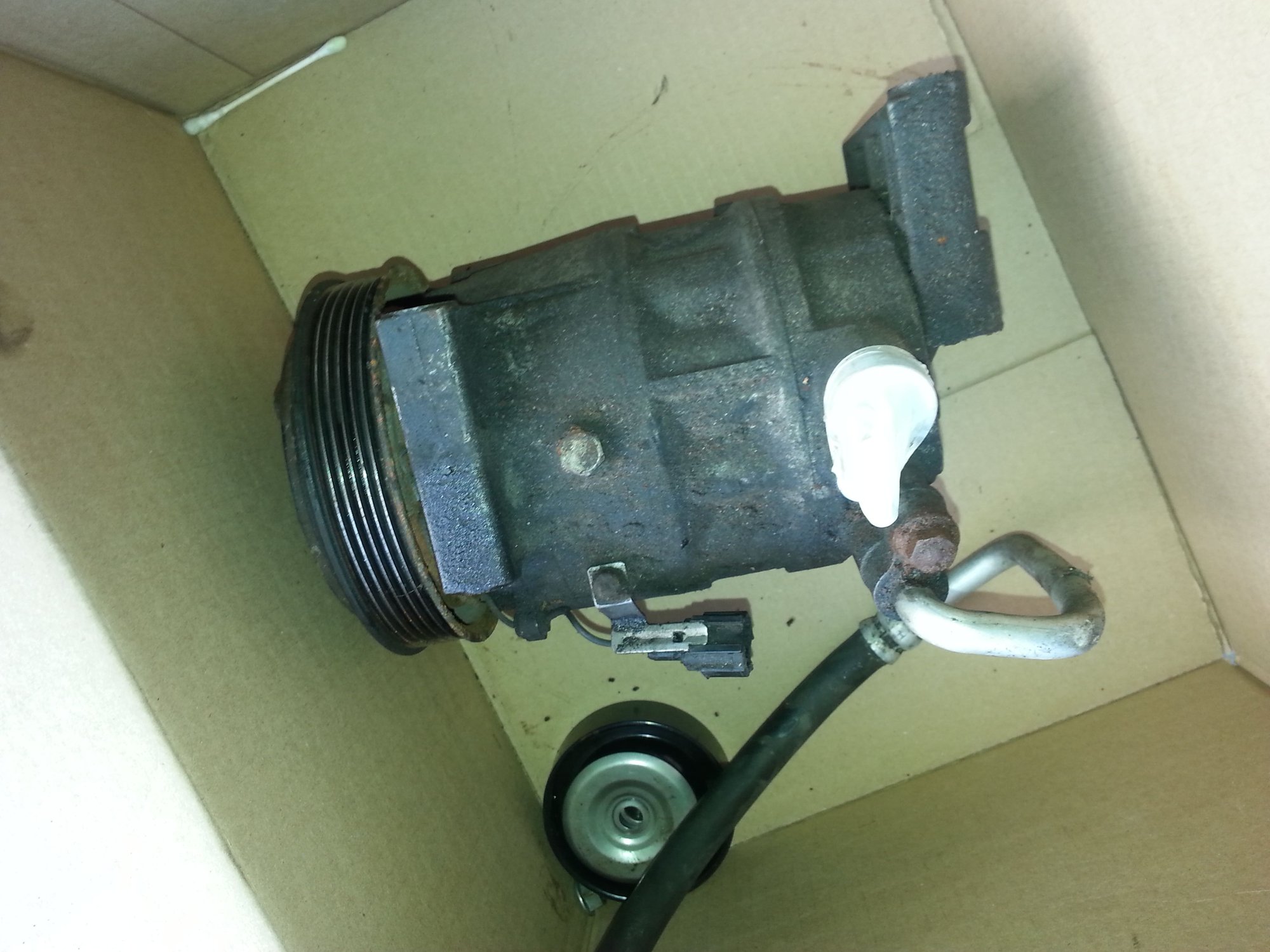

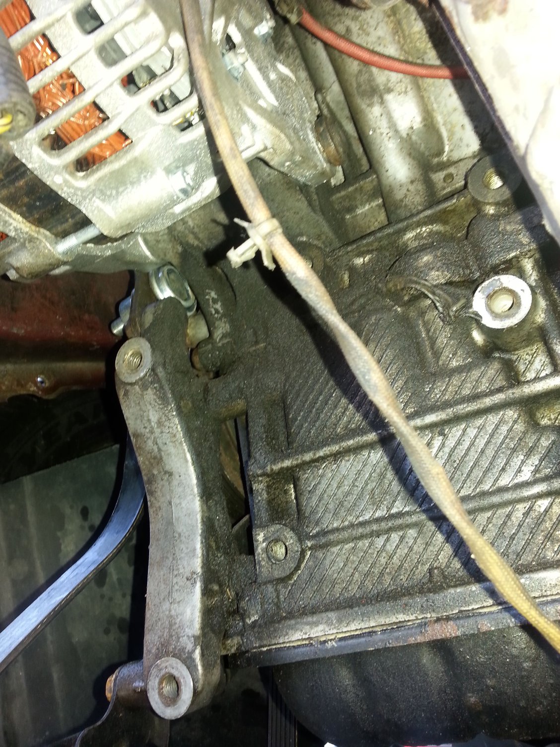

With the condenser evacuated, radiator out, I decided to tackle the rattle from that alternator I installed a few months ago. Same nightmare issues as before. Can't get a wrench or socket on the back bolt/nut with enough torque to get it tight. Its the hardest job of everything I've done to this car so far. Work on anything connected to the serp belts. Rather than be tormented for many hours again, decided to remove the compressor entirely rather than drop it, see if that makes things easier. It sure does. It turned a nightmare alternator replacement into something easy. i took a few pics for reference.
Compressor and all the lines removed.
Once the compressor is removed you can get right in there and get things done fast. As you can see by the end of this bolt, its not tight. The bar at the bottom of the bolt should be twisted against the body of the alternator.
Another view from where the compressor mounts. Hmmm looks like a gasket is falling out near the upper right bolt hole ..
Plenty of room to crank the alternator bolt tight. Was done fast. In hindsight, its worth it to recharge my AC vs misery over something that should be simple like replacing an alternator.

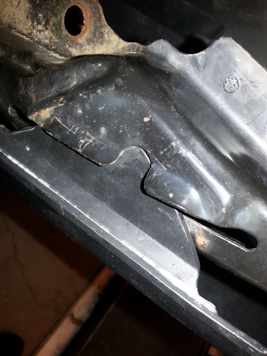

The front bumper has metal brackets that attach to the bumper with plastic rivets and then to the fender with those two screws. Theyre a dealer only part of course, i got mine from Courtesy Nissan:
$14.61 a piece.
https://www.courtesyparts.com/auto-parts/2003/nissan/maxima/gle-trim/3-5l-v6-gas-engine/body-cat/bumper-and-components-front-scat
though I know plenty of people who make the best of a few zipties

I had to stop working on the project Maxima because of bad weather. Now that the weather is nice again I put the OEM rad support, but I have a question about the cross member. I put new OEM bushings on, but they are pancakeing or splitting, not sure. Right now I'm far less than the 77-98 Nm. 57-72 ft. lbs. torque (autozone repair manuals). Does this look normal? Will they straighten out over time?
