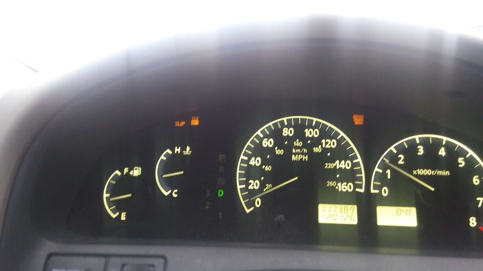

SLIP and TCS OFF,plus check engine light
Ok....it did it again, but this time COMPLETELY conked out. I pulled the following codes
p1800
p0345 (pulled twice)
I wonder if its just the VIAS sensor issue or the camshaft position sensors are gone too....???? ALSO, are both the Sensors bad or just one ???
Thanks!

You would get codes for cam and crank sensors, for starters.
If your cam sensors are a toast, you would be in the limp mode.
If your crank sensor is a toast, you won't start.
Deal with the EGR system first.

Thanks Tarzan...
I see no other codes than the ones i listed above. Why would i deal with the EGR (which i believe is the Air Flow valve....correct) I think that would be a different code. (i think that code is p0100)
p0345 is cam shaft sensor...I would think to change those first...no?

Apparently after changing the cam shaft sensors, this fixed the problem. Code p0345 for the front n back sensors were the problem.
