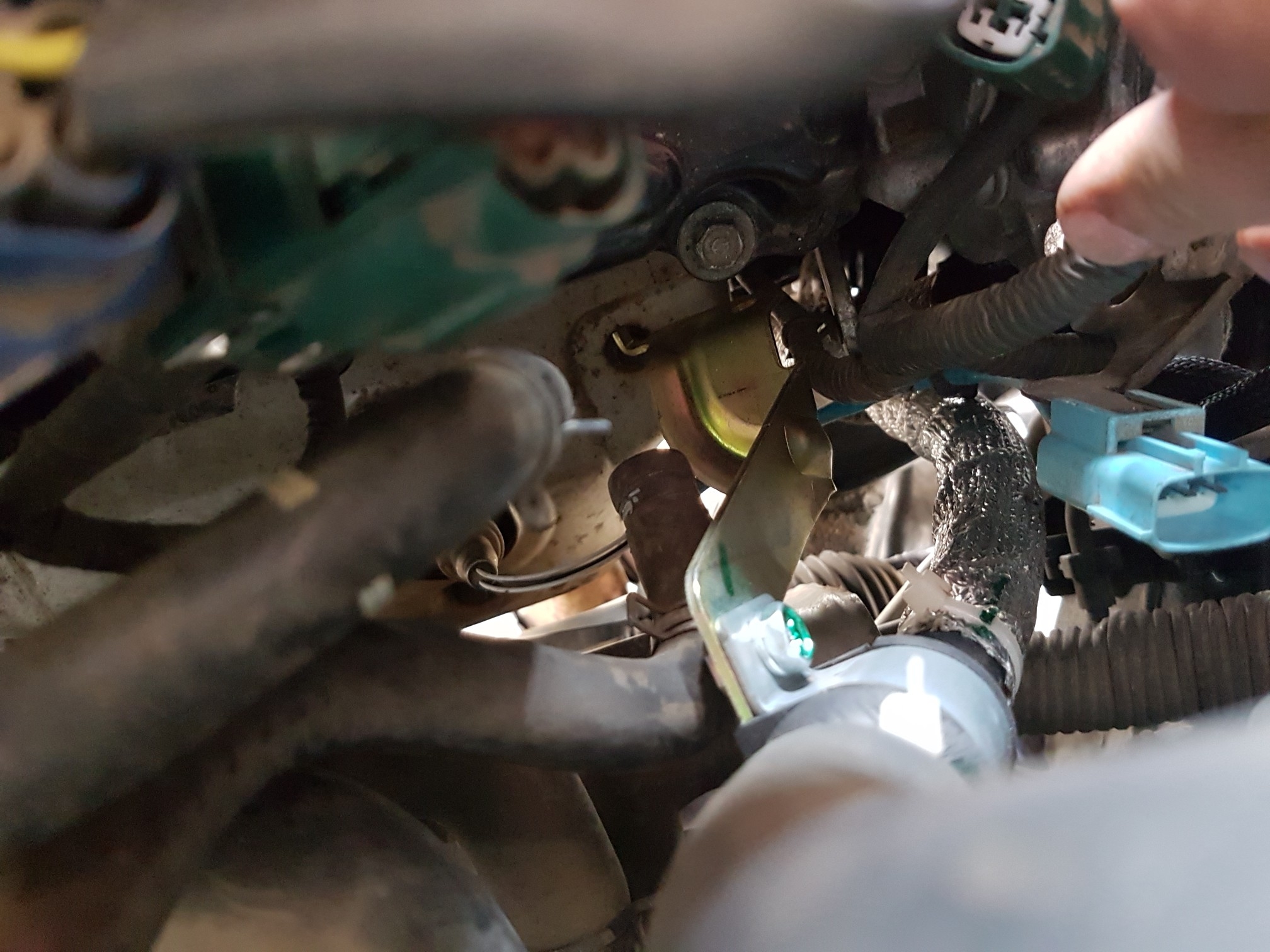

First up is the negative battery cable bracket. It seems awkward every place I've tried it.

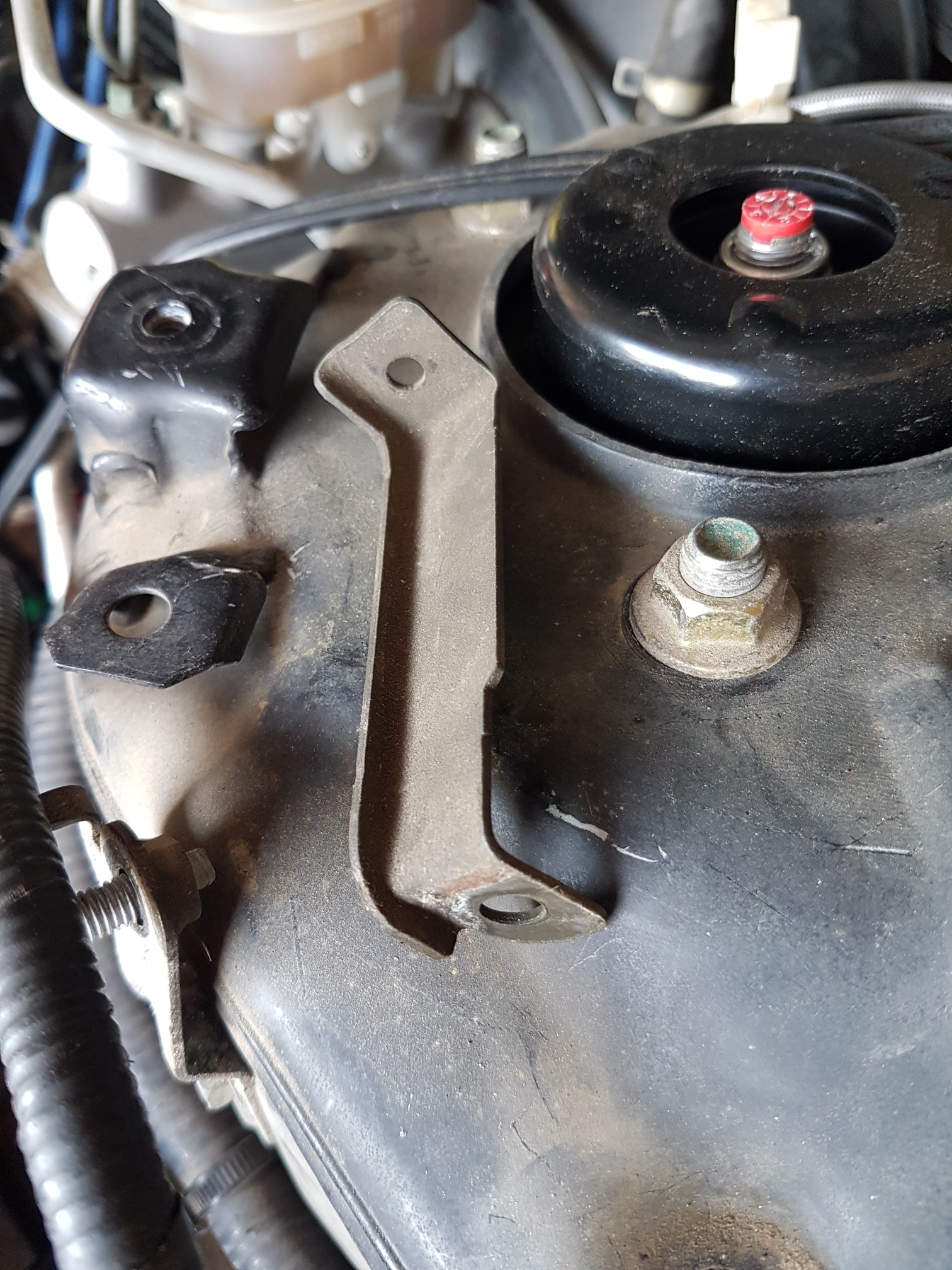

Next up is the mystery bracket. This one I'm not sure if I need to reuse or if it was on the old intake manifold??

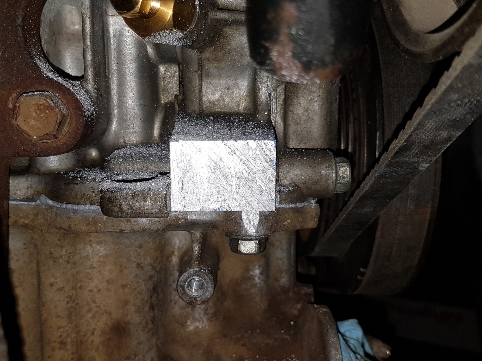

I want everything to be really tidy so I'm thinking of cutting off the bottom "tab" of the block (seen inside the power steering belt at bottom left of timing chain cover) so I can fasten the oil pressure switch harness to the oil pan? I have already disposed of my old motor and I don't remember if that tab was there on it.

The mystery bracket is a bracket used to hold wires in place. Off the top of my head, I know there's one on the front head in front of the valve cover and one one the driver side of the intake manifold. They have one of those zip tie clips in them and hold the wire/harness to the side.

Update. The battery negative cable bolts to the bottom middle of the coolant crossover. Don't know how I didn't see it before.
The mystery bracket would go on the head to the right of the O2 and CKP plugs but the newer valve cover overlaps the bolt hole so I'm leaving it out.

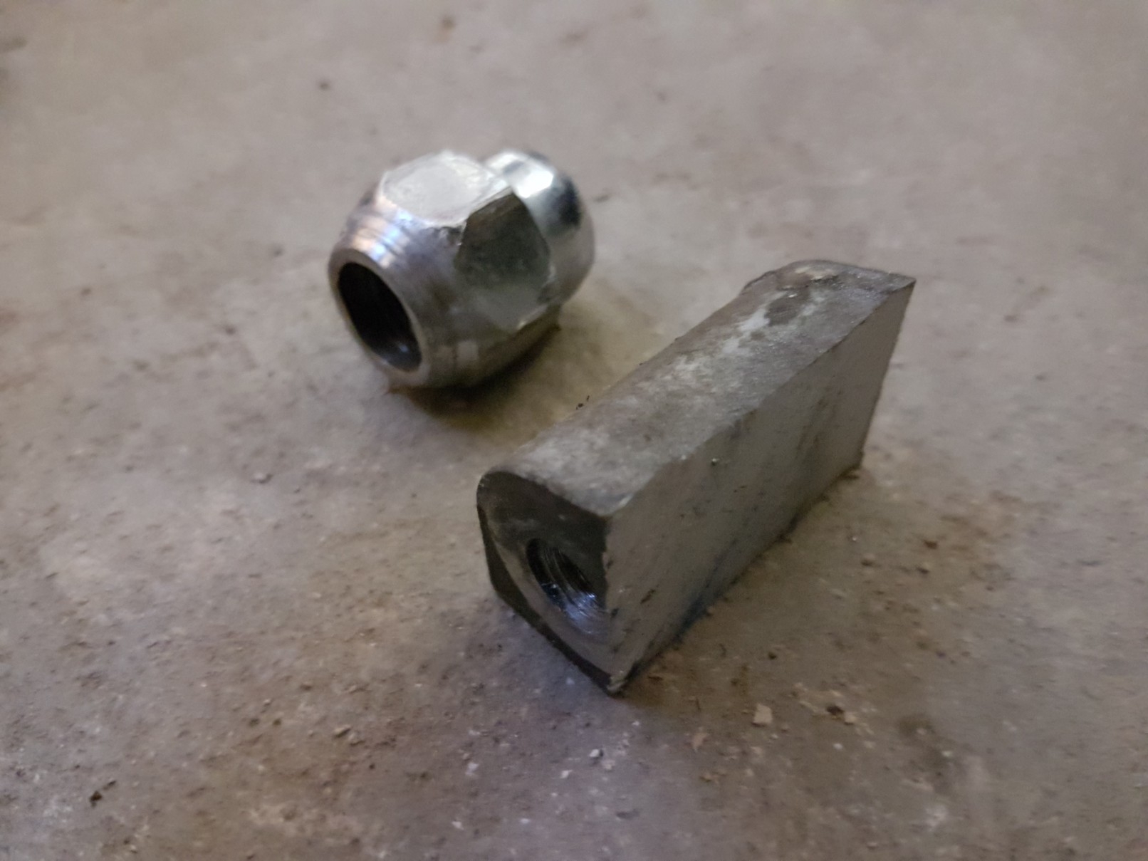

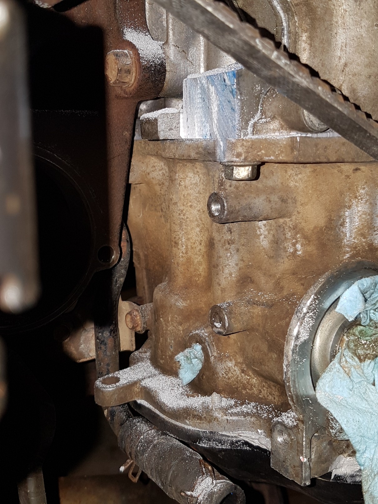

I cut the tab off the timing cover to allow the harness to bolt up to the oil pan. Then I remembered the harness was also behind the power steering pump mounting bolt so I loosened off the pump and stuck it in behind there too.

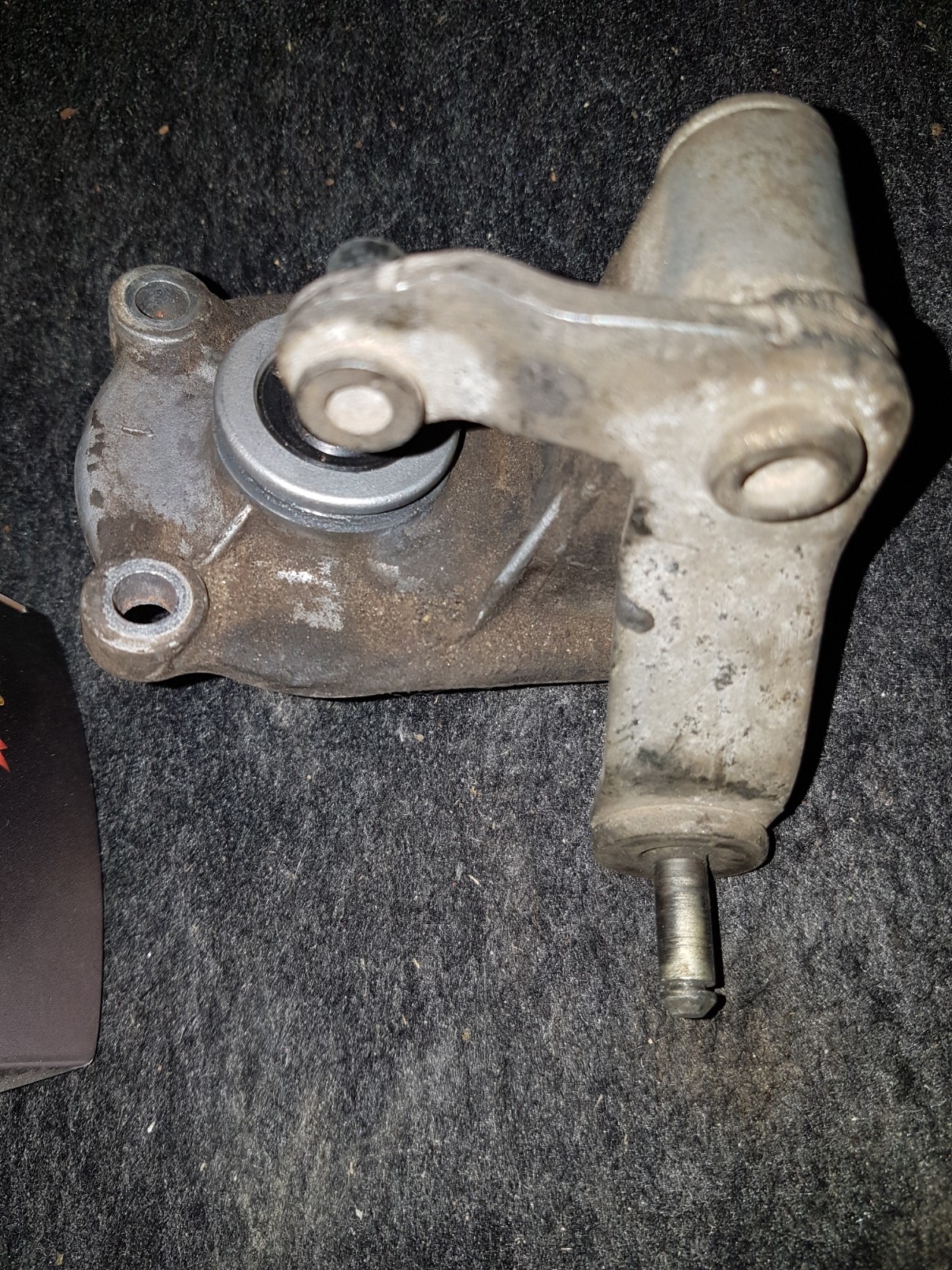

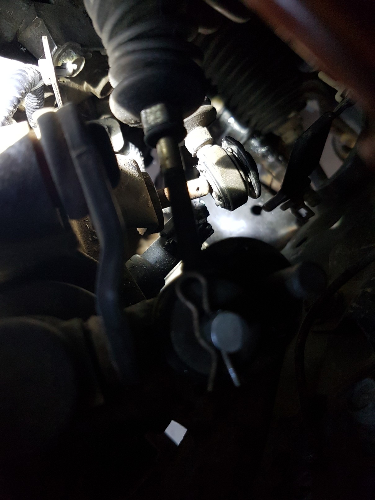

Need some help with this one... Figure out how this clip is supposed to go back on my shifter, I'm missing a piece I'm sure but not sure what??

In the second pic, it looks like something passes through the middle and the little metal spring clip holds it in place.

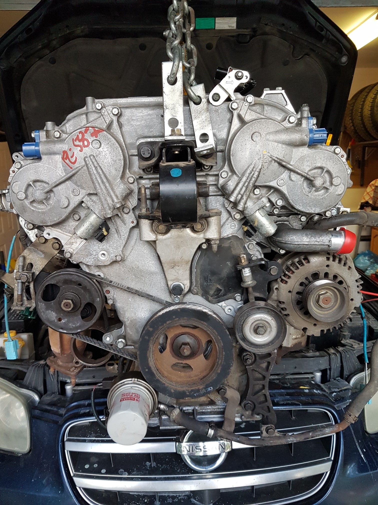

So, I grabbed a 6th gen shift mechanism from the PicknPull and it turns out they changed the pin, here's my 5.5 gen shifter in the trunk of the car. That'd fit real nice.
I also need to find a better intake, this is a bit too ghetto for me
Yeah. they changed that for the 6th gen. Easy fix though.
Also, the aluminum bracket that holds the cables in place is much better on the 6th gen cars. They tend to crack in the 5.5 gen. If you can get one of those that would be good.
