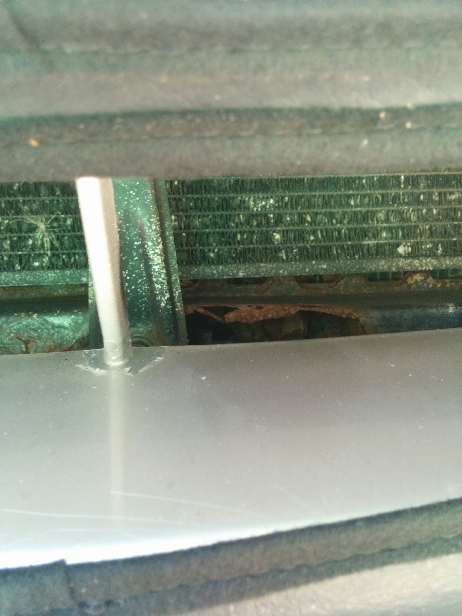

Here's a crappy pic of the rust. This isn't too bad, right?
Looks like mine. As long as you don't jack the car up anymore by there, it should be solid enough to not cause issues. Is the support bracket for the hood latch still attached or has that broke free as well?
