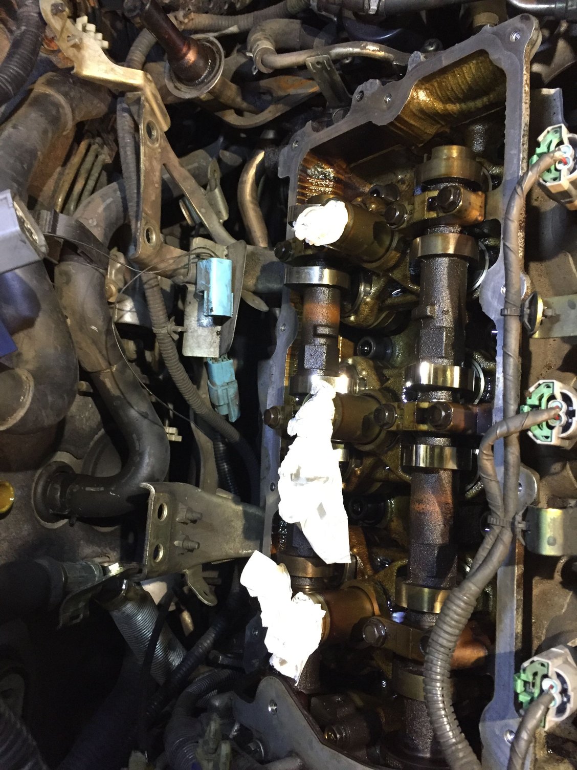

Old May 19, 2018 | 11:37 AM
Genes1s's Avatar
Posts: 1,162
From: Vancouver, WA
So, spent Friday to do the Rear Valve Cover gasket. 80% of my time was spent cleaning that removing that intake manifold. Man...there were 4 bolts that ties the intake manifold to brackets attached to the engine block. That took me solid 1 hour to remove them all. had to take the coolant heater core hose to access the bolts.
2 on the left and 2 on the middle. You can see I removed the coolant hose and bent the high pressure power steering bracket to access the bolts. Thanks Nissan!!

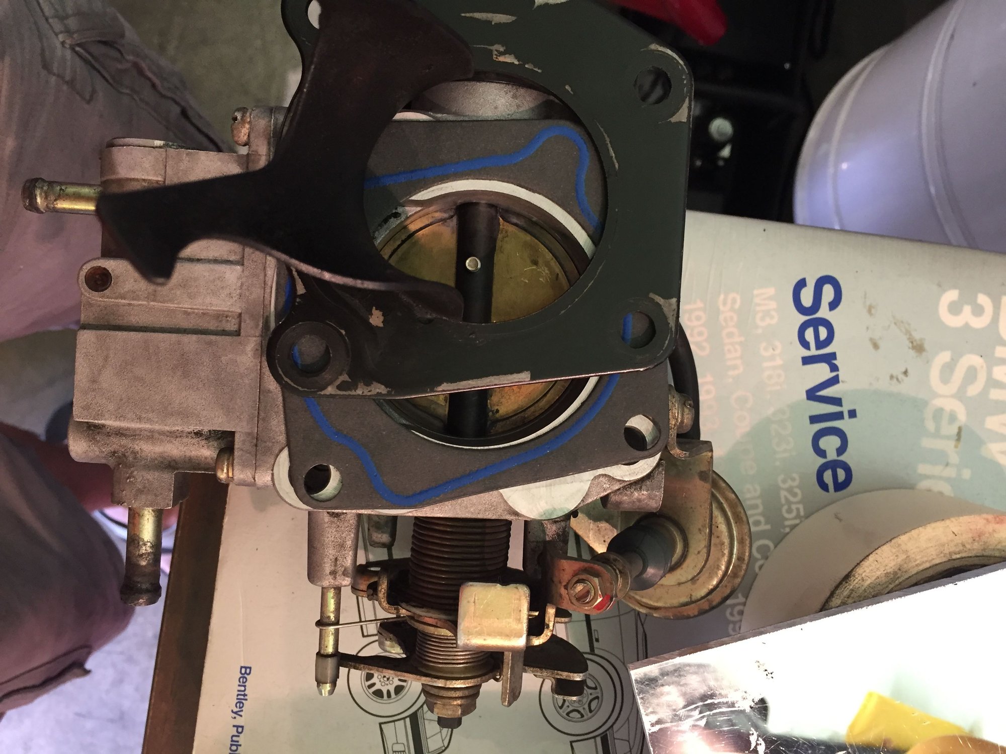

Old May 19, 2018 | 11:41 AM
Genes1s's Avatar
Posts: 1,162
From: Vancouver, WA
Throttle Body all gunked up....

Old May 19, 2018 | 11:45 AM
Genes1s's Avatar
Posts: 1,162
From: Vancouver, WA
The spark plug seal/boot looked different than the ones I ordered from Nissan, not sure why. I'm pretty sure the old ones were never replaced since new.
I didn't really clean the sludge. Tried to mess with it for few minutes and decided it was taking too much time. New plug boots, new gasket, new PCV, new PCV boot.
Old May 19, 2018 | 11:47 AM
Genes1s's Avatar
Posts: 1,162
From: Vancouver, WA
Cleaned Throttle body and new gasket too.
