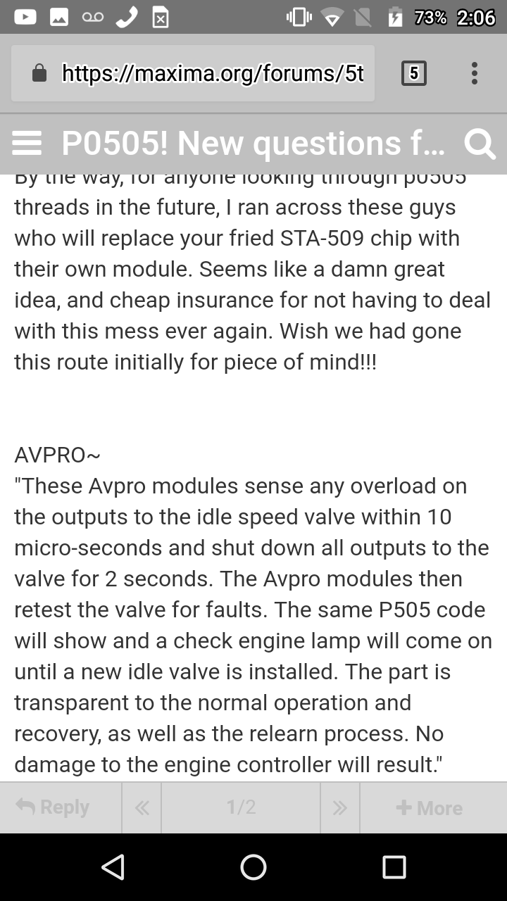

Just making sure I understand you right. I hope you don't take it as rude. So right now you have the new Hitachi one installed along with your repaired ecu. Now just for my own assurement I ask are you positive that your new iacv (the Hitachi one you mentioned) has not been on the car with the unprepared ecu correct? Also your repaired ecu has not been installed while the older/ extra iacvs were still installed because they will both kill each other no matter which one is the good or bad. The repaired ecu will short and blow the sta509a mosfet inside the ecu. This can happen even if only briefly installed together will cause that code. If they never did come in contact and you're positive of that then I would suspect the wiring. How did you replace the connector? Butt splice, solder, or twist and tape? If you didn't solder and heat shrink I would urge you to go back and do so. Look into the sta509a mosfet, a desoldering pump, and maybe even practice removing and installing chips on an old mother board or ecu if available. Because it only kills 1 chip in your ecu...
Attached Thumbnails My p0505 journey so far-screenshot_20180426-140604.png   My p0505 journey so far-screenshot_20180426-124250.png   My p0505 journey so far-screenshot_20180426-140600.png
