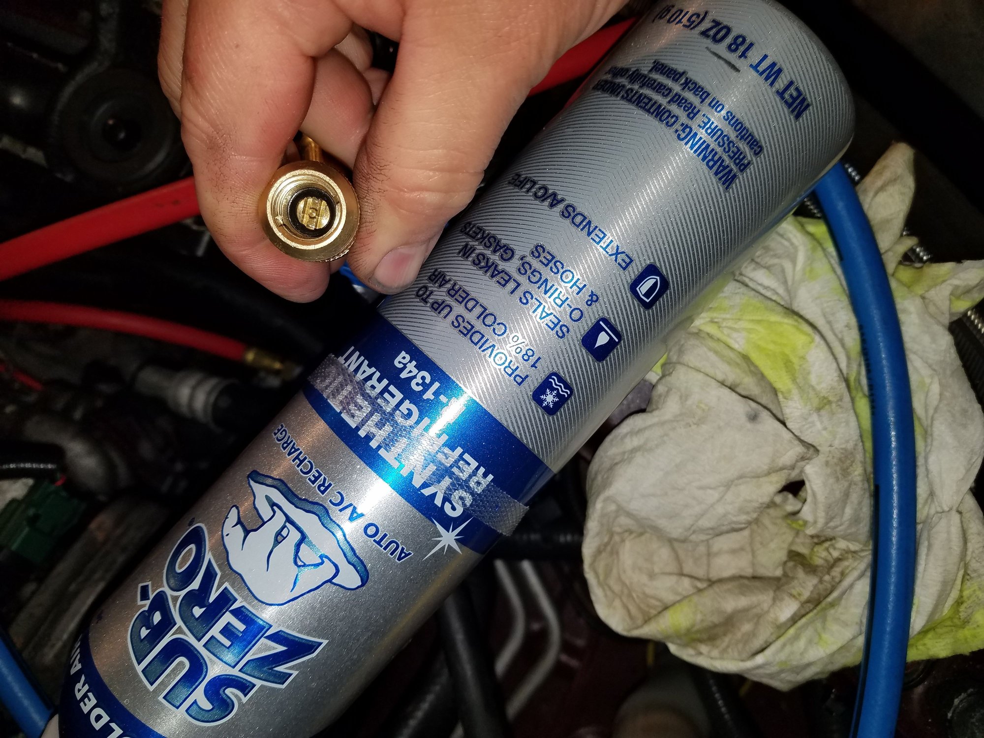

Hey thanks. I'm trying to keep from getting stuck on stupid but I was unable to get any suction because of this yellow line. I'm guessing there's some adapter that was not with the loaner kit. So I'm doing each side individually using the manifolds red and blue cables directly to the vacuum pump. Been vacuuming for about 45 minutes each side. I don't see any more mist coming from the pump so maybe it's ready. A picture of the freon I plan to use it's exactly 18 ounces which is I think the requirement. And the end of the yellow manifold cable which has me scratching my head. There are no other parts included with the loaner kit just three hoses and the manifold

One thing I should mention is that can of freon in the pic above hurt the schrader valve. The hose and connector it came with didnt seat proprly on the low port. So i pushed to get the freon in. Big mistake. It was nice and cold then when I shut car off I could hear the port hissing. Out of desperation I put a tiny screwdriver down the port and wiggled. It worked, stopped hissing. So I lost a little. Going to top off later with a different bottle and connector. Lesson learned if it's tight on the port don't force it. Better off using a twist type like the manifold. Something metal. Maybe the acpro connector is better. But im not sure i want to try.
