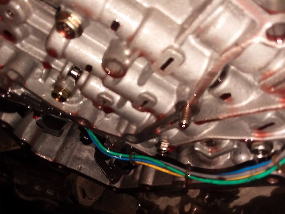

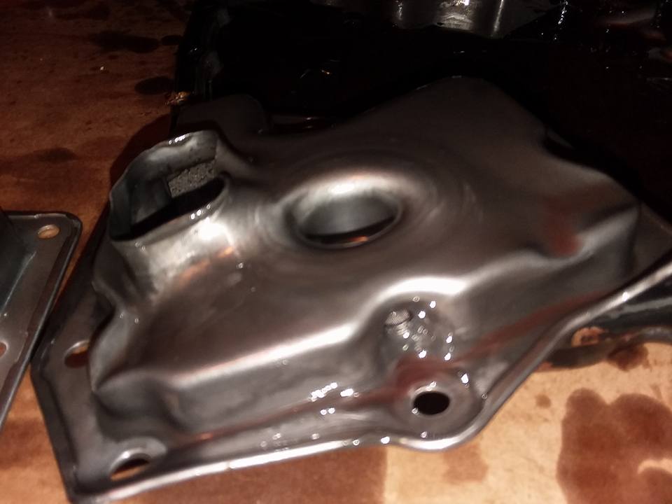

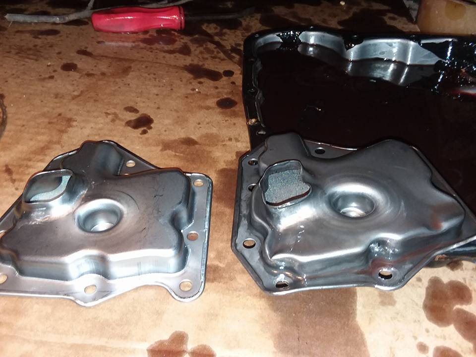

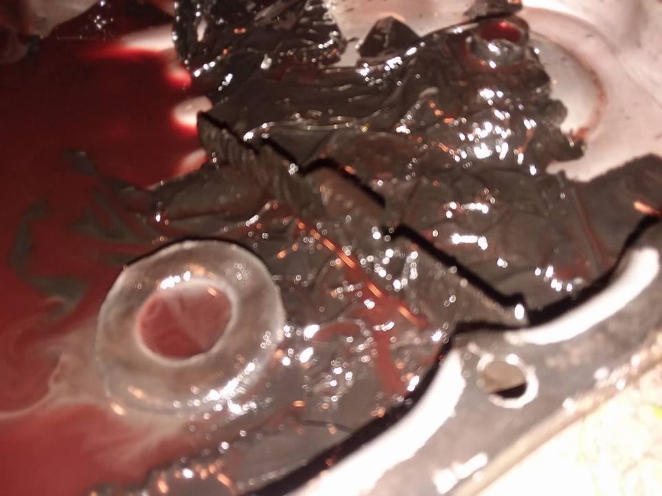

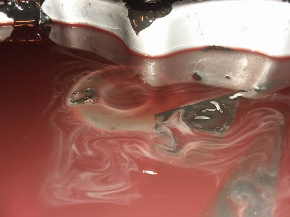

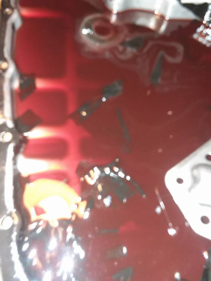

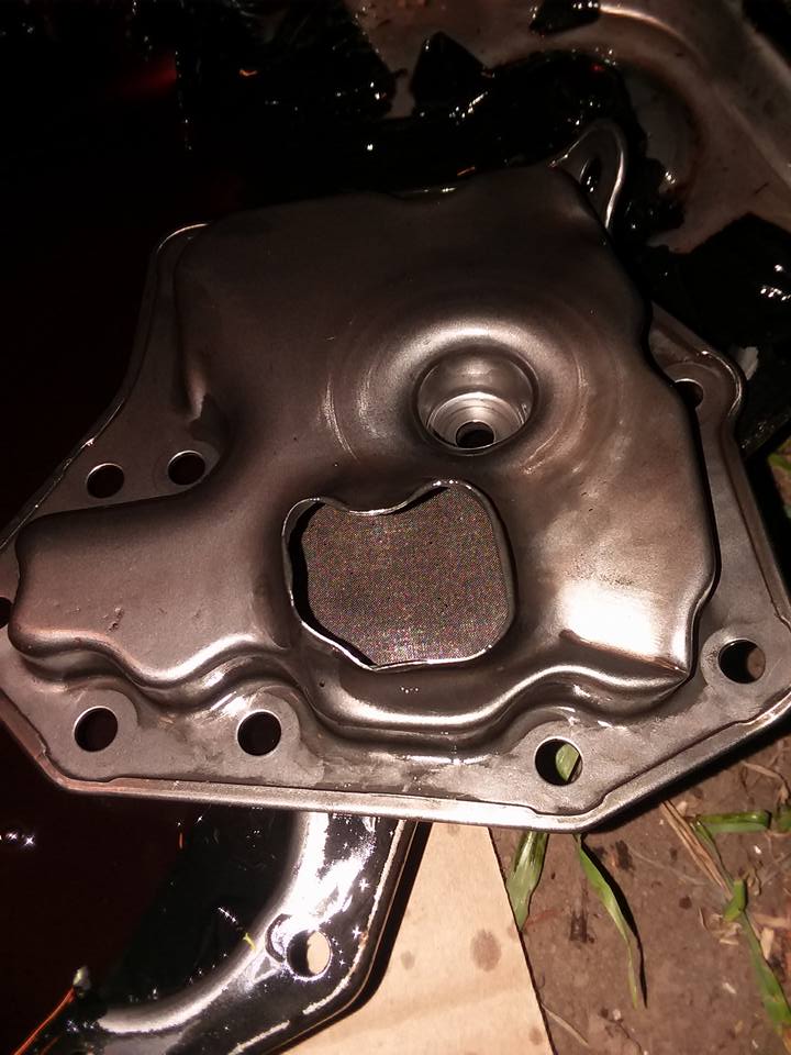

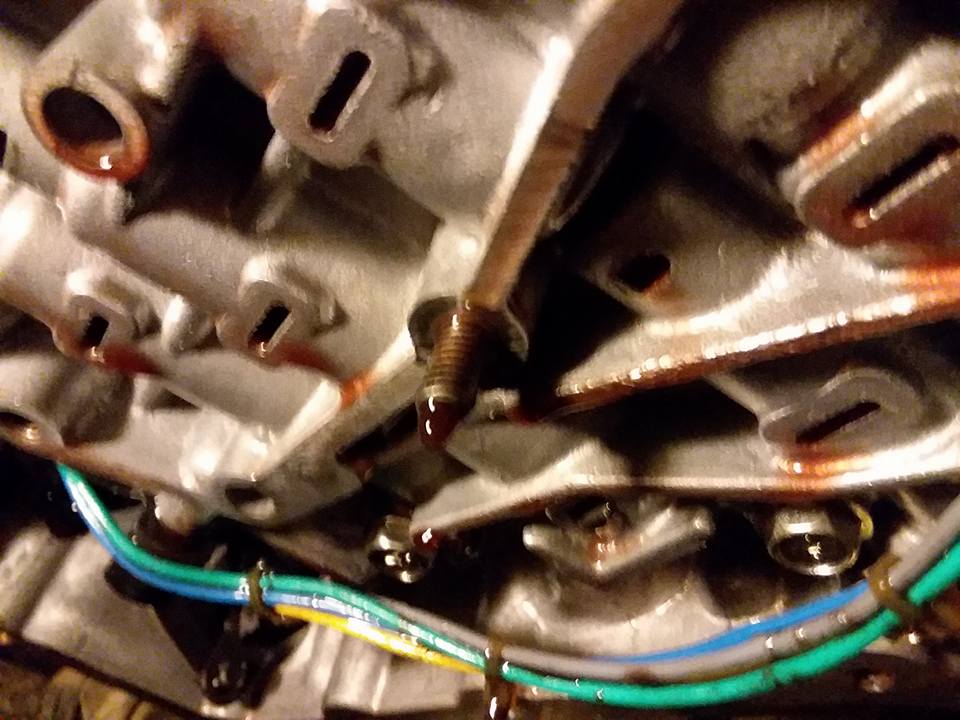

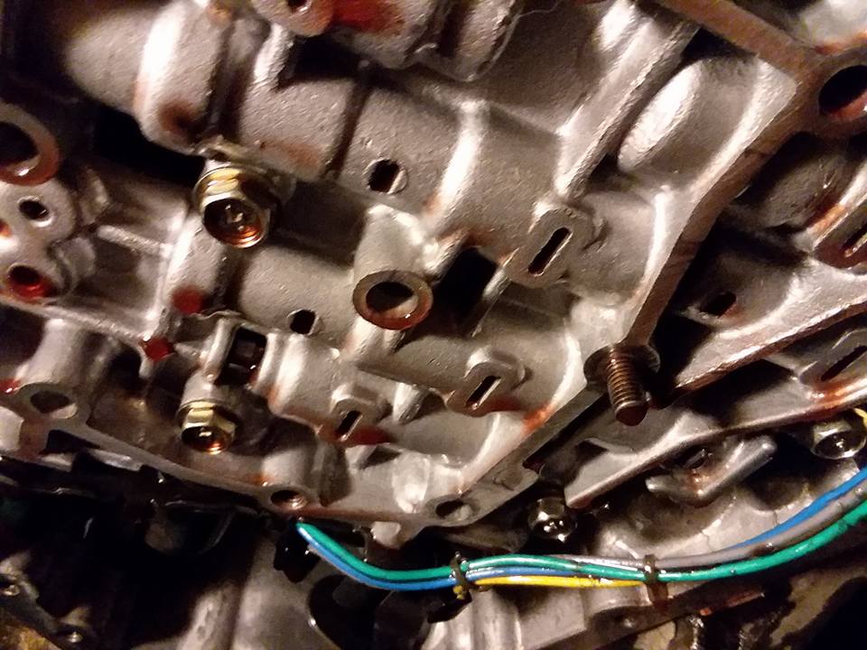

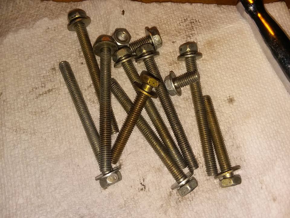

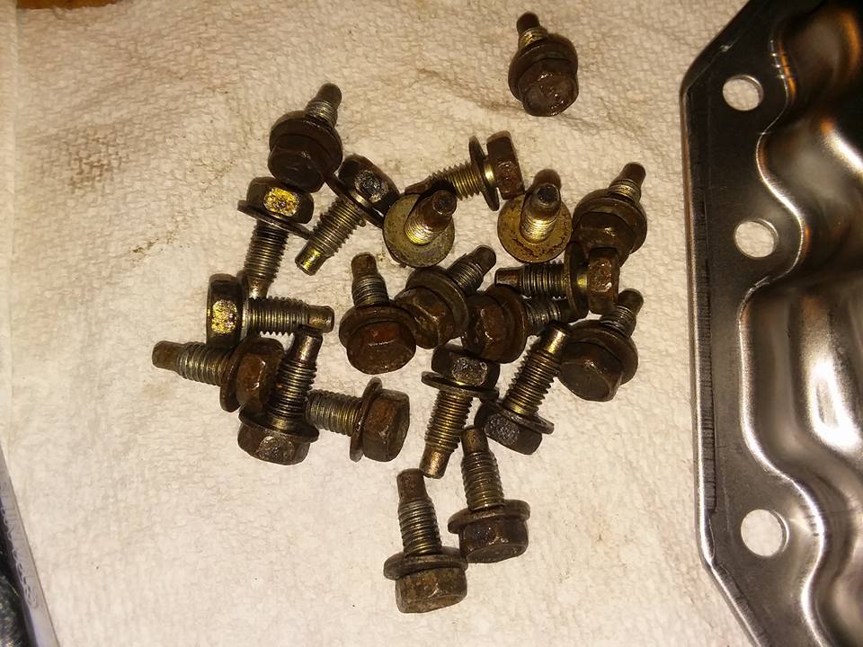

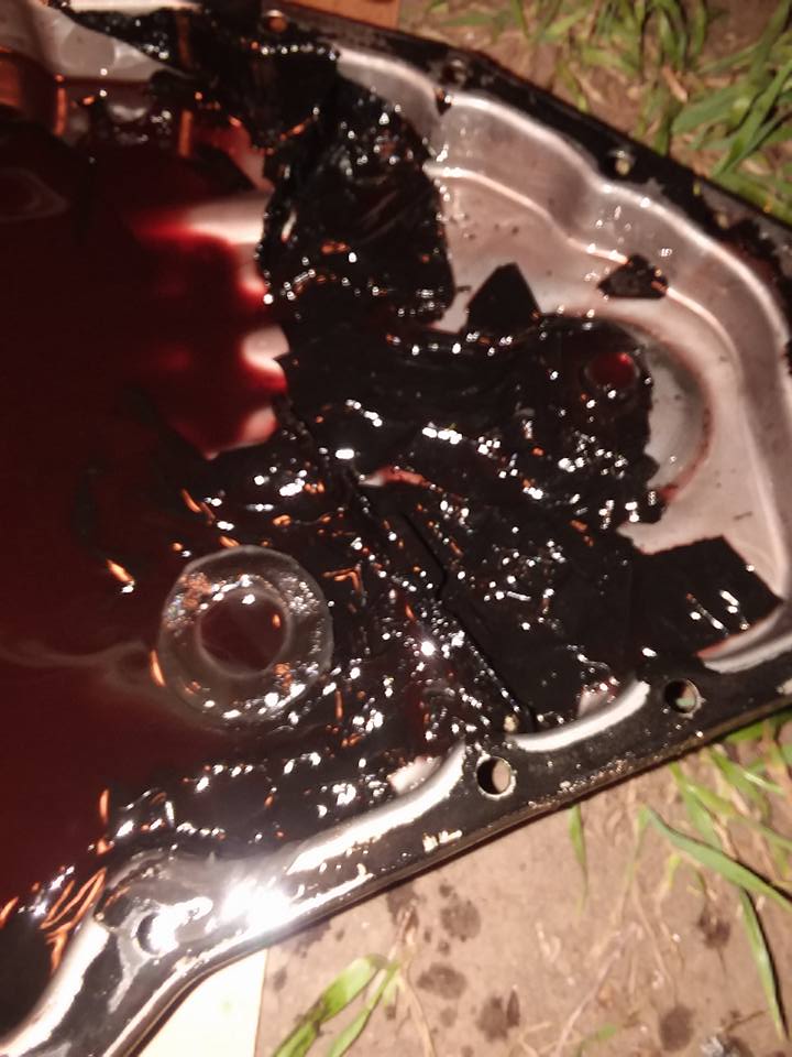

Transmission filter fluid change was not a fun job I guess they had broken off a bolt in the screen and they put a stud in there and every time you go to turn the nut stuck with turn also and I guess the last guy that tried to change the filter got mad at it and beat the **** out of it because I mean it wouldn't come off for a while so I took the filter bent it over and apply pressure and I turn the nut that seen that work fine I couldn't believe that I thought I was going to have to cut a slot into stud you just screwed already open-end wrench to do it but luckily it did I couldn't grind it because you couldn't have the grindings in the transmission that would **** it up for sure at least there was no metal in the transmission so 2 hours so far 3 hours probably I'm being attacked by a bunch of beetles and June bugs and mosquitoes outside at 11 at night about 10:30 I won't get done until 2 probably but that gook that's in the bottom of the transmission pan is paint and I'm sure that's was screwing up the transmission oh great now it's a damn moths coming to **** with me I have no idea why there's a pain on the bottom of the pan and it looks like I'm no idea

BTW i got the trany working fine i think the hard shifting is gone i used synthetic fluid and it took 8 qts total in a few months I'll drain it again and replace with same fluid have any of you all have issues with synthetic fluids i average 28 mpg and the engine load on a flat surface road going 75*80 mph is 31% engine load And up hill it goes to 48% and the RPM are 2685-2800 according to the app i have Nissan Data scan doesn't work keeps saying Ini Failed why thanks Austin

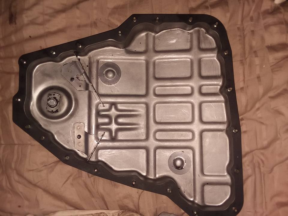

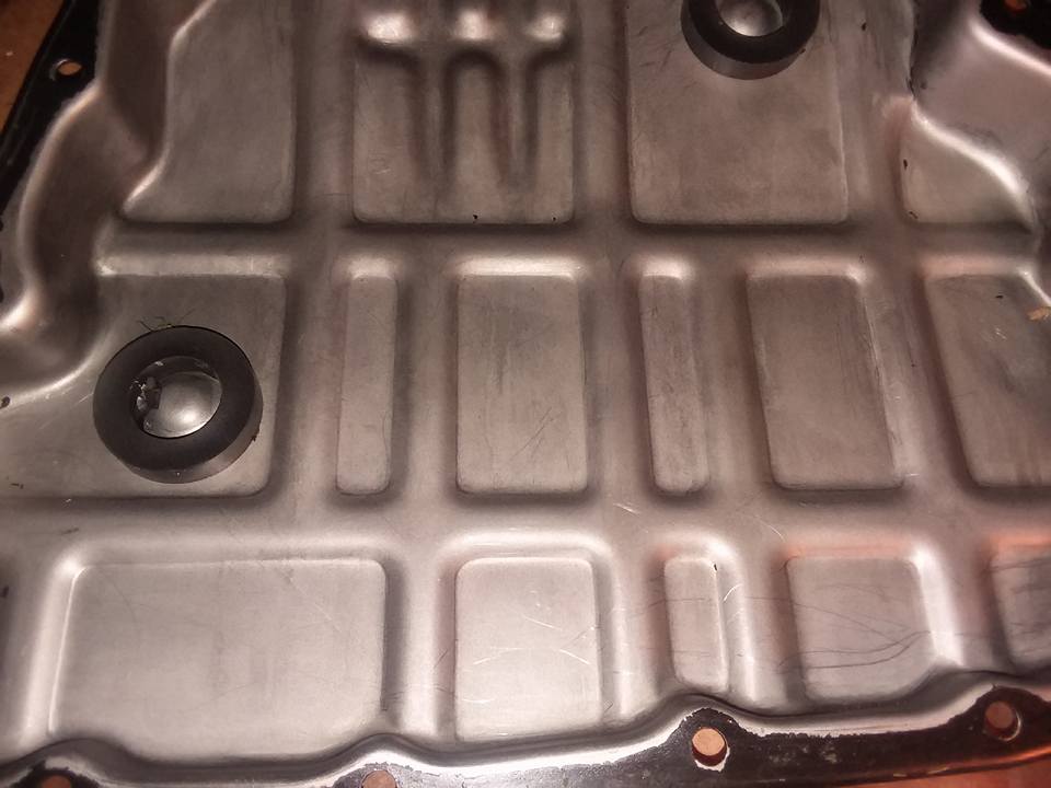

Also i used lock tight for the bolts and there was no metal in the magnets at all i just don't understand why the black paint was their you think that paint messed up the viscosity of the fluid

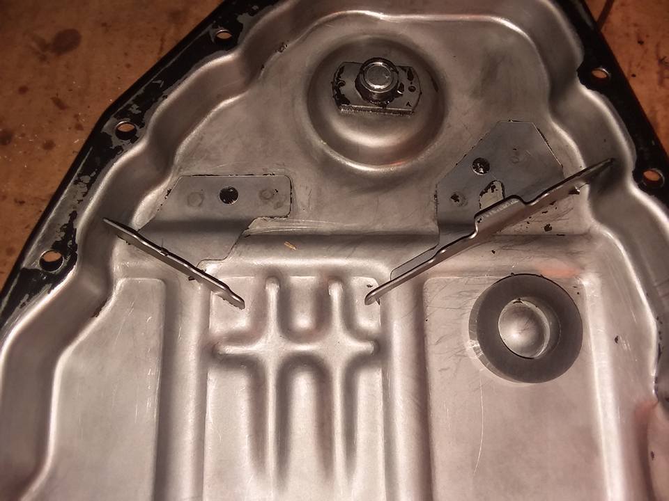

That paint was originally adhered to the inside of the pan. It looks like someone added some kind of solvent or cleaning solution in there...maybe a half assed transmission service? I hope you scraped all of that paint off.
But congrats! Transmission work is always the worst, right next to CV boots.

Hi Yup i used a parts cleaner to get the old out at least their was no metal om the mag thanks and ya its a job to do and not 1 i'd do again at night with all them beatles and moths driving me nuts

A couple years ago I dropped the pan on my mom's 2005 sentra and took gasket cleaner to clean off residue for a new gasket and the overspray or dribbles bubbled up the ecoat paint on the main pan surface. I ended up just stripping it all off with that stuff.
Worked good but that wasn't my plan. I was so afraid it would just keep peeling and would get pieces of paint into the trans and so I saw no other way but to take it all off.
Gasket remover will do all sorts of things!!!! 😢

I drop the transmission pan 3 years ago , tried to replace the transmission filter however the remaining nut that holds the filter is factory sealed meaning if you try to removed it the bolt will break. No need to replace because this is just a fine mesh wire filter nothing inside, just spray it with contact cleaner. I still have the brand new OEM Genuine Nissan Transmission Filter The critical part is a must to clean the solenoid with contact electrical cleaner to remove the sludge. Make sure the tip of each bolt that holds the pan are coated with loctite , to avoid leak. Mine I replaced it with new OEM bolt coated on the tip. I used Amsoil OE Synthetic ATF up to present the ATF is still blood red in color.
