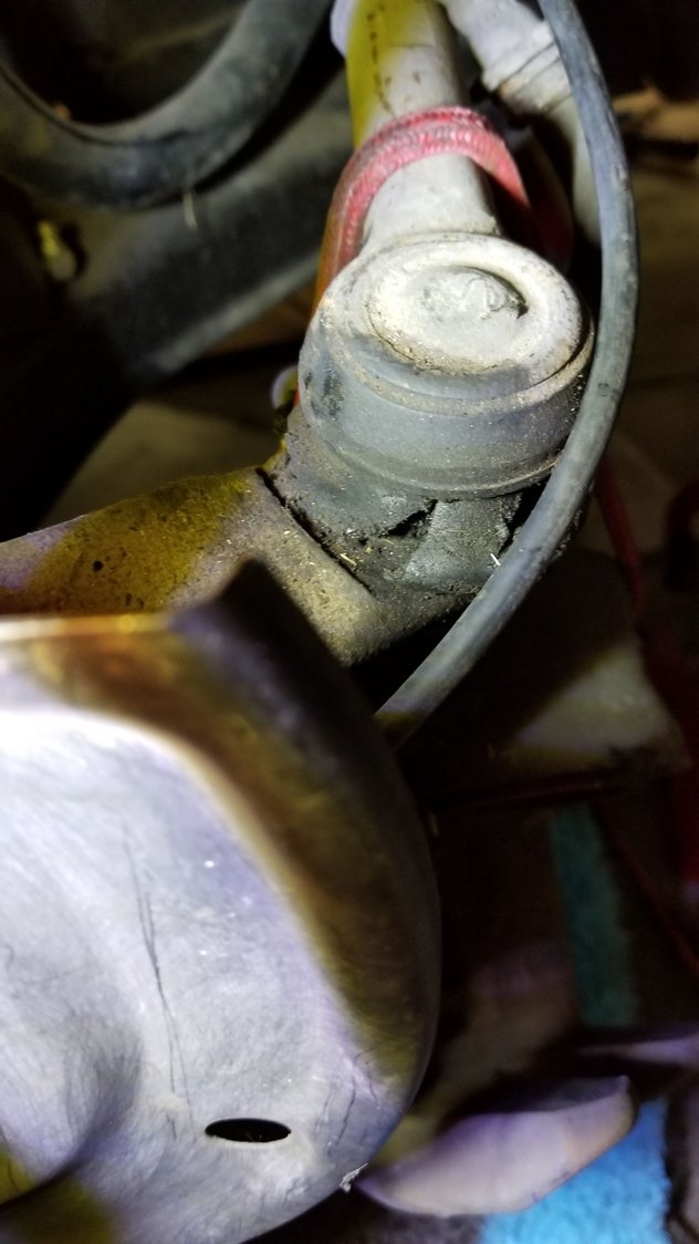

Very very easy. Just be just watch a couple videos on YouTube first like Chris fix or whoever you choose. And count how many turns it takes to get the old one off. I just replaced mine before writing this. Turned out they issue laid within my inner tie rod. If your inner has no tension to hold itself up isit probably shot. I don't recommend that one.. needed special tools and more space and the Nissan fsm wasnt helpful. A billion how to video if you look..
Rusty. Water infiltrated and washed away grease. No boot rip
I just replaced a ton of stuff. Axles, struts, couple motor mounts, end links, sway bar bushings front/rear shocks, I'm going pretty all out. Taken a long time tho. Good luck. And I replaced all hardware with everything I touched too.. Was nice having extra hardware on big project

I took this advice this summer and replaced my control arms after beck arnley bj boots split open just like the pics from the op within 12mos. And 2 yrs in a row. Warranty is cool but not replacing the same part annually.
Will see how these Detroit axle pan out. Oem boots never split in 14yrs. !!!
