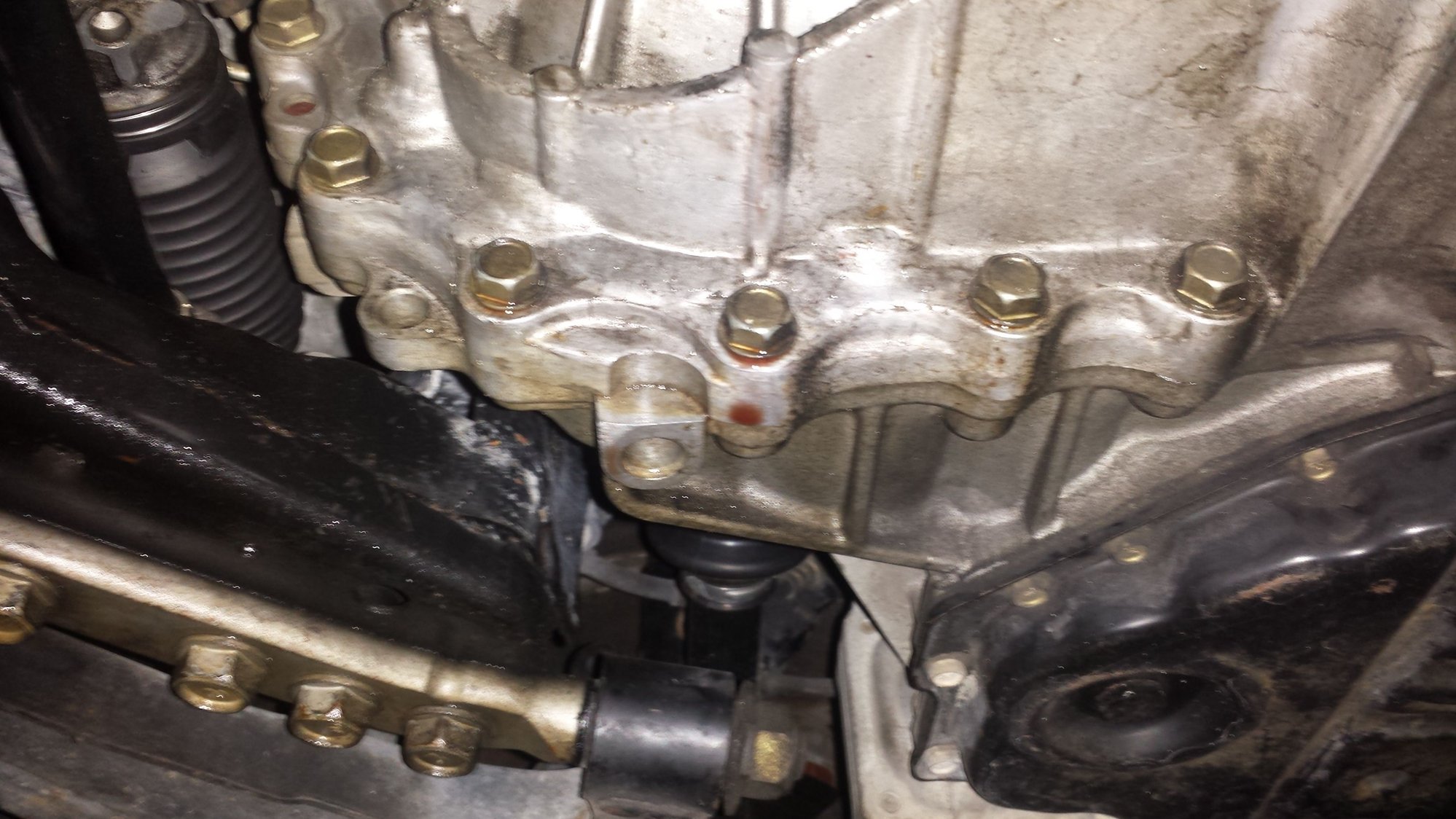

@qw
Well, isn't this lovely!
Yep, that's a brand new OEM passenger axle seal. Not sure WTF is going on here.
Profuse leakage. Did I hammer in the axle seal too far? At least it wasn't my half-moon or RMS as I originally suspected. I've already done those twice. I'd let the damn things leak forever at this point.

WTF??????????????????????????????????????????????? ???????????????????????????????????
Brand new axle seal!!!! How does this happen? The new seal looked the same as the old one. Wrong seal? Incorrectly installed? This is passenger side. Driver side is perfect! I just don't understand. Happened just now. Noticed tranny fluid barely registering on the dipstick. Ran to Walmart, grabbed a gallon, went home, filled it up and as soon as I pulled out of the driveway to run it through the gears I noticed that huge puddle of fluid on the driveway. WHY??????

The driver and passenger seals are different sizes. Other than that, maybe something got nicked when you were installing? I think all you can really do is reinstall another seal and see what happens.
Indeed they are. I made sure to order and install the correct seal for each side. I'm just as perplexed as you guys. This was probably my fault. I think I may have hammered it in too far. I'll have a post mortem report on the seal tomorrow when I replace it.

Welp, not sure how this got past me, but the problem is rather obvious. Old (new OEM as of 1kmi ago) seal on right, new seal on left.
Here is where I have an issue: I still have the bag in which old seal came from Nissan a month ago. On this bag is the same part number that is on the bag in the photo that I picked up today. Shame on me for assuming the part would be correct and not test-fitting it before I installed it when the tranny was on the floor a month ago. Now, I'm not 100% certain at this point this is what happened, but I can only presume, based on the fact that everything else with this project is 100%, 5 by 5, good to go, by the book, solid work, and then a stupid 9 dollar seal was mis-installed? Really? So, can't really blame Nissan, but I SWEAR TO GOD I installed the seal that came out of the bag with the correct part number the first time!!!!
So, what does this mean? I have not had a sealed tranny for the last 1200mi. Shifts were fine up until about a week ago then the 1-2 shift gradually turned into a slingshot. I kept an eye on fluid and topped it off first 3 weeks as I knew I had a drip. The last two weeks I probably wasn't as diligent at keeping an eye on fluid as I really had no reason to unless it became symptomatic, which it did, and hence here we are today. Have I cooked my tranny?
The saddest part is, I ruined this new seal trying to get it in today and Nissan won't have another one in til Saturday. FML. Getting it installed while tranny is in the car is going to need a different approach. Anyone have a favorite tool? I'm thinking a socket the same diameter as the OD of the seal pounded in through the carrier bearing from the wheel well. I used a 1x2 furring strip today and positioned it from underneath while a friend pounded on it from the outside. That didn't work so well lol.

Welp, don't believe me when I swear, I guess. Double checked my parts bin and found the first seal that I bought that was supposed to go in the first time. 100% my fault! Not sure how I screwed this up, but there ya go. I had two driver side axle seals installed! Replaced it this evening after I woke up and all went together well.
The tool. That's a two and a half foot or so piece of schedule 40 1.5" with a coupling on one end and a cap on the other. Coupling was the perfect diameter for the seal. Hammered it in myself through the carrier bearing bracket. I did remove the strut for ease of access. Pipe remained intact and did not shatter into a million pieces.
