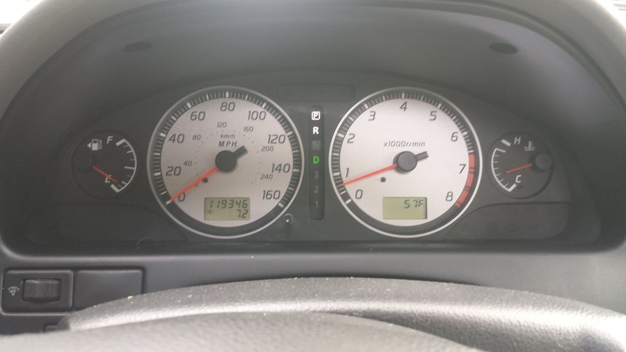

No lights! Today, 1/30, after working out some bugs.

200 miles on the swap. Not a single issue. Car has power! With nothing to compare it to, I must say, this thing gets it! Great torque, great top end. Car idles as smooth as glass even with the MT mounts. Car runs just as smoothly throughout the rpm range. Funny you should mention turbo, krismax, as since I replaced the guts of the driver door yesterday and got it all cleaned out (broken glass for days inside it), interior panel replaced, mirror attached, and now I have full functionality of all windows and locks, I have noticed a very distinct, turbo-like whine coming from my engine and the only thing I can attribute it to is my big *** alternator! It's much fainter than a turbo, but the same frequency and quite perceptible. I think it's kinda cool! Adds to the sleeper persona. Well I just filled the tank with 93 for the first time this morning and took it to the car wash today for the first time ever I think lol. I'm extremely happy with this thing. I haven't had so much as a hiccup. No leaks, no codes, no funny sounds or vibrations, it just runs perfectly! It's so much fun to drive! Funny how things come around, this was my dream car in 2003 when I was just 20 years old, I just always seemed to end up with something else in the meantime! Glad I jumped on this deal. It really is a clean car. I am fortunate that it has no rust to be found anywhere, and that everything works! No funky gremlins so far. Looking forward to putting many trouble free miles on it.
I did a couple of WOT runs to 80 today before I ran out of road. Barely made it into 3rd before I had to shut it down. Notable tranny fluid odor and a bit of what I presume to be tranny fluid smoke burn-off while waiting at the light after pedal-to-floor action. I've noticed the smell since but it gets fainter as time goes on. I have the tranny fluid volume dialed in and it shifts beautifully. As I have no previous experience with the Jatco 4 speeds I'm not sure if it is behaving naturally, but based on my past car experience and intuition I think it behaves quite well. I did have one question regarding gear changes from 1st to 2nd during WOT; My tranny redlines through first, then rather than a swift impulse into 2nd, it eases into it and without losing a beat, almost seamlessly transitions into 2nd and the power starts to build all over again! It's crazy! Is this normal operation, or should there be a kick into 2nd? I like the way it is shifting, I'm just curious what normal operation is, or if this is indeed normal?
