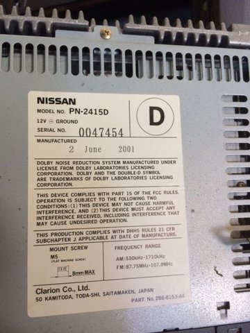

Hi All,
I have a 2001 Maxima SE with 200,XXX miles. The past two weeks after it rains the radio volume is very low. I have to turn the volume all the way up to hear any sound. A day later the volume level returns to normal. Then it rains and the process repeats itself. I am assuming water is getting in somewhere and shorting out the amplifier, but I am not sure where. Under the hood and inside the car are dry. I read a couple of threads on head units for 5th generations but there was no mentions of an issue like mine. After reading these threads I do not believe I have a Bose head unit as it does not say Bose as one of the threads indicated it would--I will post a picture of mine. Does this head unit have a built in amplifier? Is there somewhere I should check for a water leak that I am missing--perhaps a clogged drain from a sunroof?

Here is a picture of the head unit in my car.

That don't look like a bose. You would also have a subwoofer in the rear parcel shelf if you had bose. The non-bose has an internal amplifier. The bose system has the amp mounted on the underside of the rear parcel shelf. Try pulling the head unit out, or the trim, right after it rains to see if it's getting wet.
