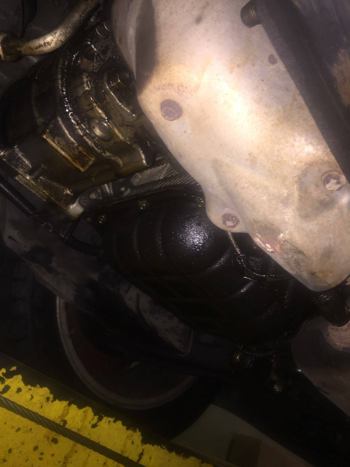

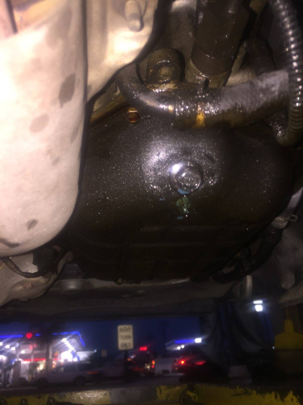

The oil has been leaking for quite some time. I have already put well over 2k$ into this car which is why I have been holding onto it aside from the reliability factors compared with my last cars.
The oil leak is very small and never requires more than half a qt of oil to be added in between oil changes, Though my parking spot is looking terrible from the accumulated oil.
The problem is I can't tell exactly where its leaking from. I initially thought it was only the valve covers, but included pictures from underneath where its an alarming amount of oil accumulated.
I am not very familiar with these cars, and looking for advice. Can just the valve covers cause this much oil to accumulate in the area? If not what could be leaking along with the valve covers?
I have also included a pic of my transmission, which looks minor, is it something I should be concerned about as well? Or is this normal on these cars?. Thanks
Oil pan Area
Oil pan from the front.
Transmission

in short.
start with ez things.
for example pressure wash everything and check every day for leaks maybe you'll catch exactly where it's coming from
take the plugs out. if the tubes are oily then do the covers. check that off.
do the front main seal. just take the pulley off that's on ez one.
do the lower pan gasket usually the stock sealant is hard as a rock.
then do the upper if still leaky.
mine was just as dirty and i did all seals except for the rear mean which wasn't leaking but every other seal was.
hows he power steering line? usually those are trashed by that milage.

Originally Posted by Donkeypunch
in short.
Thanks, I would have to take it to the shop to have it pressure washed.. Unless I Can use a car wash? I should be extra careful to not have water get into my alternator right? I had the tubes checked when I had the coils changed, and I'm for sure its leaking from the front and back.
If I did all of this work myself it would have end up costing about 50$ My biggest concern is that intake plenum over the back of the VQ35, I know it easy to some people, just a first for me.
The power steering line is ok as far as I know, since I have not had any steering issues aside from when I'm turning at a slow speed to park I hear strange rubbing noises from the front end that sound like run on flatulence, It has done that for a long time as well, that wouldn't have anything to do with the power steering line would it?

Valve cover gaskets (rear leaks a lot, b/c it's cooked more, WILL eventually start a fire if you have cats), oil cooler seal and obviously RMS.
Replace VC gaskets and RTV the tube seals (or drill out tube seals and replace, not worth buying new VCs). Oil cooler seal is a few bucks and a bottle of AT-205 for RMS.
Yea that makes since for the rear valve cover to leak the most, Im hoping most of the oil that is accumulated in the driveway is from the oil cooler seal since that is the easiest fix. My transmission fluid has been at the same level since I have owned the car, but I guess it wouldn't hurt to throw in a bottle of AT-205, wished it was something made like that for the valve covers. But I will do the front first, that's after I fix the oil cooler seal. Thanks for your input
