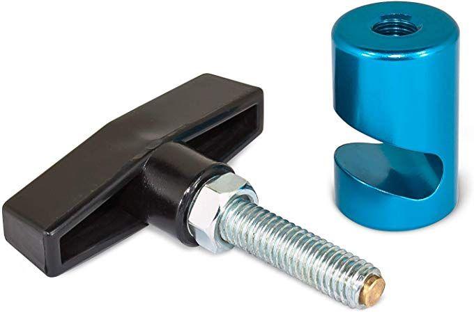

Great idea. I also saw these lift support clamps while googling around. For $12 a permanent fix.
