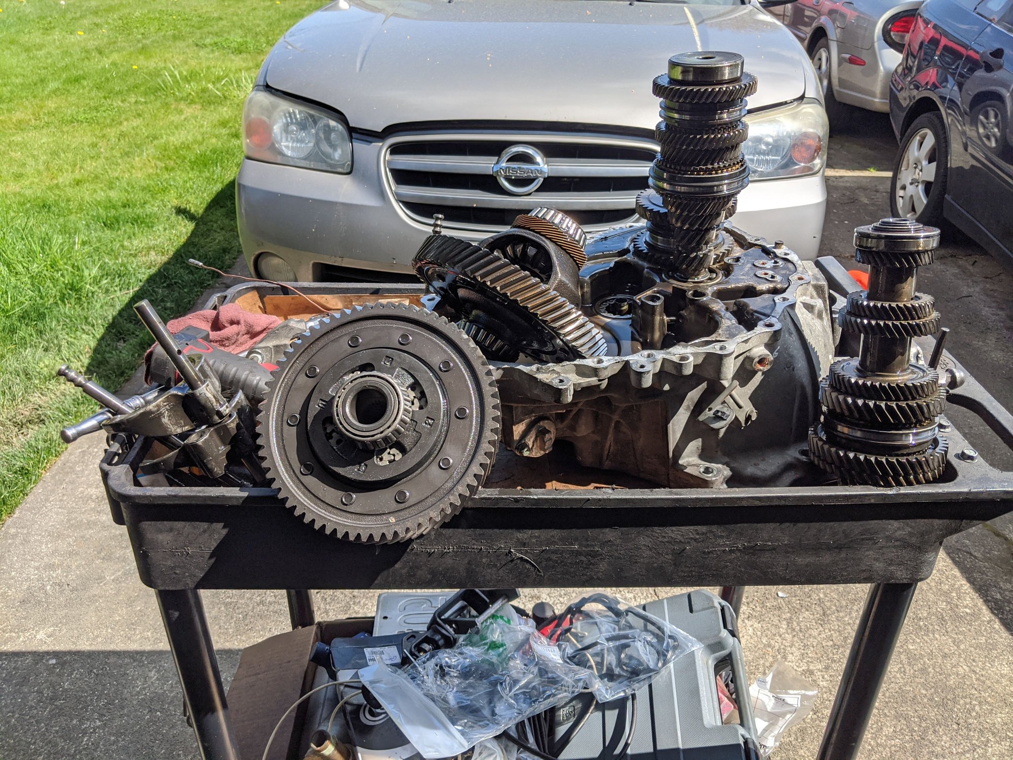

Pulled the engine Saturday afternoon. 15 hours later I hit the key and it fires right up. Also swapped in an hlsd out of a Sentra ser. Shifts much better with the redline in there vs whatever junk came out.
Initial test drive says it's lean. Feels like it's pulling timing above 3k. Need to get the wideband in.
​​​​On the plus side it probably won't go thru 1.5qts of oil per tank.
09 Maxima engine. Used the 09 lower oil pan, oil pickup, and windage tray. 02 upper oil pan. Should have about 1qt more oil capacity. I'll need to check it with the 09 dipstick. With the 02 stick 5qts puts it right at the low mark. Had to do slight percussive persuading on the tray to clear the 02 upper. Didn't take much.

Originally Posted by User1
Pics or it didn't happen. Don't be like Slamrod.
Not much to show. I didn't document much as there's already a ton of info out there.
Empty bay
Sentra spec v trans donating hlsd to the cause
Maxima trans teardown
Maxima trans back together with hlsd
