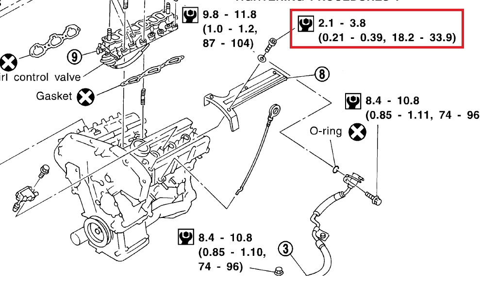

Hi guys,
I am missing the screws that secure the small engine cover (over the front 3 ignition coils). Where can I buy a replacement screws?
Thanks in advance and Happy Easter!
Old Apr 12, 2020 | 09:30 AM
issa3032's Avatar
Joined: Jun 2002
Posts: 32
These are the screws I'm talking about

I dont think youll find anyone here who still has that damn thing attached. Youd think that would mean all those people would have spare hardware for you, but i doubt thats the case either lol.
Try googling “nissan parts zone” (they rebranded and i dont remember their new website name), they tend to have random parts like that. Or just go to the hardware store and see what fits, its just a bolt.

But yes, any Nissan dealer can get them if they're not discontinued. Otherwise a trip to pick n pull and a little luck.

M5x0.80 10-12mm in length.

I would look in the boneyard or check out your local hardware store's hardware section...The usually carry alot of specialized SS or Black oxide metric hardware.
