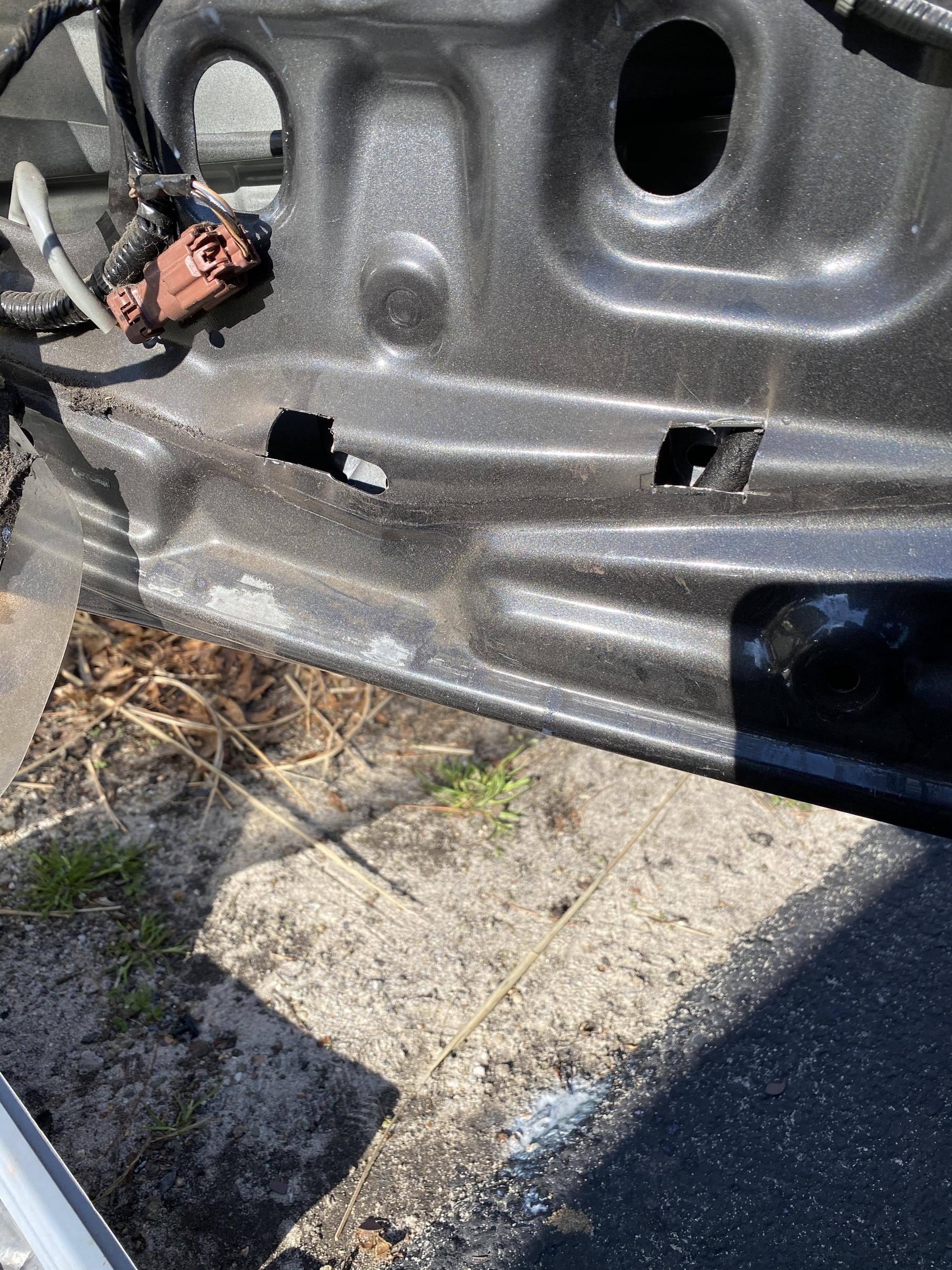

Trying to replace the window motor on the front left of the car. Motor died with the window completely down (tested and confirmed the motor is dead). I am unable to reach the two bolts that connect the window to the bracket - the window needs to be raised a couple of inches for the bolts to line up with the access holes. Im not able to raise the window up. Tried spraying some grease, wiggling it a million ways, having someone hold the button, nothing works. Every tutorial assumes that the window is already in the proper position or can freely move, i cant find any answers on how to proceed in my situation since the window wont move at all. I pulled the speaker so i can get both my hands under it, the entire car is flexing from me pulling up on it before the damn window will budge.
Anyone encounter this scenario and know how to get the window up enough? It seems that the dead motor is preventing me from moving the window, but i cant remove the motor without removing the regulator... which cant be done because i need to move the window to access the bolts that hold it on. Its a circular problem and im stuck right in the middle of it.

If by “hulk smash” you mean “take my dremel and cut my own holes into the door for it being a stubborn little b*tch” then yes, that is what I ended up doing.
At least itll be covered by the door panel lol.

Unfortunately, not true for our cars. The brackets on the regulator rail are not able to clear the inside of the door. So let this be a cautionary tale for anyone who sees their window getting slower and slower - replace your motor before it dies completely in a position that requires you to cut into your door to fix it.
