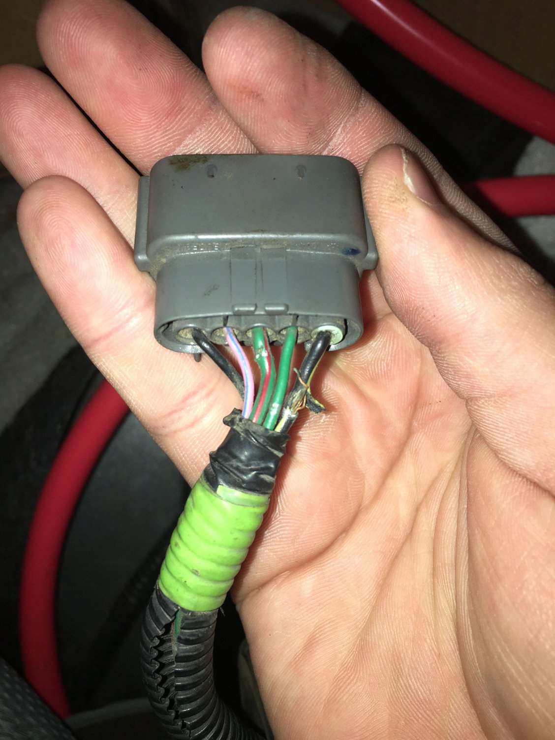

I need to identify the positive and ground , I can’t find a color code any where and don’t want to strip every wire so I’m waiting for some back probes in the mail , I can try and hot wire it if the third and last wire are confirmed pos and neg

Looks like the wire on the right has a problem.
That might be related to your issue.
