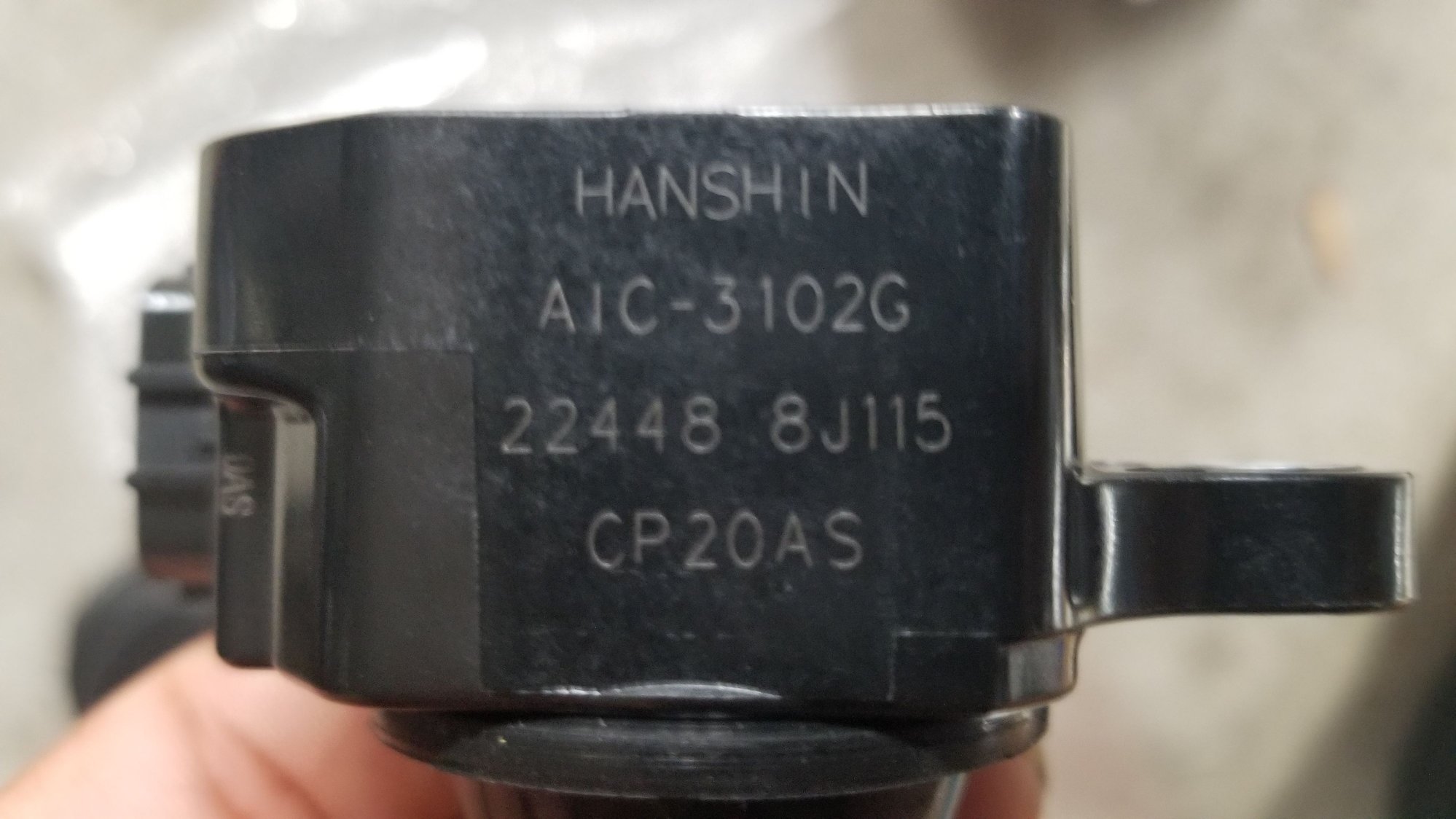

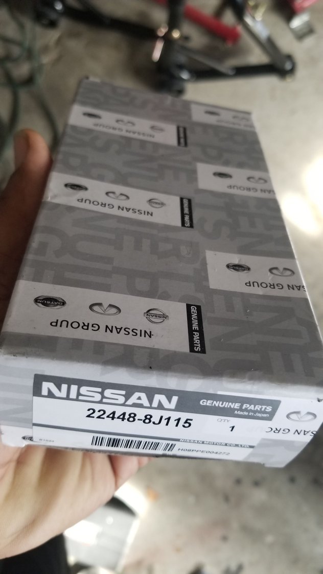

some of the eBay sellers are actually selling coils that come in Nissan/Infiniti/Datsun boxes. I picked up a set of six and the brand on the coil is Hanshin with 3 different part numbers AIC-31028, 22448-8J115, and CP20AS. I think I paid around $20 each, only time will tell how long they will last.

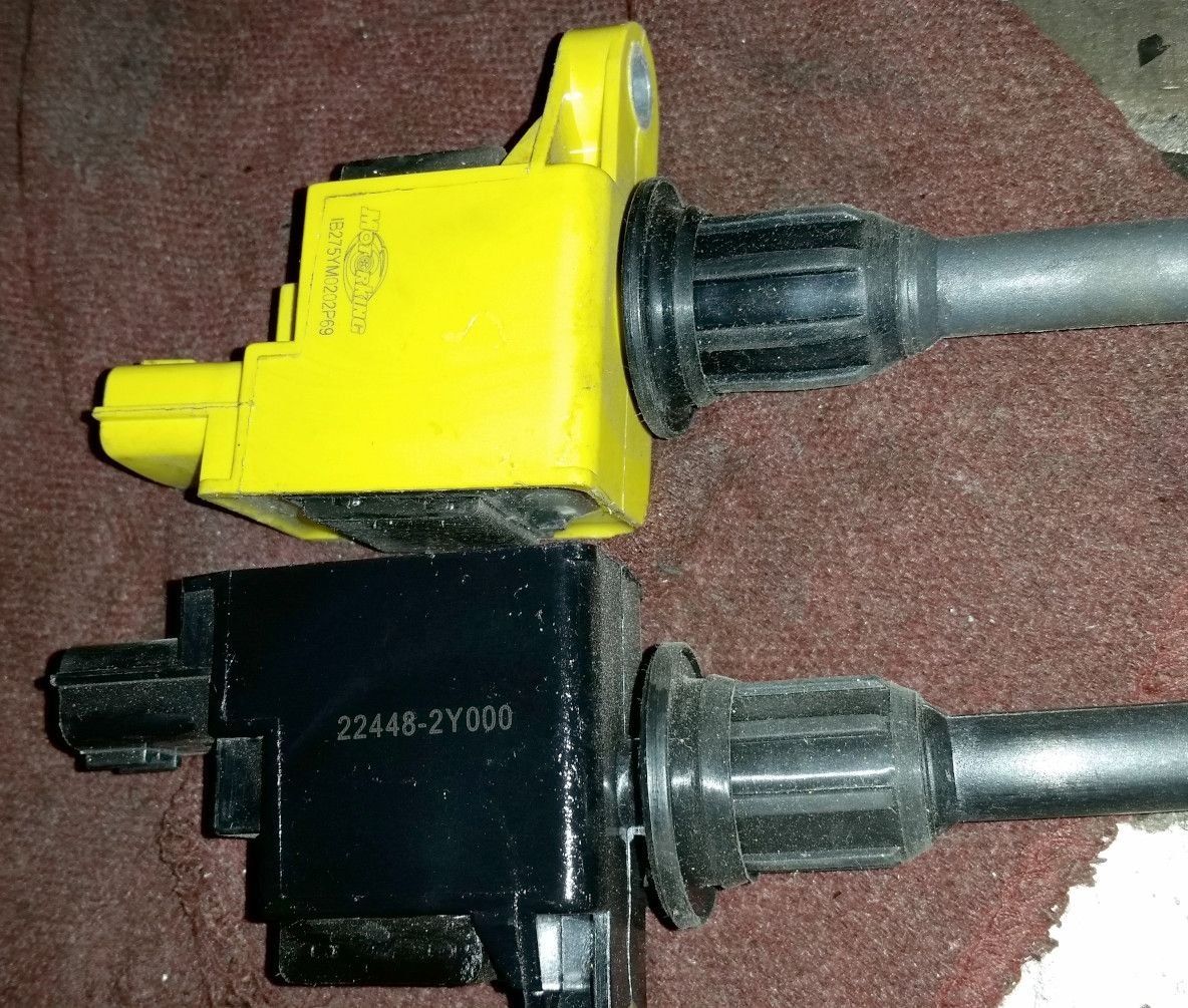

How are the aftermarket coils different from the OEM Hitachi coils for the 2001 VQ30DE?
I believe the two sets I ordered have a higher resistance on the inputs than the stock coils. I forget the code they throw when installed. It's been a few years since I tried them.
