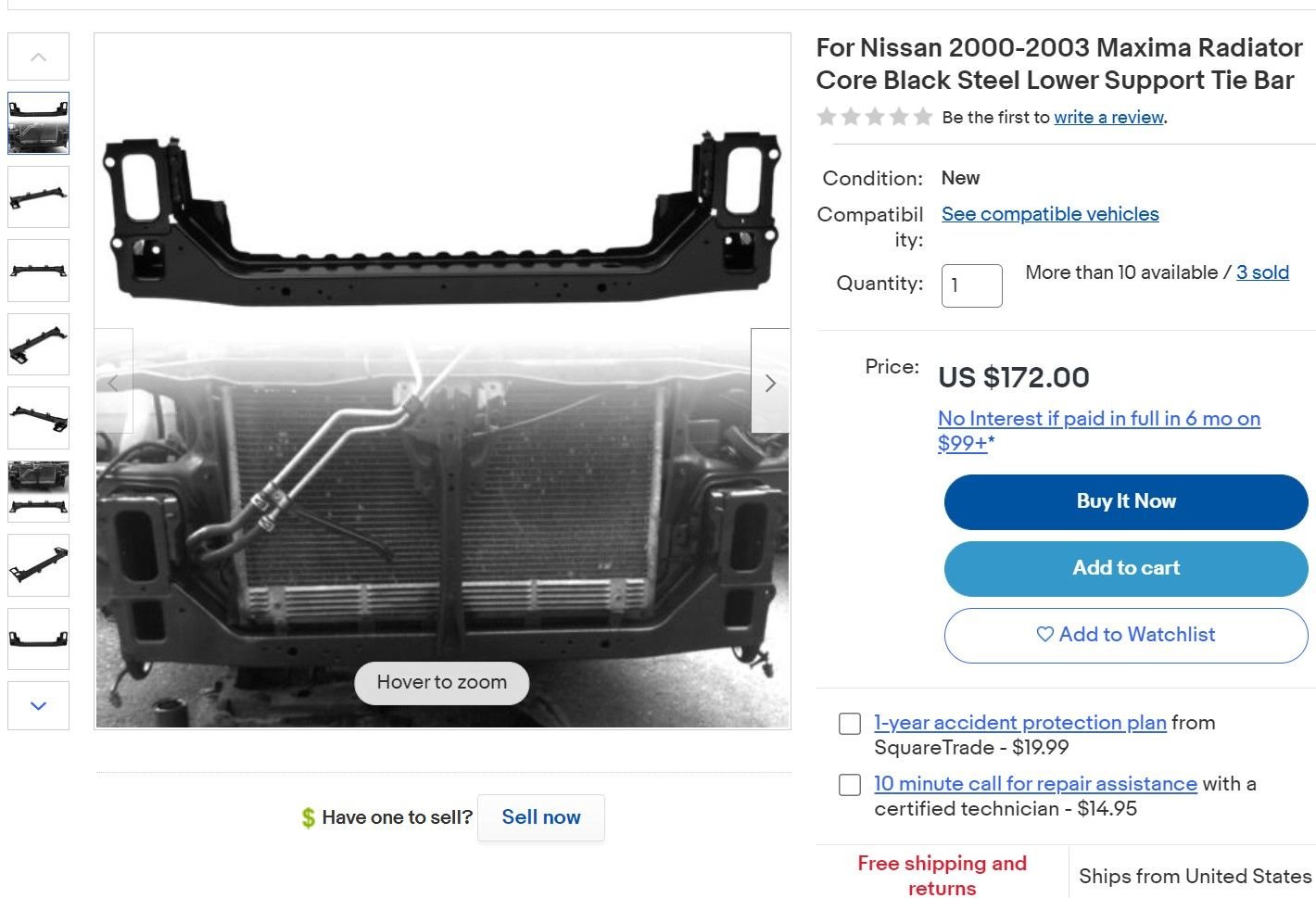

they sell the lower radiator support , they bolt right on. a bit of labor but nothing crazy.
or you can probably get upper brackets and bushings and rig them up for lowers with nuts and bolts.
https://redirect.viglink.com/?format...3ABFBMjpyNs_1f

Don't get an aftermarket lower rad support. Plenty here have ripped them open.

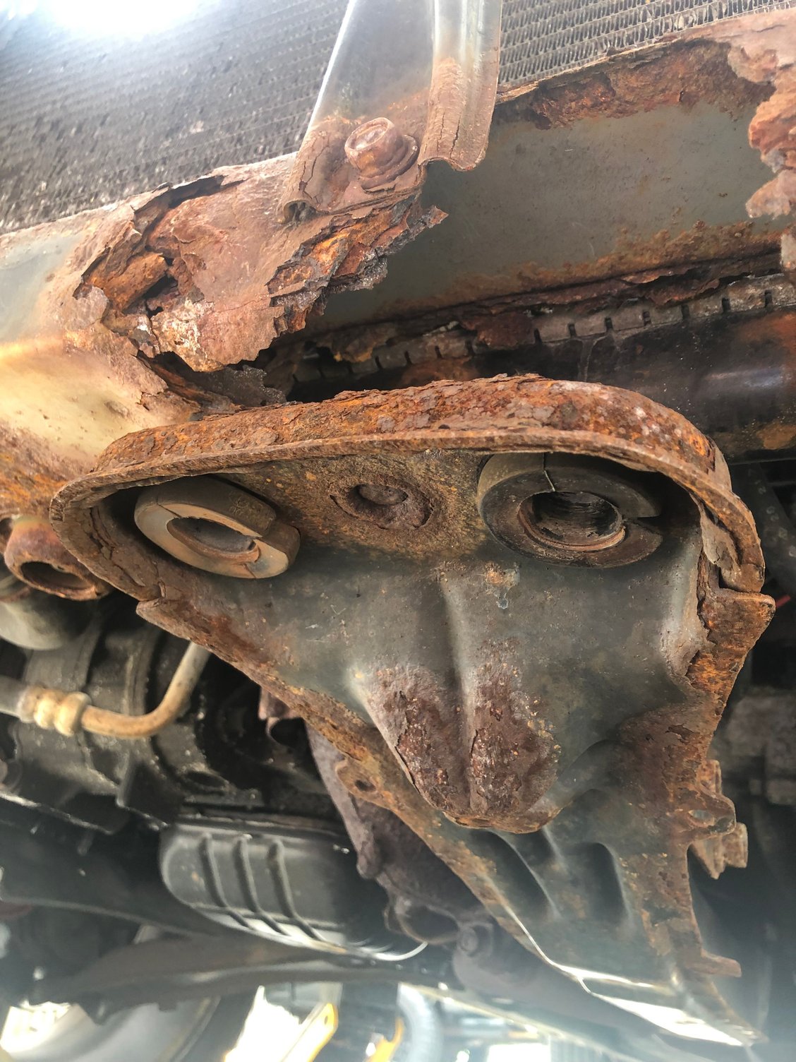

I've read about aftermarket lower rad support not lasting long so I won't get one. I'll pay extra and get it from Nissan. Here's a pic of the lower rad support on my car, I couldn't get a good angle but it shows the rust.

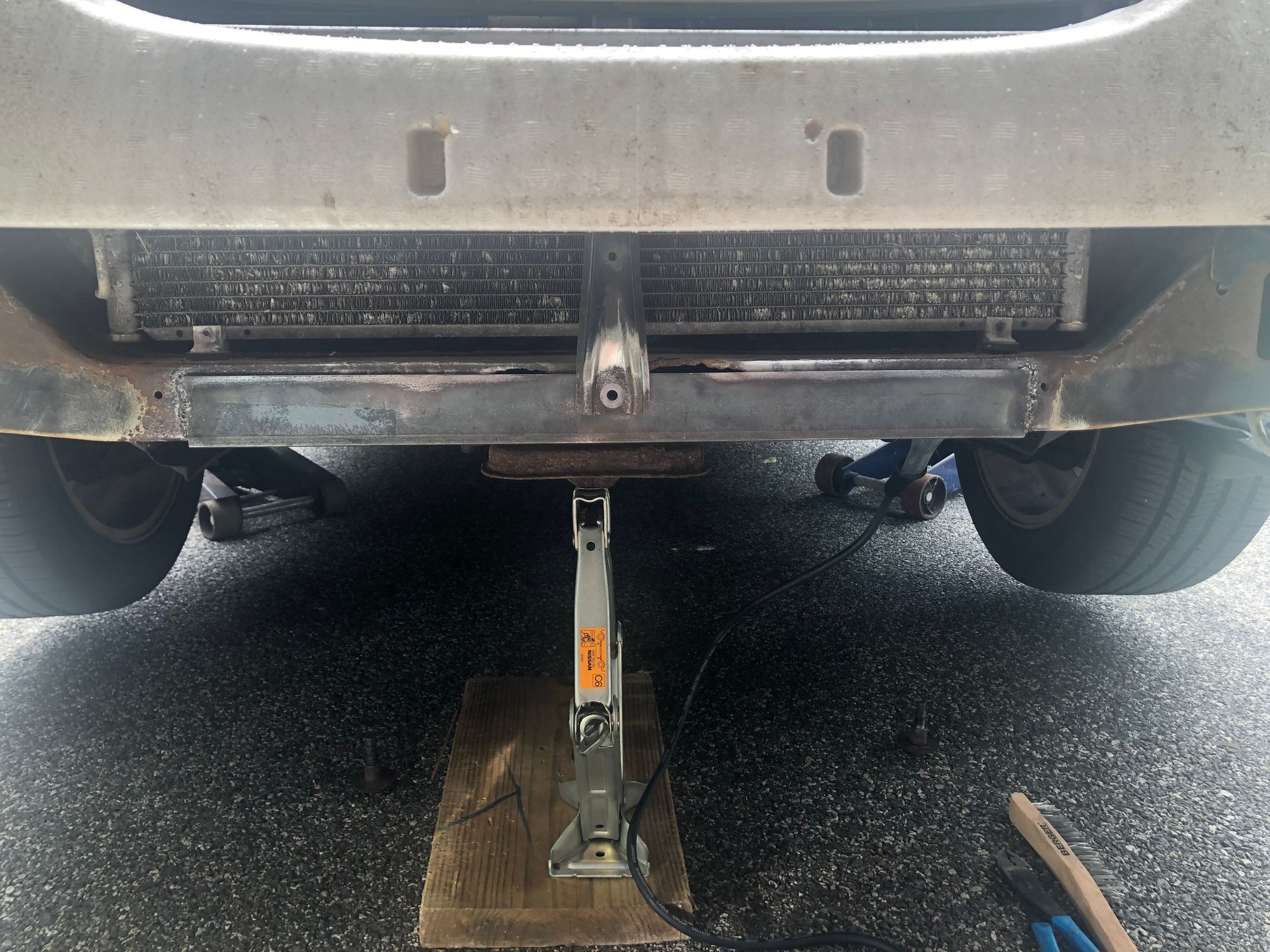

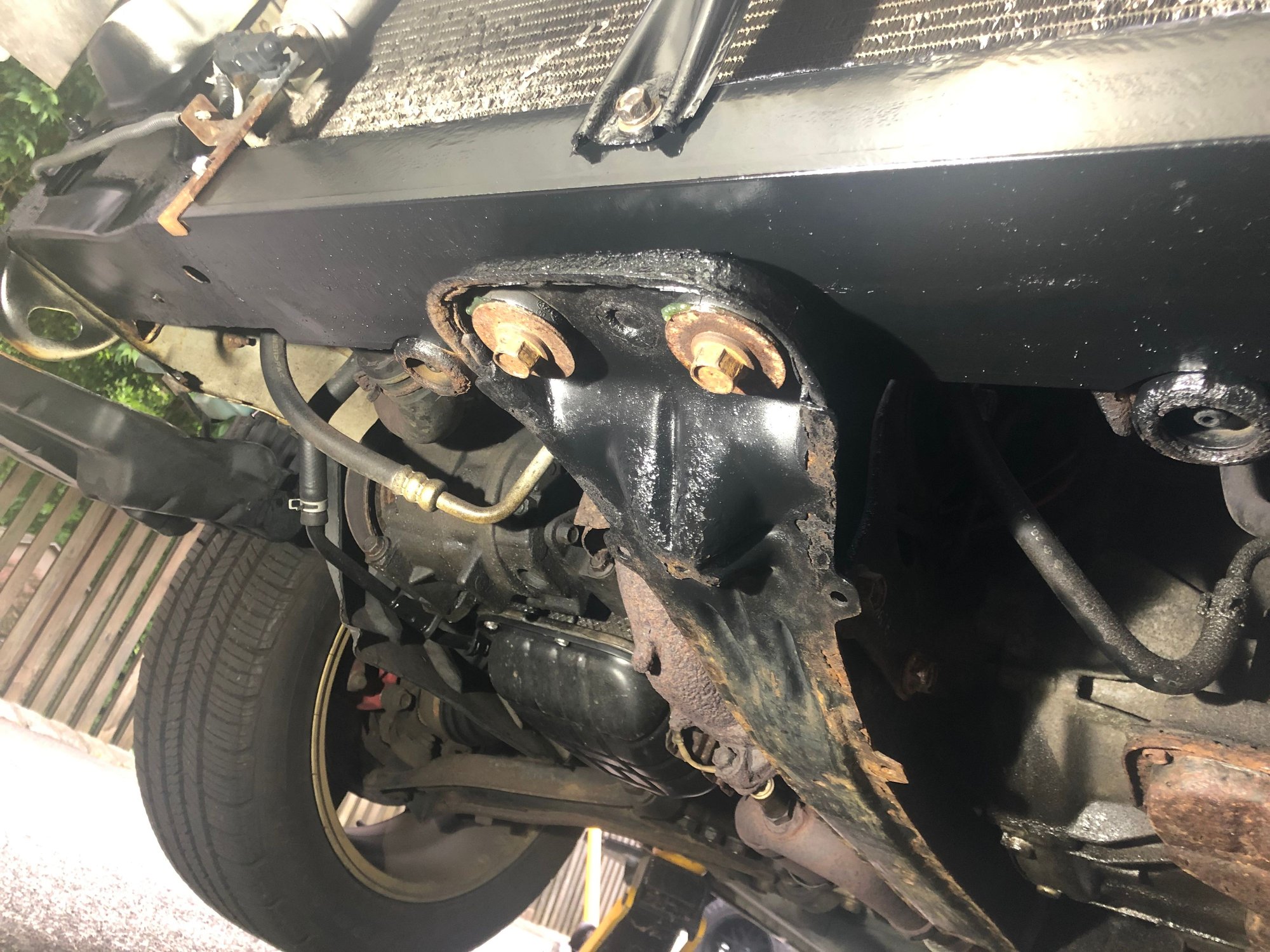

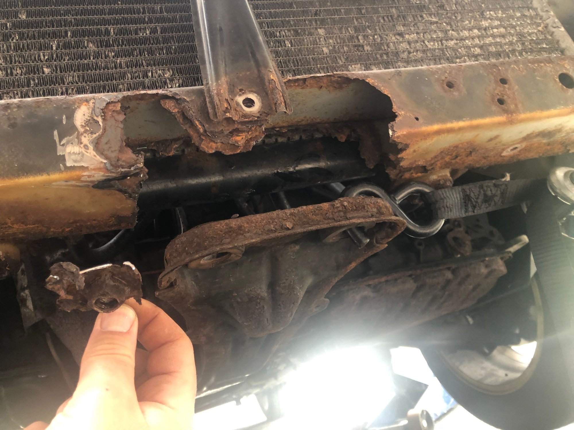

I actually ended up fixing mine this past week. I let it get a little too far out of hand , and decided it was time. I ended up fixing it for about $25 and a couple hours of work.
Old Jun 2, 2022 | 07:25 AM
Prophecy99's Avatar
Posts: 6,101
From: SE PA
not bad man, pretty much just patched it up welding in some new pieces.
Old Jun 2, 2022 | 08:14 AM
timelessr1's Avatar
Joined: Feb 2011
Posts: 19
From: New Jersey
yea exactly! Figured it would give me another couple years, which at that point I’ll decide if it’s worth replacing the whole support with a factory piece.
