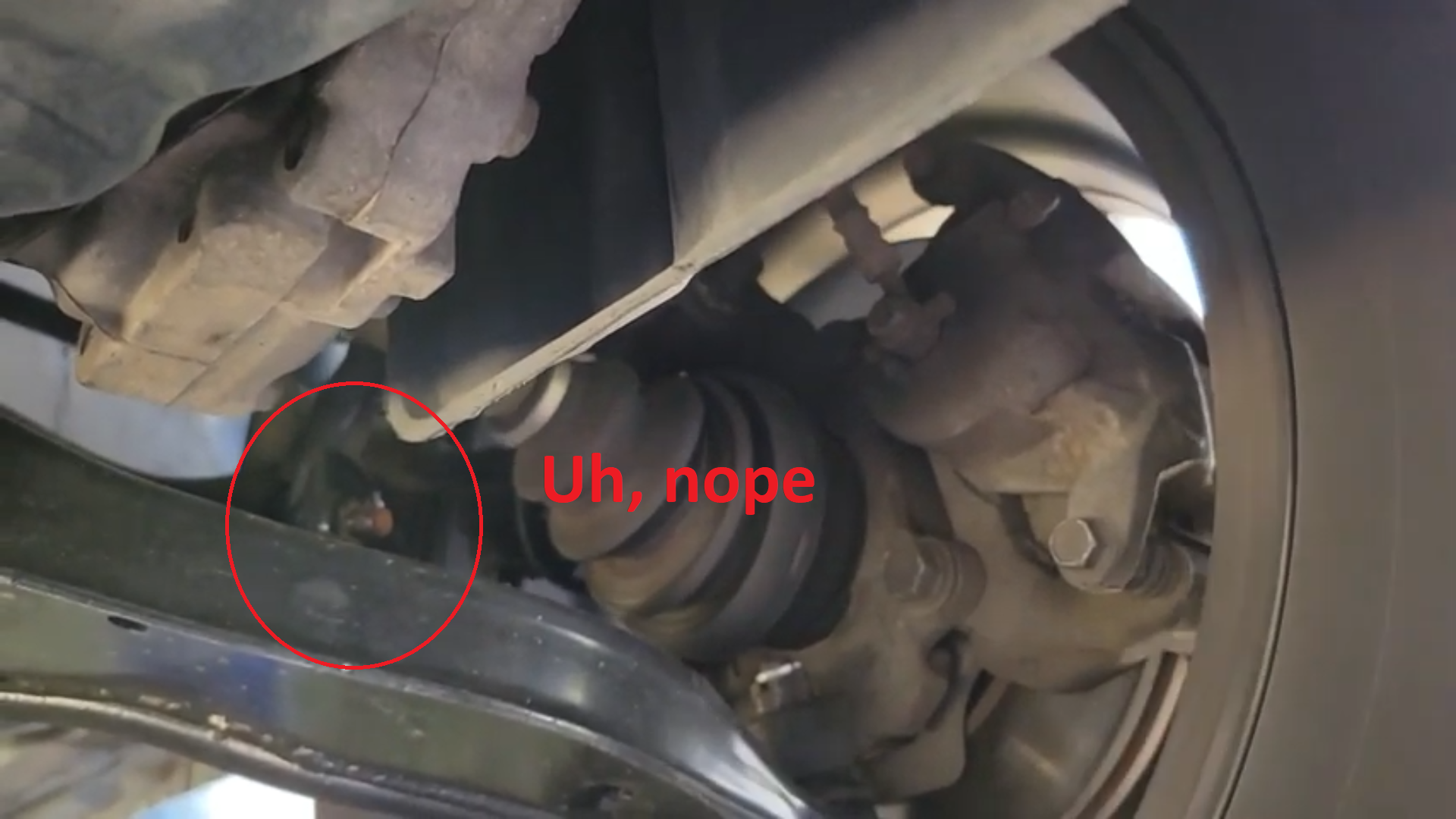

And don't forget to put a nut on that sway bar link.

Nope, you missed one

Make sure you have all your nuts and bolts, and come back.
Not trying to be a D*ick, but nuts and bolts are important.
We've all ****ed up bro, it ain't no thang! We'll git you figured out

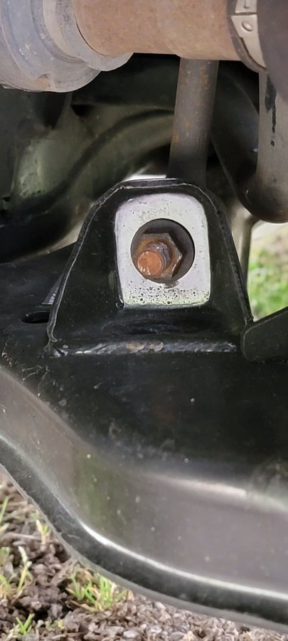

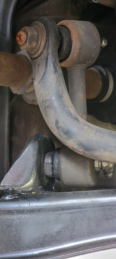

This is the top and bottom of the sway bar link. Took these just for you.

That's different than my pic, but good. Didn't have anything to do with your issue anyway, was just making a point.
