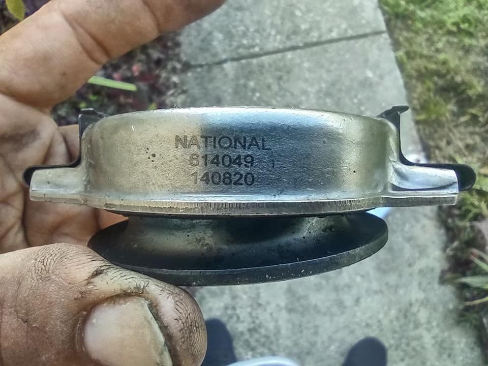

got the tranny out, here's what the throw out bearing carnage looks like. it's a National brand T.O.B.. I knocked out the rotating head and there is pretty much no plastic or grease left in this thing.

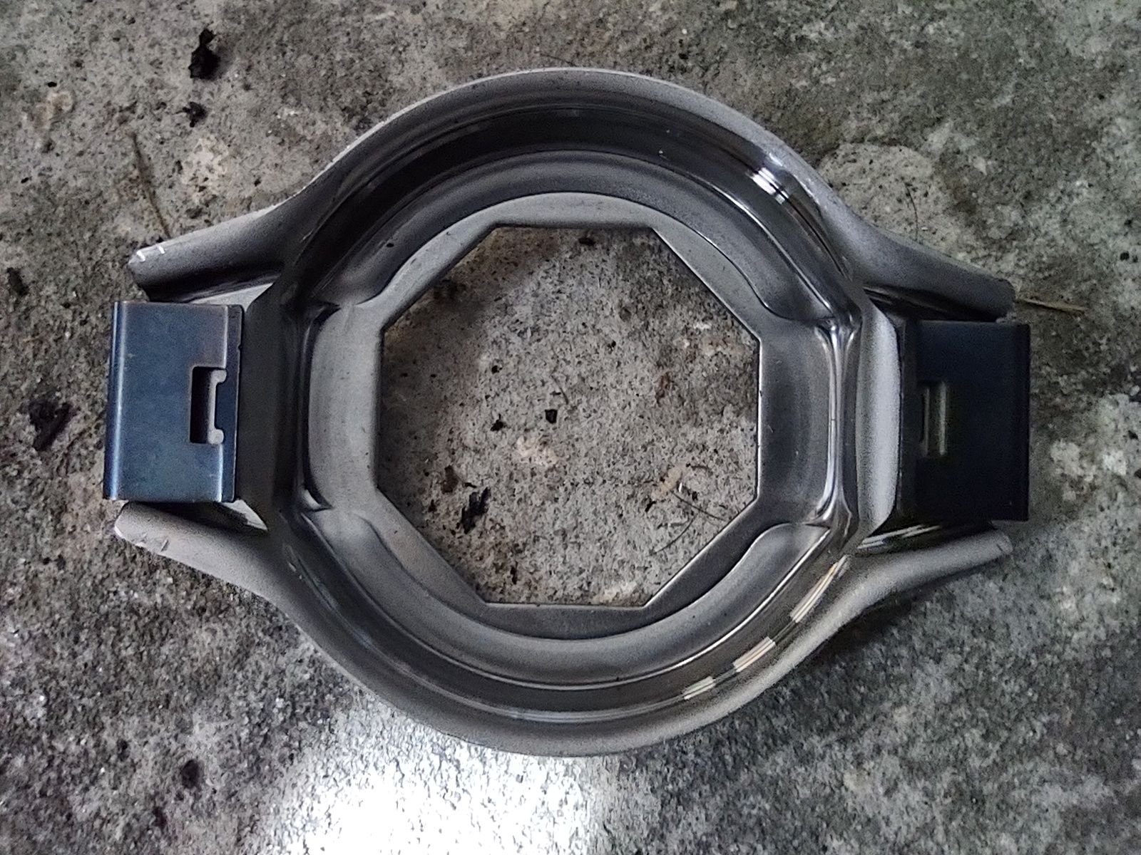

I got curious and took apart the SKF T.O.B. I had in my parts box for when I do the 7th gen swap. the SKF appears to have a sealed being, I put the pics of it at the bottom... still has the plastic backing though
SKF
