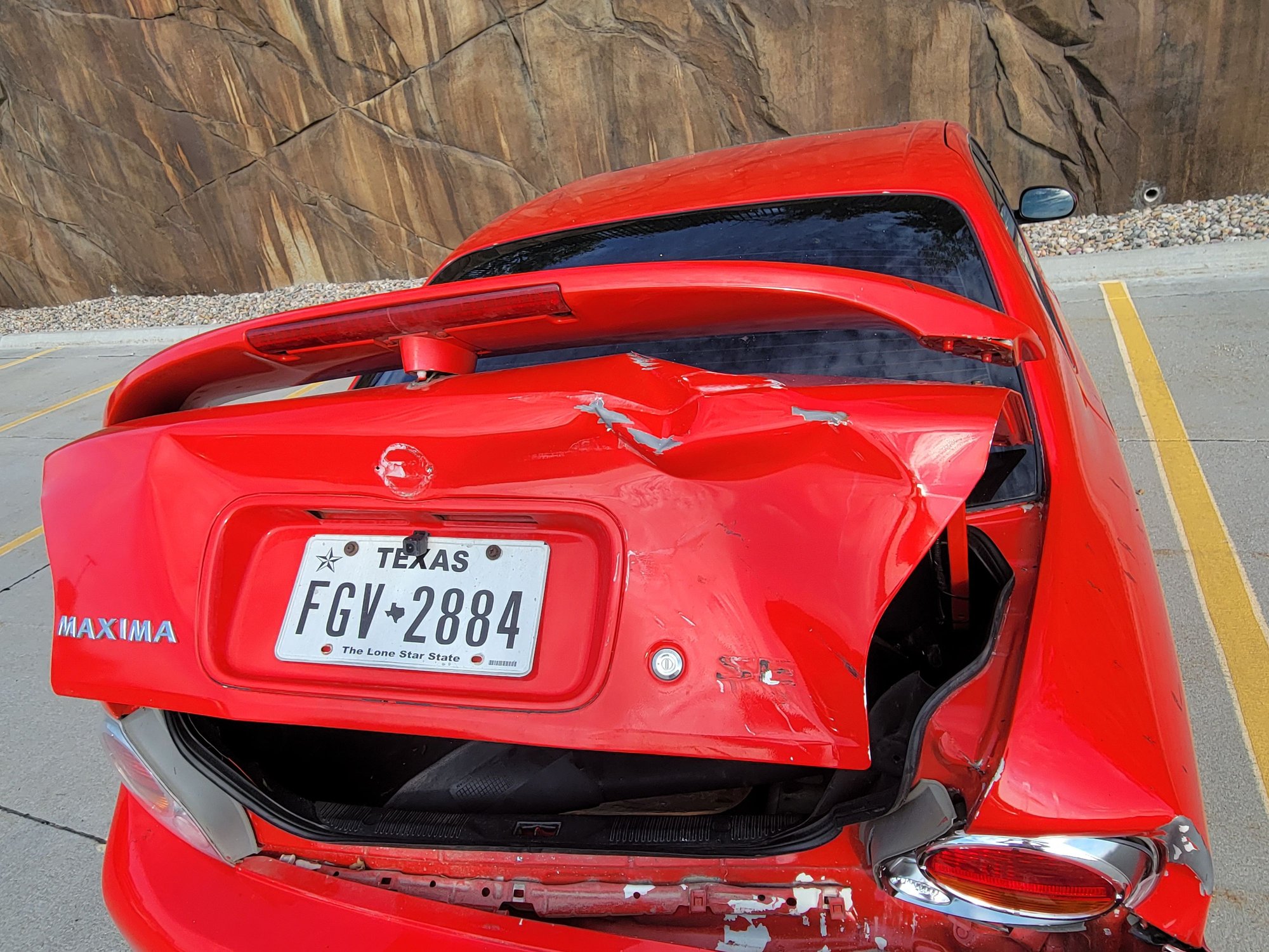

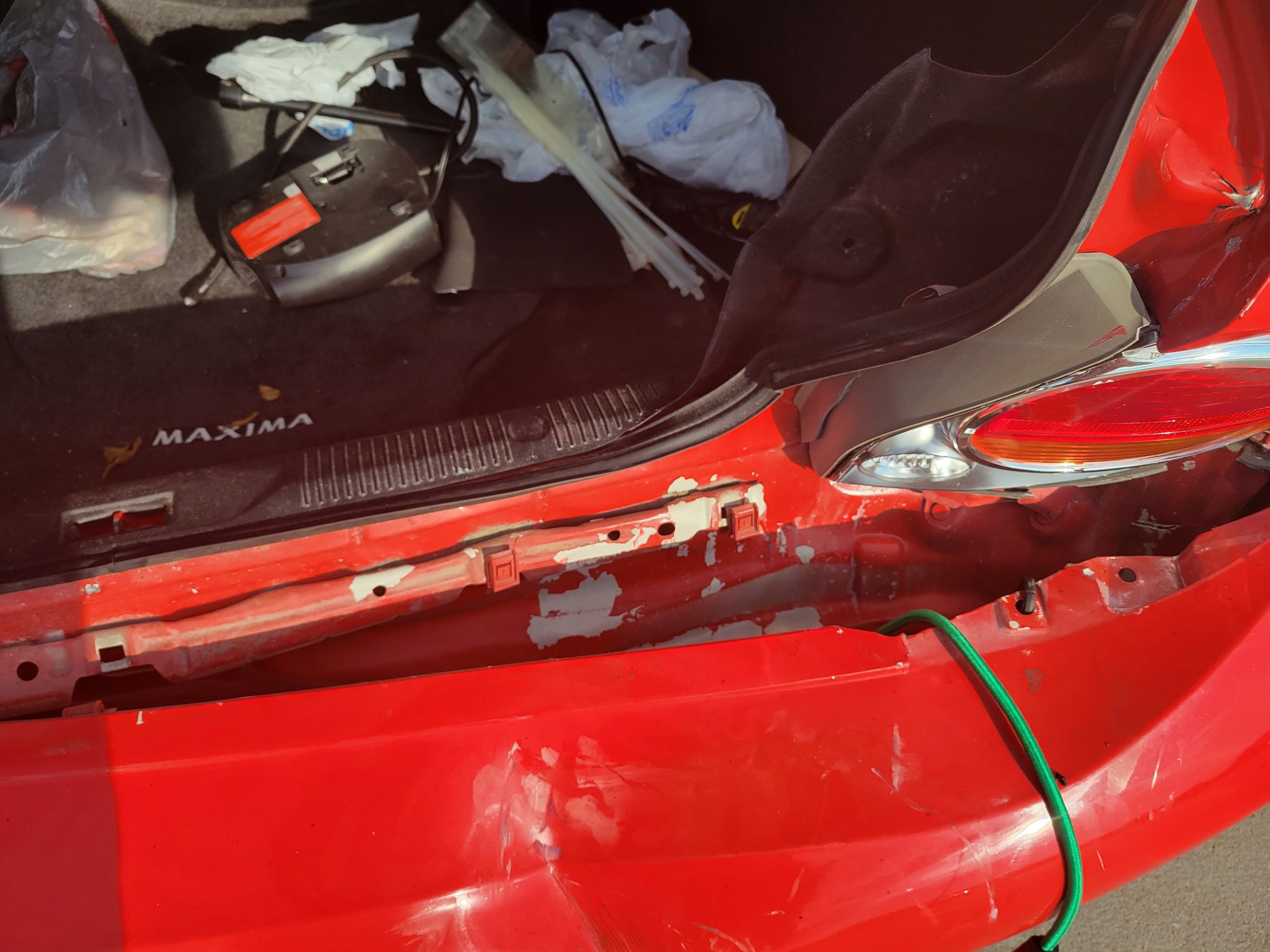

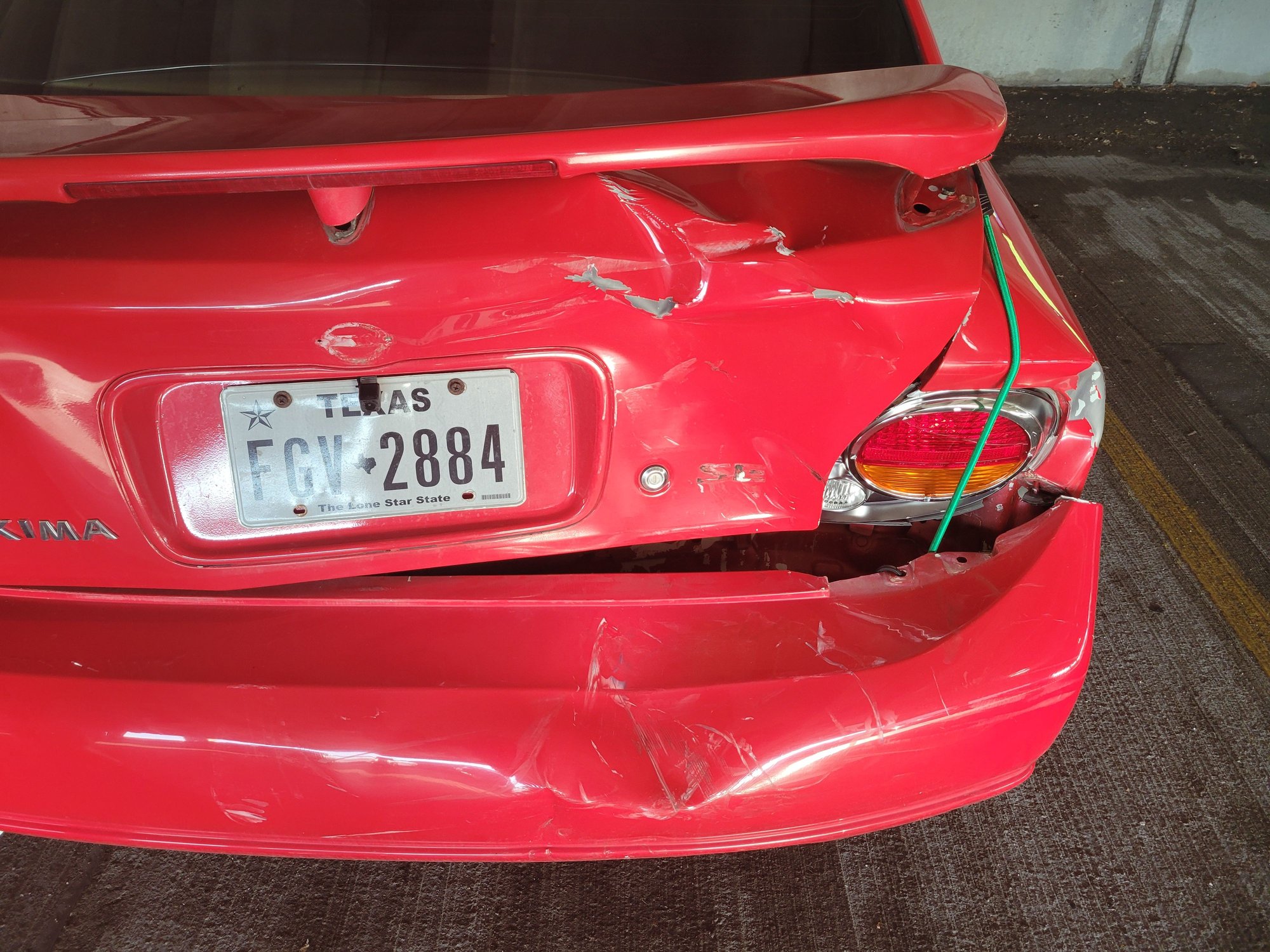

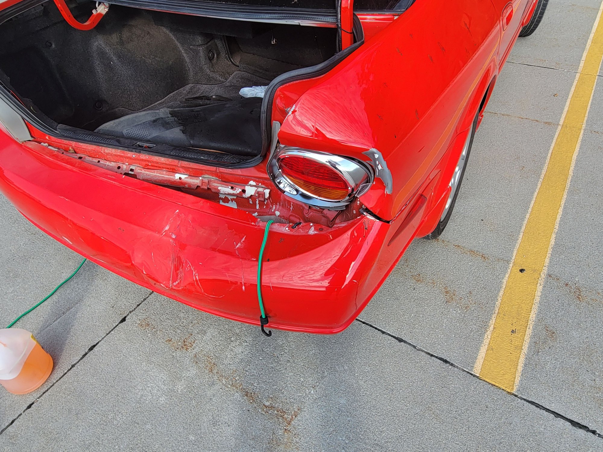

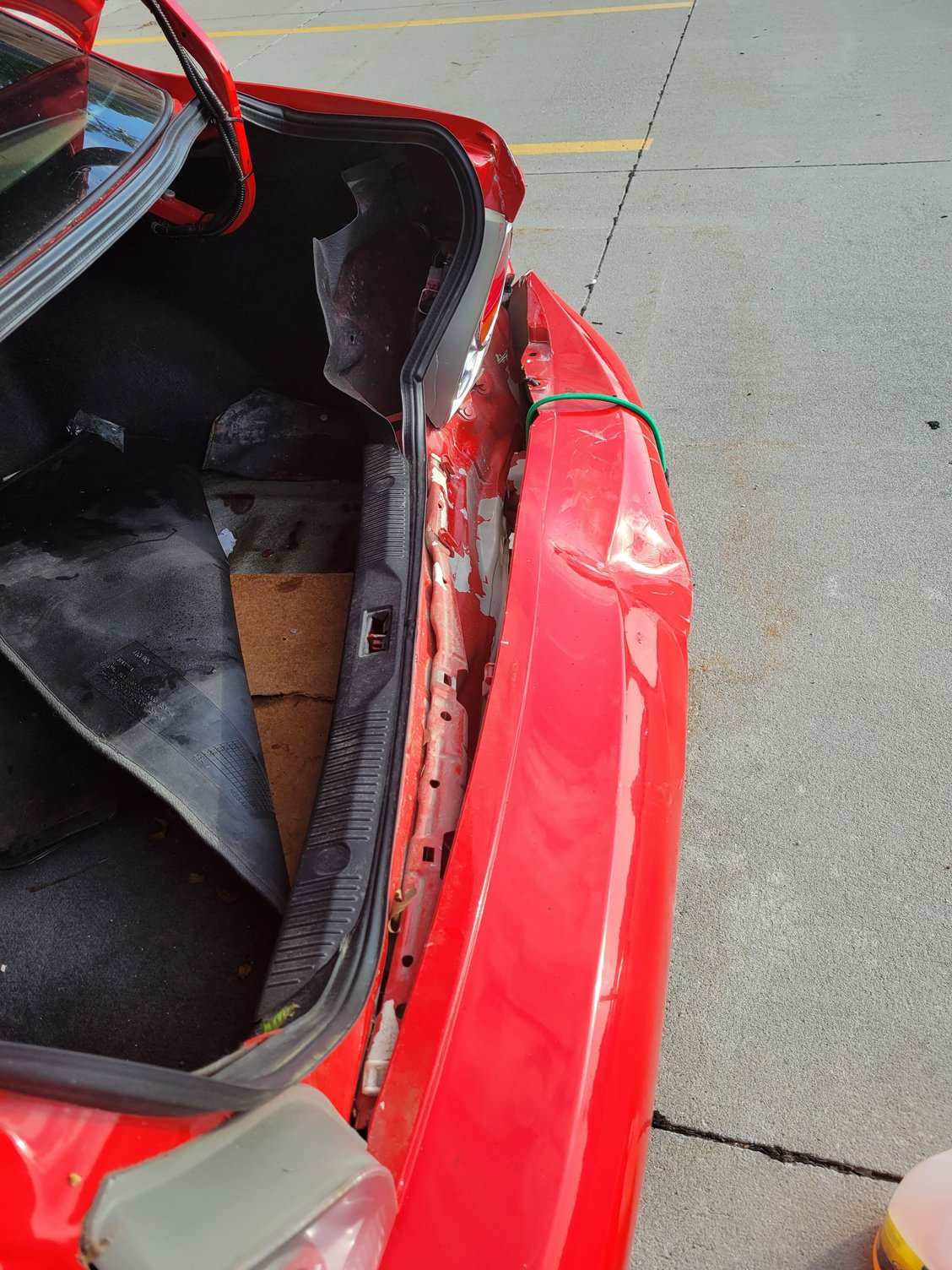

Repair or replace my 2002 Maxima?
I can get this fixed in Mexico for about $3K labor. Would it be better to get another Maxima and transfer the 2019 engine, rebuilt transmission, ECU and Android Auto system? Photos attached.
I can locate about FIFTY of these cars in salvage yards. What parts will I need to get at the salvage yard if I have the Mexican body shop fix it?

Get another chassis

I would definitely get another car. The lack of rear door gap is really the nail in the coffin. Yeah it can be fixed but will your rear window and door seal right, long term? Is your rear strut tower aligned perfectly? Will the rear beam line up correctly? A body shop isn't going to make sure you can get an alignment in-spec before they hand you the keys.

Well said, that's exactly what the body shop did with my 97 SE, held it for a month and just wanted to collect insurance payment. The rear beam was damaged and they refused to get it right. Had to source it and replace it myself.

What is the rear beam? If I have the Mexican body shop do it, I will have to supervise the repair, but it will likely cost in the $2K to $2.5K range.

solid rear axle beam, take a look under the car you cant miss it
