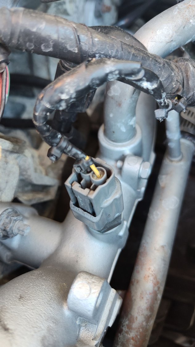

Ok here's what's going on I've replaced the O2 sensors now, to no avail, and I did replace the dampners and actually gained a cylinder #3 is firing now but #1 and #5 are not still, I replaced the coolant temp sensor today and nothing's changed either, reason for the temp sensor is it was throwing the code, I am going to try and upload my datalog please tell me if anything is irregular cause honestly I don't know what I am looking at . Thanks to all for the advice, ideas, and just plan responding id just say screw the car but I can't afford too. Reason I can get the parts is an awesome dad but I'm not liking spending his money for non of it to work.. anyways thanks again and tell me what you think of the datalog..

when you changed the plugs did you install a new intake gasket ?

First I want to thank everyone for all the help, cause I have officially given up but I have found a 4th Gen threw a friend it just has a bad transmission buta good engine only a 3.0l 😥 not the big girl 3.5l but I'm just gonna take the good with the bad and take my transmission from my gen 5 and transplant it into the gen 4, yes it is possible I just have to repin a couple plugs and couple more things which dont seem to hard, my only thing is I can't find a pinout of a finished swap, dont get me wrong I have both FSM's and I can figure it out myself I know i am capable of that but of anyone knows or could lead me to somewhere that does, that would be my last flavor on this issue... Anyways like I said thanks everyone on the advice believe me it's much appreciated 👍....
Oh I couldn't get the stupid datalog to upload I tried and tried to convert and compress it but the site only allows a tiny file so that's why it was never there..
