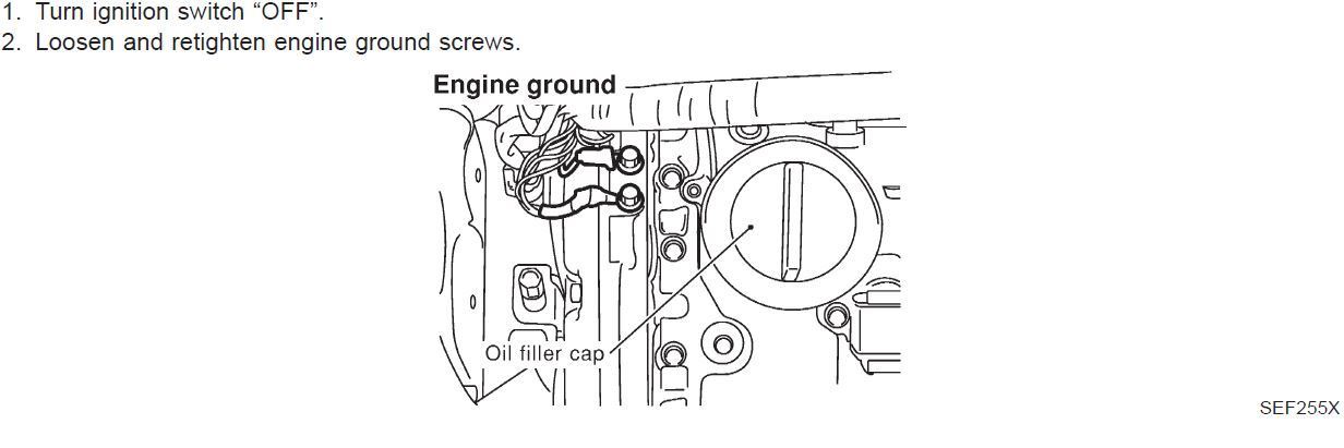

With the age of the car, I would start by cleaning up all engine grounds and battery terminals than make sure that the battery and the charging system works as it should. Once you confirm that the grounds are clean and the charging system works well, reset the ECU codes and see what come back up after driving the car for a while.
Don't throw parts at it yet, use the .org search feature to see how others have solved a similar issue.
Here's a link to download the Nissan Factory Service Manuals that have very detailed troubleshooting procedures for various trouble codes, 2000 Nissan Maxima Factory Service Manual (my4dsc.com)
