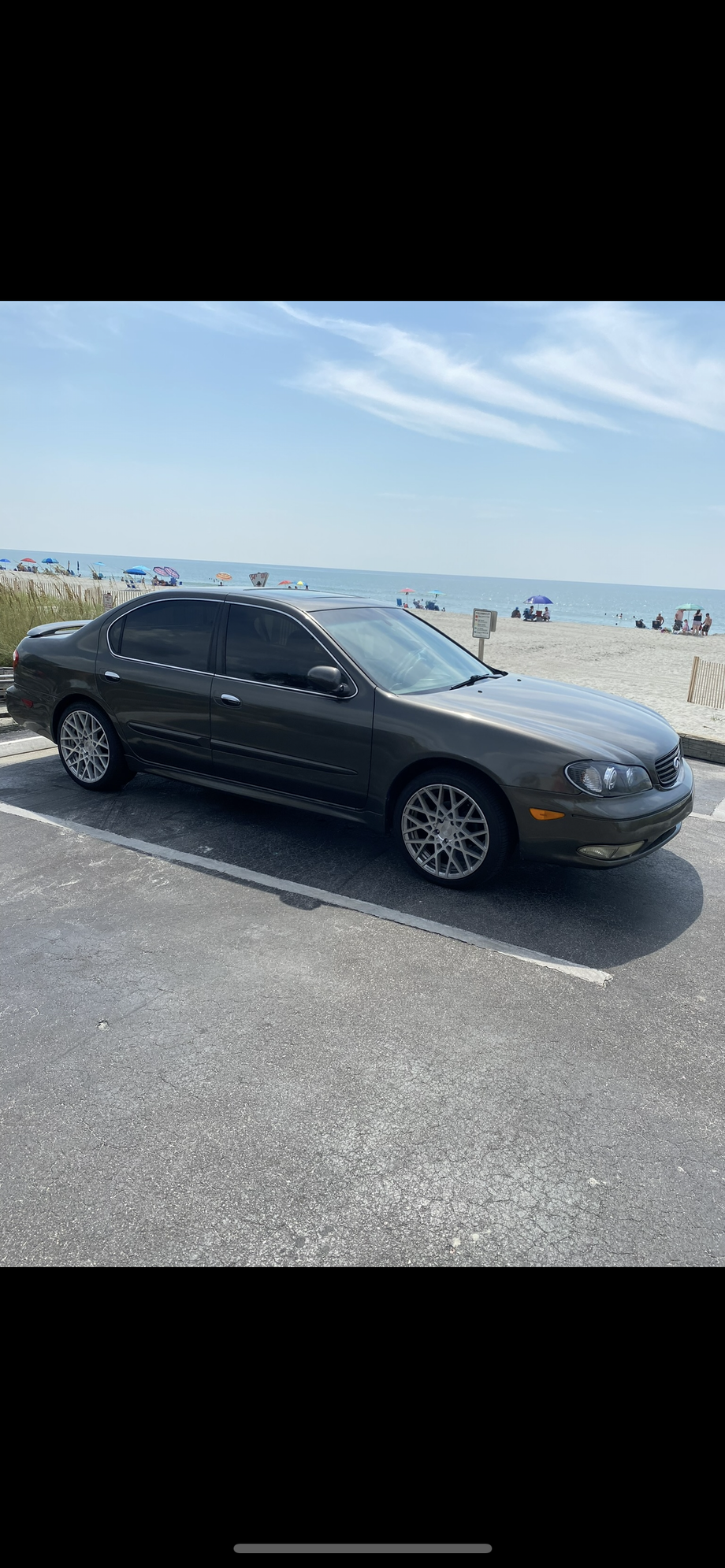

PLEASE HELP
I have 2001 Infiniti i30T for the last 8 years and 200k miles I have maintained this car …. Two months ago I was in a wreck front passenger side tearing my belts causing them to break SINCE PULLING THE FRAME AWAY AN REPLACING THE BELTS I NOTCIED A CHUNK OF MY ALTERNATOR WAS MISSING
i since replaced the alternator with 3 different alternator first 2 being autozone duralast and the next being Bosch NONE OF THE ALTERNATOR CHARGE THE BATTRTY when I hook up voltage meter the battery does not charge
Would anybody know what’s the deal I’m 3 alternators in
THE CAR IS CURRENTLY AT A SHOP THEY ARE REPLACING THE BOSCH WITH ANOTHER BOSCH THEY CHECKED MY PLUGS AN THE ALTERNATOR WITH A LITTLE TOOL THAT MADE NOISE WHEN INSERTED INTO THE CONNECTIONS
I ALSO REPLACED THE BATTERY ON THE SECOND ALTERNATOR
CAN SOMEBODY HELP ME PLEASE
