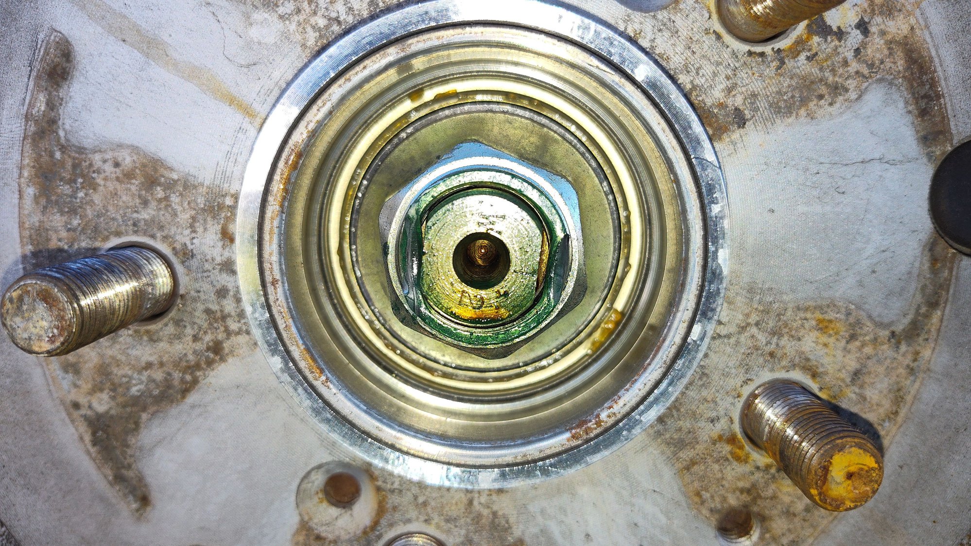

I ended up getting a new set of aftermarket wheels since the body shop that painted my car was taking way too long to paint my 350Z touring wheels and every other place I went to wanted way too much. only issue I'm having now is the center cap on the new wheels won't go on. the threads on the CV axle poke out a little too much and the same in the rear with the cap over the hub nut. has anyone else with aftermarket wheels had the same issue?
for the fronts I am thinking about cutting a few threads off the cv axle and for the rear i was thinking of either running with no hub nut cover or putting a mallet to it.

so on the rear I ended up removing the dust cap from the hub. the bearing appears to be sealed so it should be fine.
on the front I cut all the outer threads past the CV axle nut, the nut still comes off and goes back on fine.
