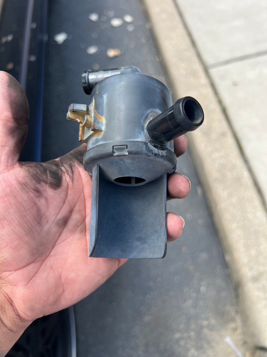

Evap issue P0455
Can anyone tell me what this is? Ive been getting a cel light and a p0455 code so I did a smoke test and this is where all the smoke was coming from, it was next to the charcoal canister, i did a google lens search but it was showing things that did not look the same, this is my first time messing with any evap issues

Looks like evap water separator. I suspect your evap control valve is bad. Right next to canister.
