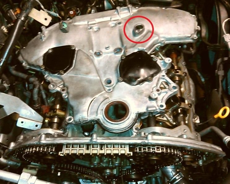

RA030726's Avatar
I'm nutty for Nissans
Posts: 9,311
It's in front of the engine mount. In this pic, right under "hole #3".
There are 2 crank sensors, one at the crank pulley and one where the engine meets the transmission.

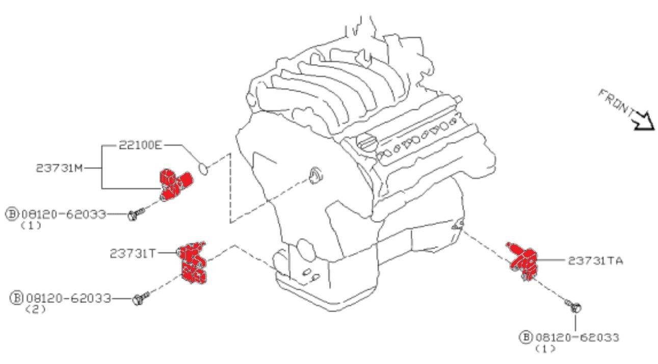

I guess the camshaft position sensor is like the throttle position sensor in that it can be messed up installing it.
I also guess my second picture in this thread is actually a crankshaft position sensor?
It is crazy the confusing misinformation that exists for 2000-2001 to 2002-2003 as far as these specific sensors go for these cars.
there is nothing confusing. that last pic is directly out of the parts catalog for a 00/01 car. 02/03 is a different engine and as such should not be used as a reference for 00/01
