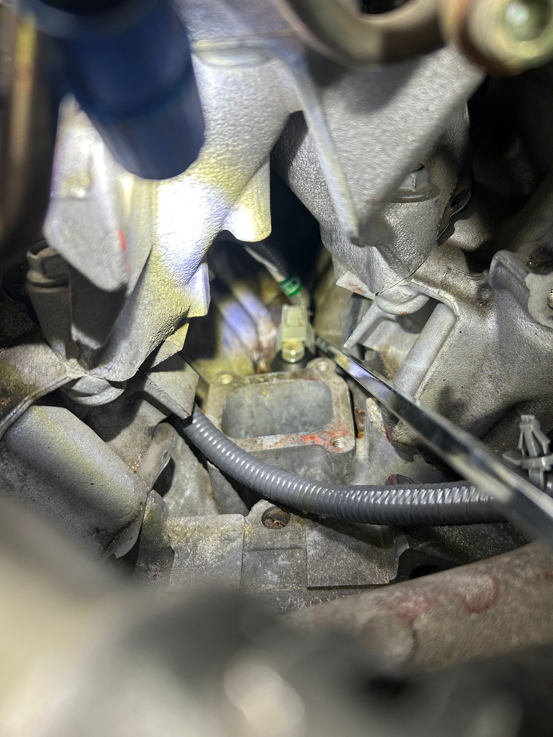

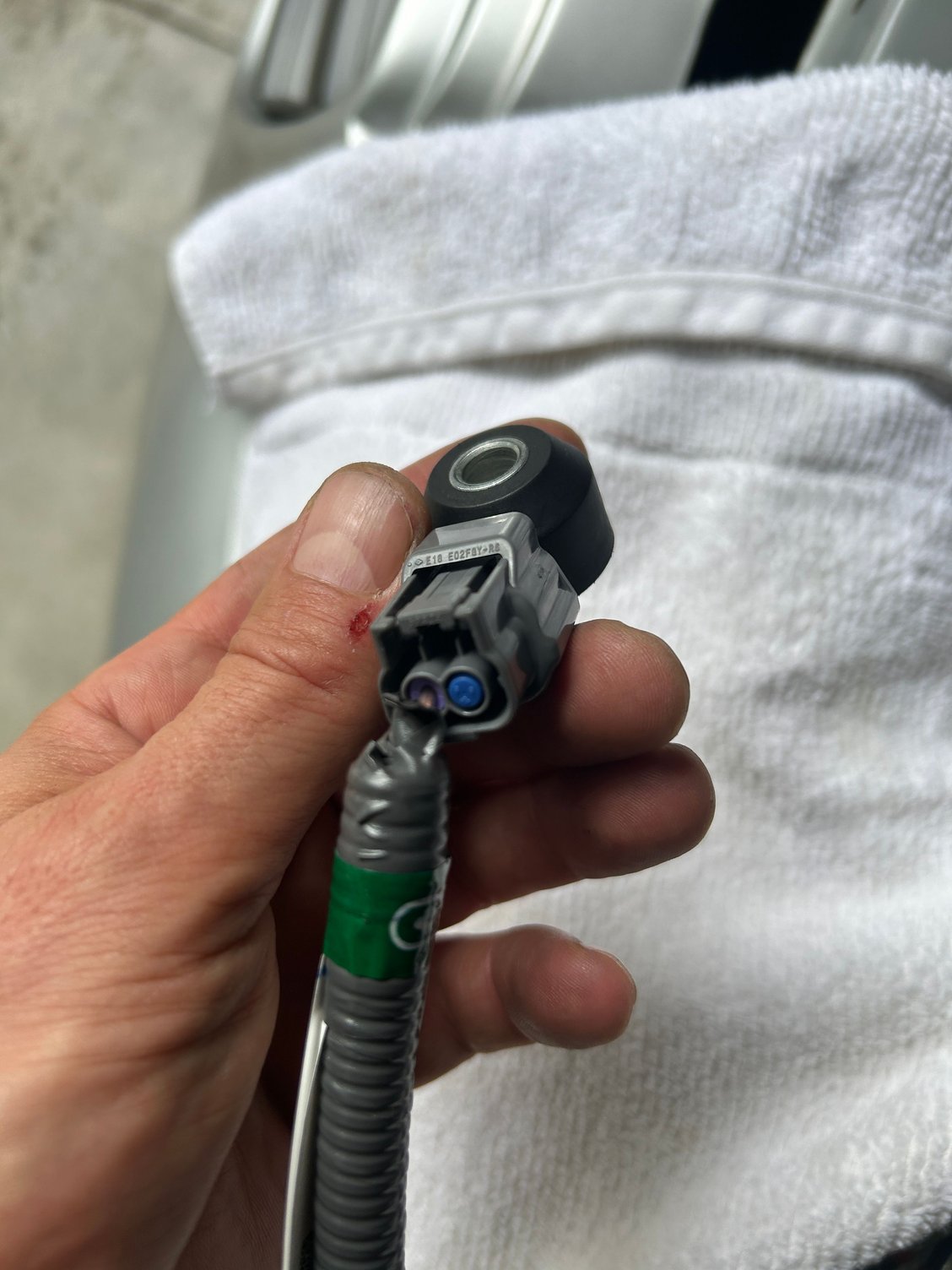

New knock sensor harness arrived today, threw it in right away along with a new KS.
I can confirm that the harness only has one wire lead going into the KS connector.
No more KS code and the 03 Max is pulling very hard now!
