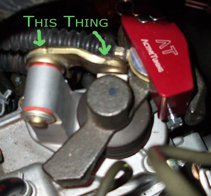

Okay, now what's going on? I installed the piece under the hood (which was a *****), then the piece on the shift ****, and the thing wouldn't move at all!! Under the hood, there is a piece attached to the transmission that doesn't appear on the installation diagrams. That piece rubs right up against the head of the transmission cable once it's moved with the STS. That means you can't shift at all. Here's a pic:
Is that thing on yours? Mine is a 2005 with the six speed.

Looked this morning when I got up, mine has that same gold looking piece, but my cable is nowhere near as close as yours.........just a question, where did you attach the cable to on the STS part?

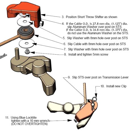

Here's the installation diagram. I think I installed it exactly this way. (Getting that tiny screw into the underside hole on the STS was a real effort!)

Yea, that bottom screw is a PAIN for sure. That sure is strange, I have the Nissan racing STS but it is exactly the same as the active tuning one.....................hmmmmm

I loosened that back screw and tried to move the STS piece around to get the cable head away from that gold piece, but to no avail. Anyway, I'm waiting for the guy at Active Tuning to respond to an email. If you have that extra part on your post, and it works, then I must have done something wrong.
