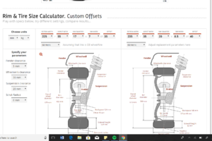

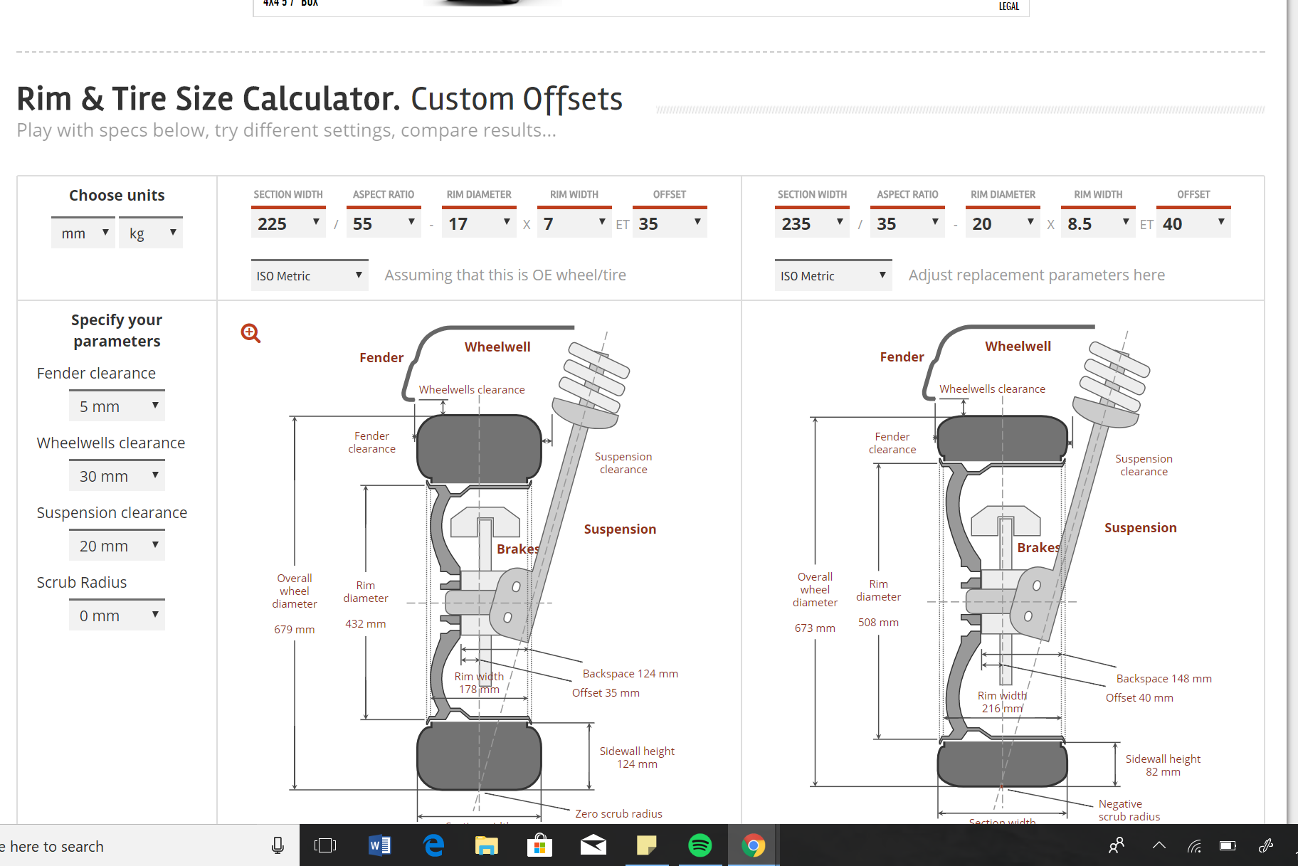

Hi, I am trying to put 20" rims on my07 maxima and I just have a few questions I'm hoping you might be able to help me out on. I am thinking about 225/35/20x8 I'm not sure about which offset to have I found a wheel calculator but I'm just not sure what the dimension of the wheel clearance is ? would you happen to know the measurements to the left side of the pic?
Attached Thumbnails Safe wheel offset for 07-08 Maxima SL-screenshot-30-.png
