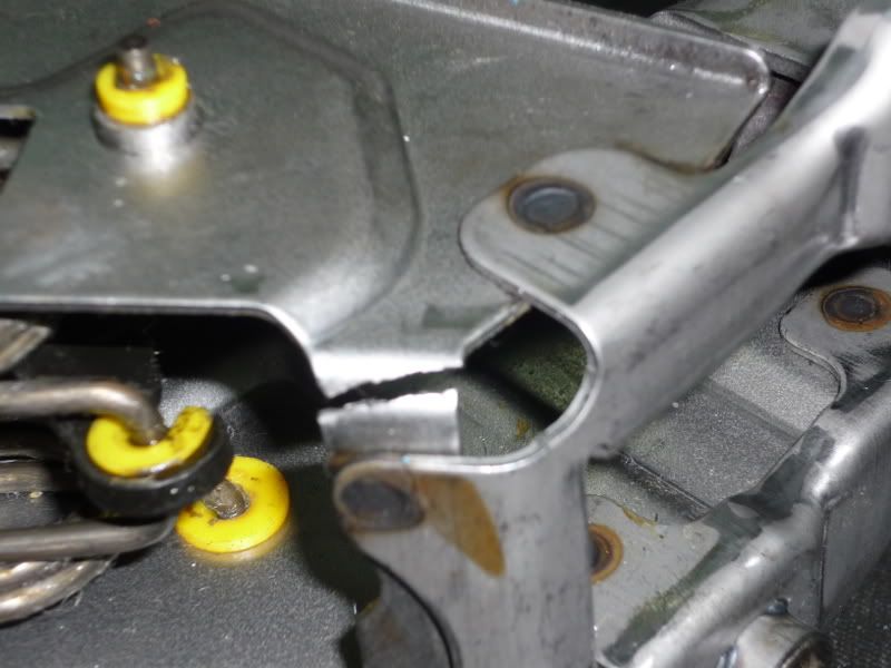

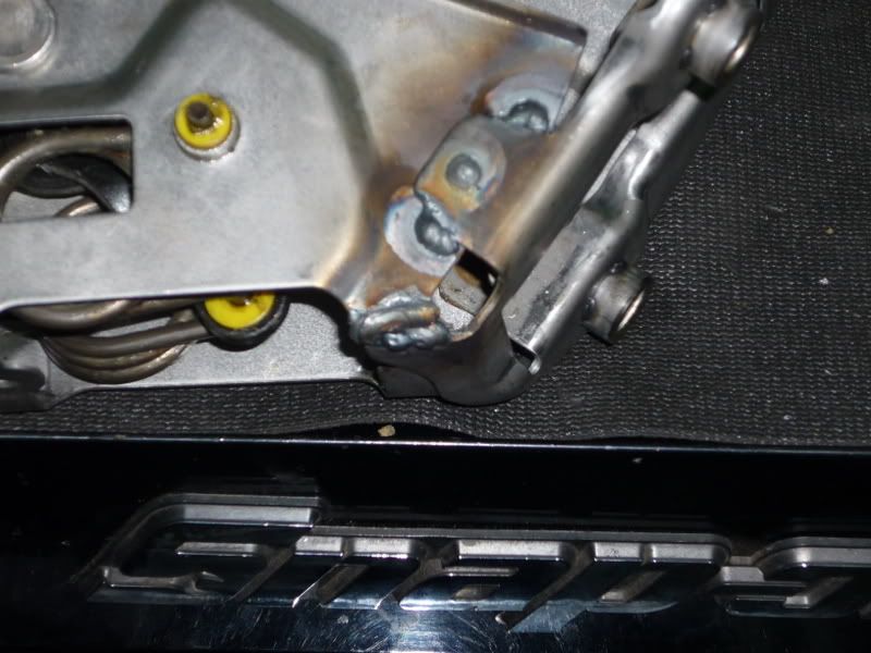

I finally got around to fixing this noisy thing..at first I thought it may just be a pushrod bushing or maybe the spring. I searched and didn't find anyone else with this problem, so I figured it would be minor. I put it off for a while until tonight I decided to tear into it and see what the problem was. Surprise surprise the dang bracket was snapped! The spot wield came apart, putting stress on the sides and eventually it snapped it. No worries though I managed to wield it with a bit more strength added to it, now my cruise control works and it shifts a whole lot better...obviously. Also I debadged my car a while back and never got to posting the pics.
Where it broke
Up close..
Fixed!
looking for something to cover/fill those divots (other than the nissan emblem) I saw a max with a sort of wing design before..but now I can't find it. Anyone know what im talking about and where to get one?
I probably should have asked this question a while ago..but have any other 6 speed owners encountered this issue? Or is this a user error thing? I know theres only a few out there..just a heads up for you guys.

Was ur clutch groaning when you would press it? Cuz mine makes noise when i press in the clutch

That's a great fix!
On a side note, you're probably in a small minority of 6th Gen owners who actually have the skill & resources to repair that issue.

Yep. thats how I would describe the noise before the fix..the whole bracket was misaligned causing the spring to rub up against the sides. It was a pretty easy fix compared to other stuff ive done, just 3 bolts that hold it on + the sensors and pushrod pin to remove, them bam its out. It took me under an hour R&R. Now that its fixed there is no noise whatsoever, and all the 'mushiness' is gone. although my pushrod bushing is cracked..ordering it from the dealership tomorrow. If you're looking dead on at the bracket, the top left corner was where mine broke. Maybe that spotwield is weak in design?

Thanks! Yeah, working at a shop with a mig wielder has its advantages lol.

Hey guys,
Not sure if this is proper to do, but I had this exact same issue too on my 06 clutch pedal. I've no idea how long it's been broken (bought it used), but I'm sure it's been since I bought it.
Anyway, had a buddy weld it up for me, and it's running much better now. I wonder how common this issue is though. Pictures below..

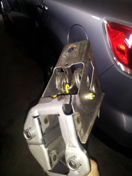

Clutch Bracket Snapped
OK, Sorry it took so long to reply here, the dealer had to order an EGR Valve and that delayed the repairs. As a side note, shouldn't a dealer have EGR valves in stock? They seem like a common thing to replace.
Anyway, the clutch bracket was broke on the corner, just like the other listed on this thread. The replacement has silenced the squeak. The new one only cost about $48. I'll get the old one welded up so I have a replacement in case it happens again.
In the picture you are looking at the back of the unit and the bolt holes that go into the firewall mounting for the bracket.

I was quoted at $287 parts and labor for this at a stealership. Guess I'm gonna figure it out and tackle it myself...

I don't really think it is that hard, you just have to be able to contort a little in order to reach the bolts.

I copied this from a previous poster who did it himself, "just 3 bolts that hold it on + the sensors and pushrod pin to remove, them bam its out"....I think there are 2 bolts into the firewall & 1 at the top of the clutch unit.
In the picture from my post on 12/03 you are looking at the back of the unit and those 2 bolt holes goto the firewall, the hole on top would be under the dash somewhere. You'll be on your back with a flashlight finding these things. Good luck & it is no bother to answer you.
